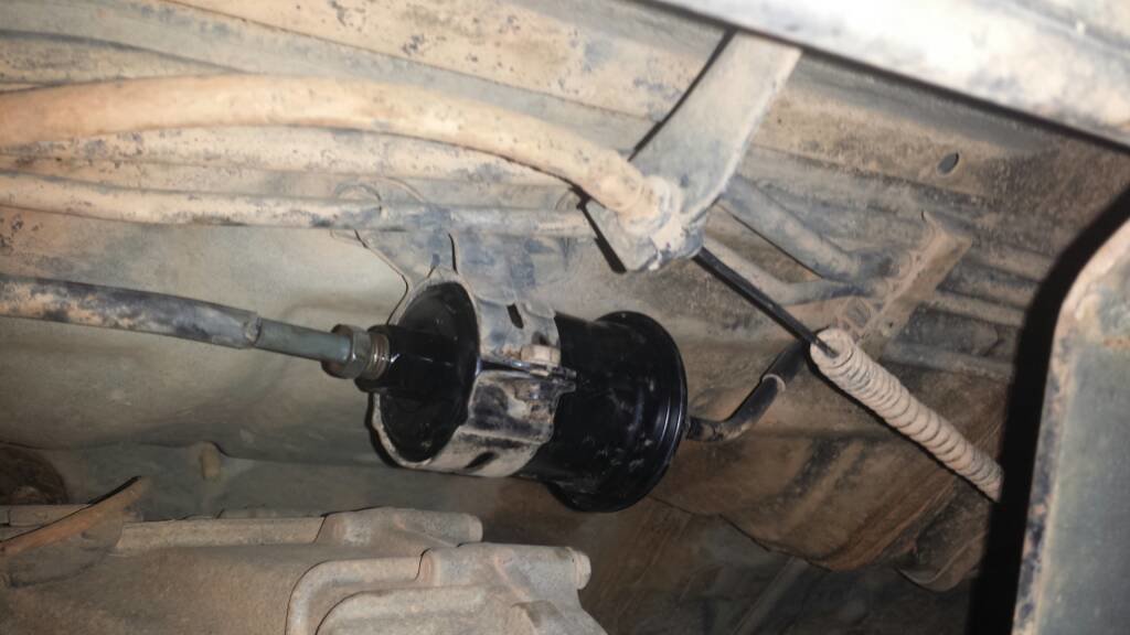

  12. Feb 15, 2016 at 6:40 PM

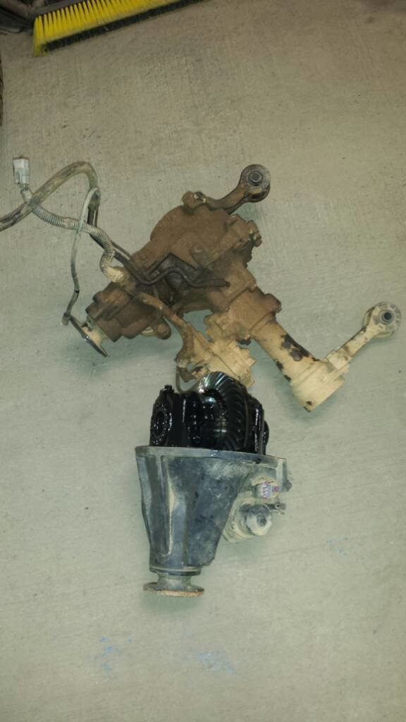

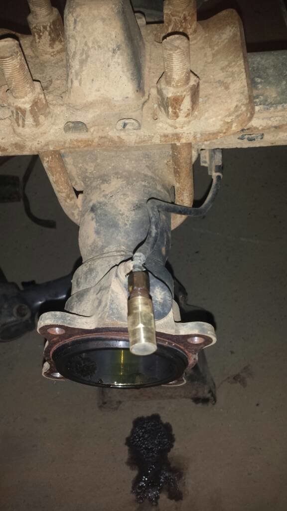

    Spent half my day yesterday cleaning the shop and pulling the diffs out of the truck. The front was the definition of pain in the ass. Ended up pulling the pinion flange to get it past the bellhousing. Rear did was easy with the exception of the driver side brake line decided it wanted to twist with the fitting. Will more than likely replace that section.
    Can also see my "custom" brake line plugs. Should bake bleeding the brakes a lot easier rather than leaving it open all week.

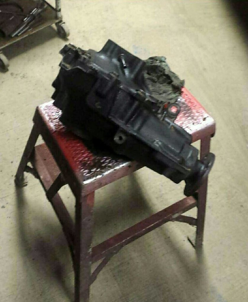

    Today was cleaning the front diff as I didn't get it may as clean as I thought at the car wash.
    Before:
    After:
    Along with that I changed the fuel filter, have had a new one for well over a year now. Was a bit over due considering all the crap that came out of it.

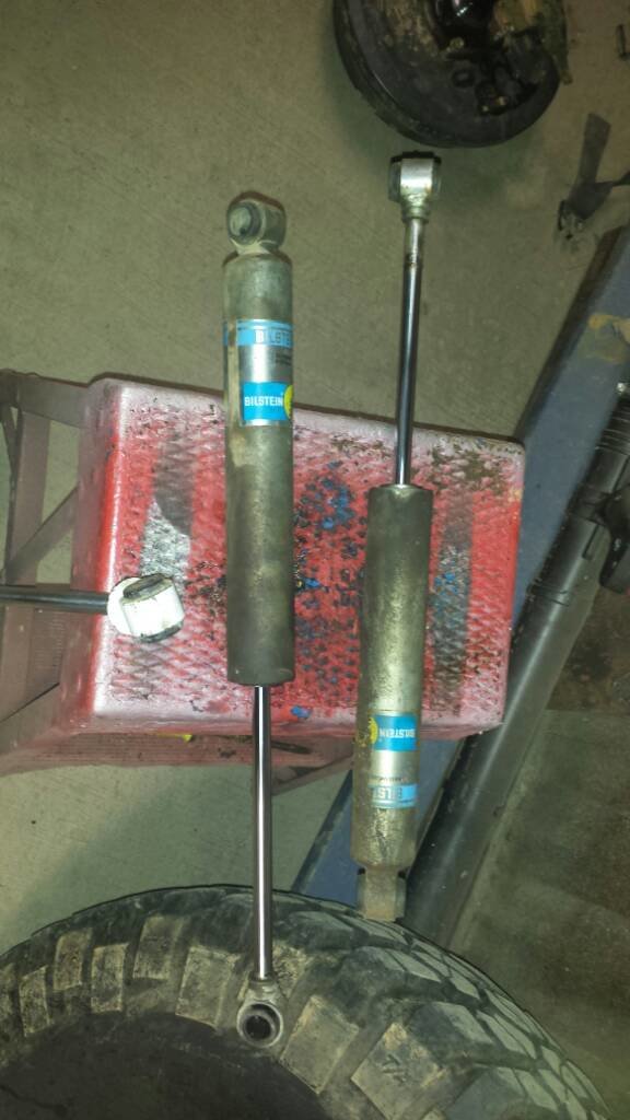

    Also went ahead and pulled the rear shocks, gotta love the leaky bilsteins. Will either go with the jk shocks I have or something else new.

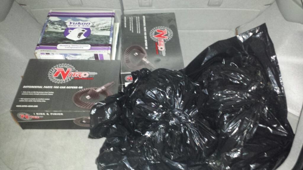

    Both diffs, gears, and install kits loaded in the dd for the week lol. Guess a prius is useful for somethings.

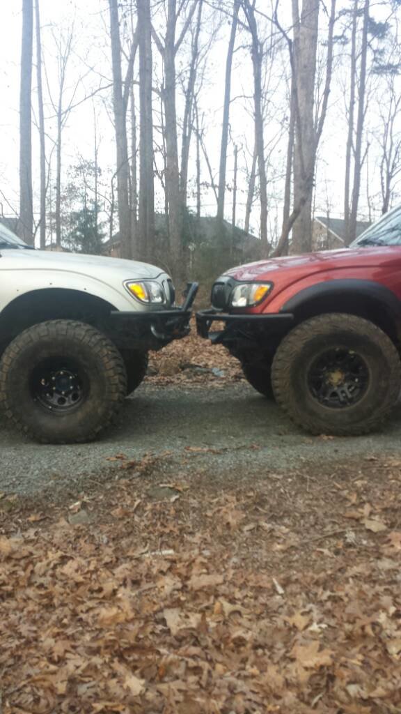

    Oh well I guess I never updated this after getting the diffs back in on Sunday. Went fairly smooth, had a couple buddy's come over and help. I remembered that Toyota put the fill plug in an awesome spot for the front diff, ended up using a couple feet of hose on the end of the bottle to fill it. Got the LROR elocker skid on as well. Also put some OME 882 coils and struts on and keep my top plate spacer. Hindsight I really didn't need the top plate spacer but oh well truck sits about level now. Here's nose to nose with Dylan's on Eibachs and Bilstien's.
    Rides a bit nicer, got the truck aligned on Tuesday and it really didn't need to be touched much. Not really much adjustment with this much lift. So far I'm happy with the gears, hell of an improvement daily driving.
