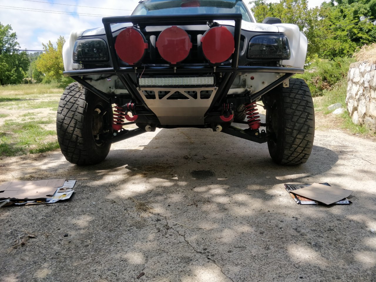

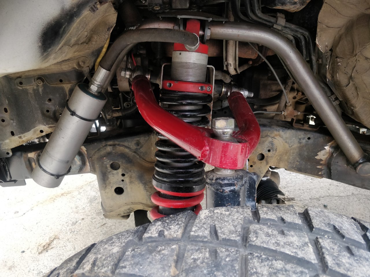

    So I pulled out quite a bit of preload, control arms seem at a happier angle. Now to realign and see how she feels. The before doesn't show control arm angle but you can see the amount of preload it had

    Well I think I got the alignment dialed in. I added as much caster as could, took out as much camber as I could. And measuring the rear for toe is 72" exactly and the front measures 72 1/16" ish maybe a little more. The steering wheel doesn't return hard, but it does return which is didn't before and no more squealing of the tires when I turn. I'll just have to keep an eye on it and see what happens.
    Also to note, taking out the preload softened it just where I wanted it :thumbsup:

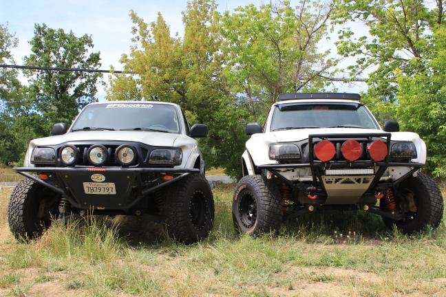

    What a nice pair of tacos, and of course with that full lock bro stance :rofl:
