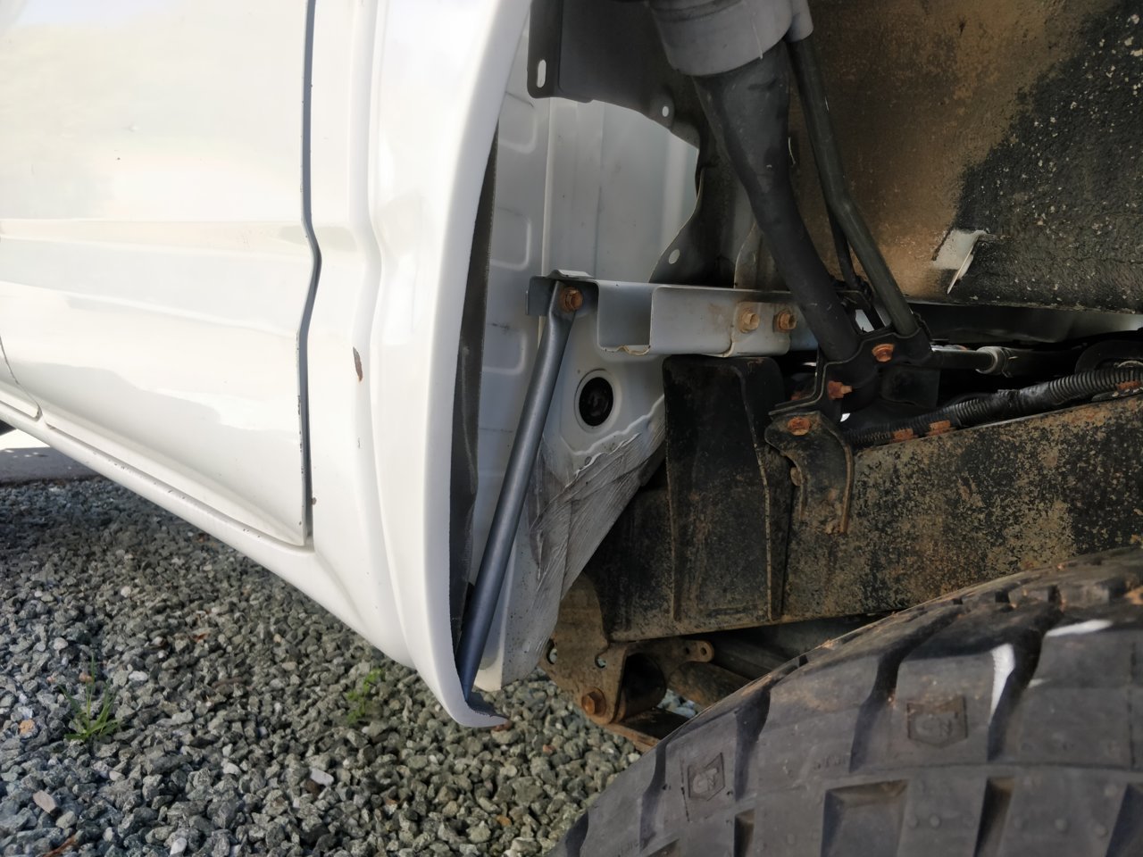

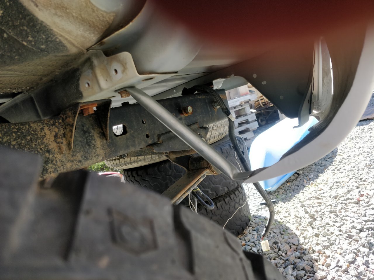

    Also finished up the bedside mounts, now just waiting on hardware to mount it to the glass.

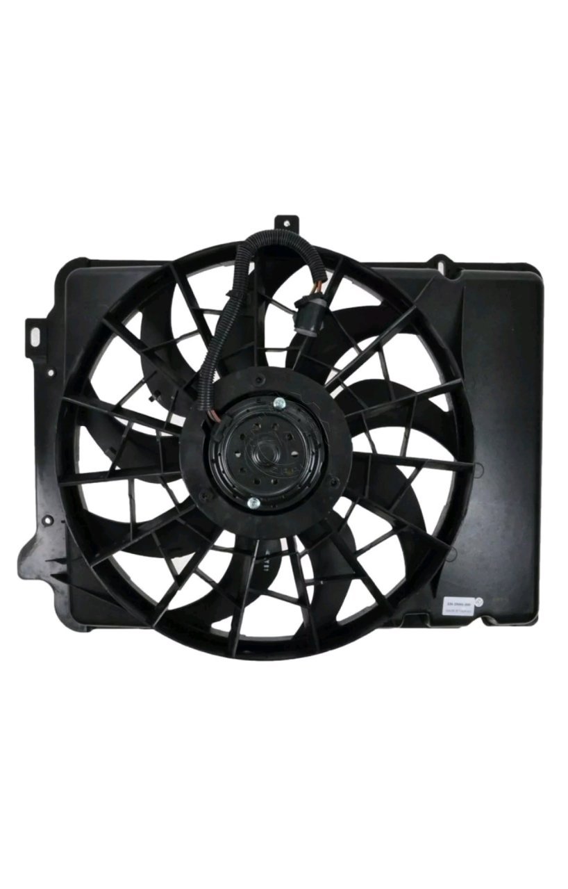

    Yeah I guess the wiring is a little difficult, but I'll figure it out and it'll be posted on here. I guess the low speed is has a lot of CFM, so I'm going to have two switches one for low speed and one for high. Not going to do any fancy temperature switches, just fully manual.

    Yeah I'll be using a 30-40 amp relay for low and an 80 amp for the high. As far as having it run for a little while, cooling it after shutdown isn't really going to do anything I don't believe. Unless you're drag racing it and need it to cool down quickly.

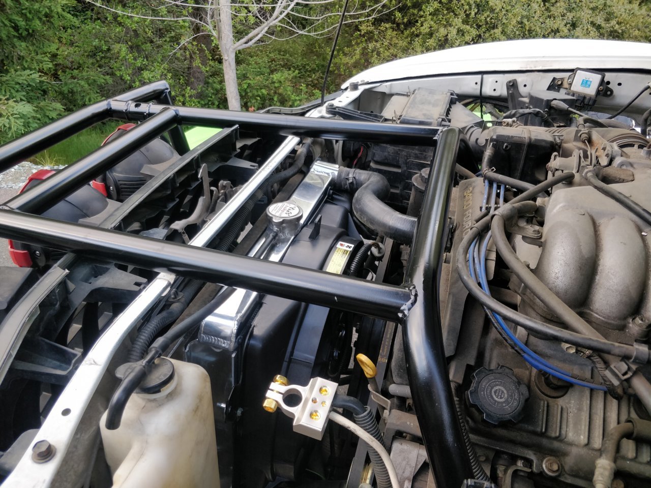

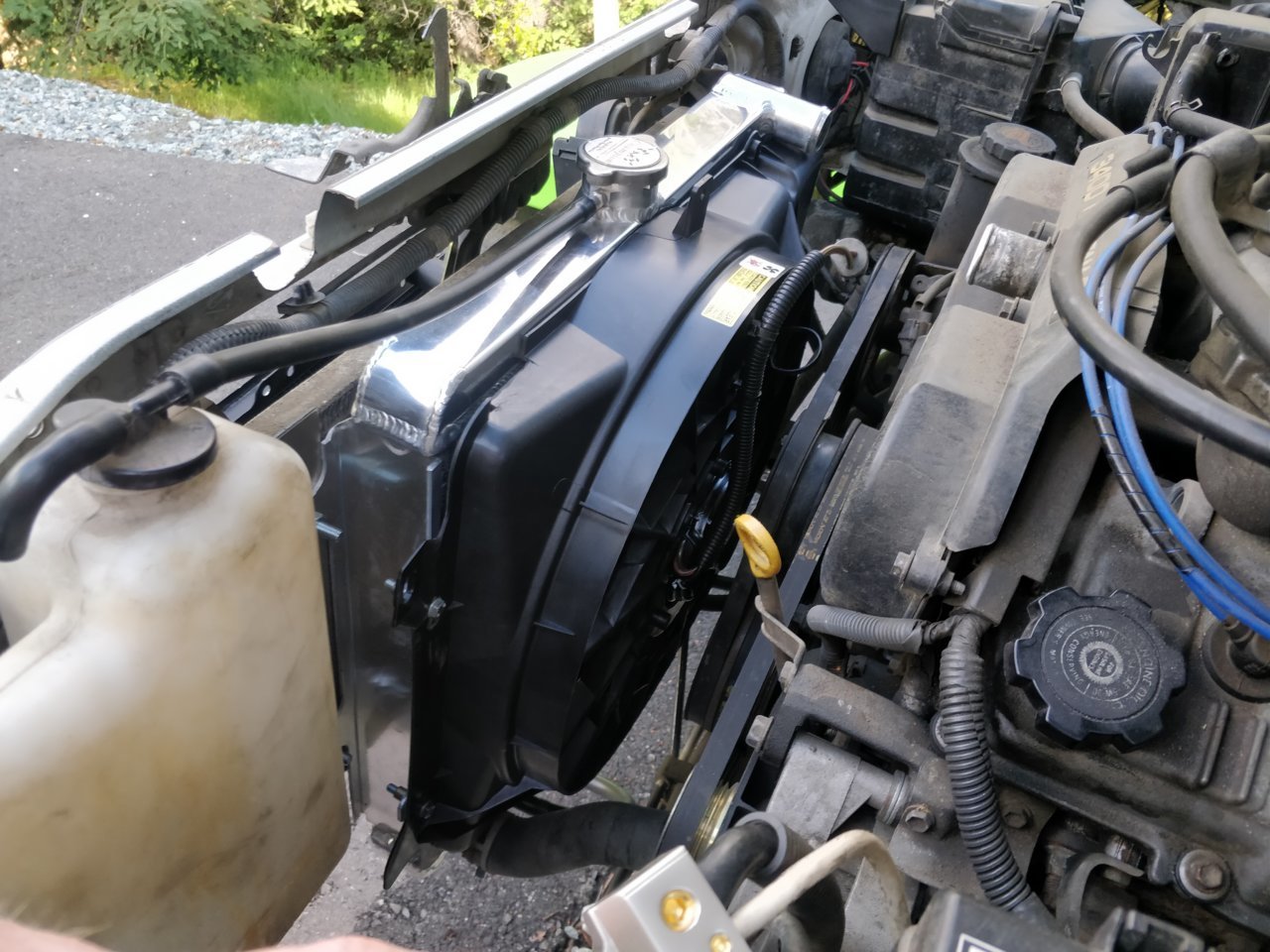

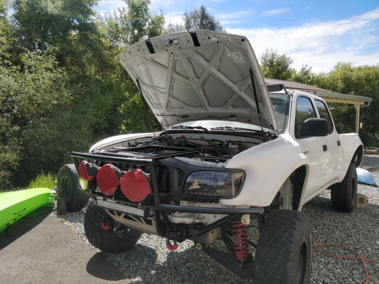

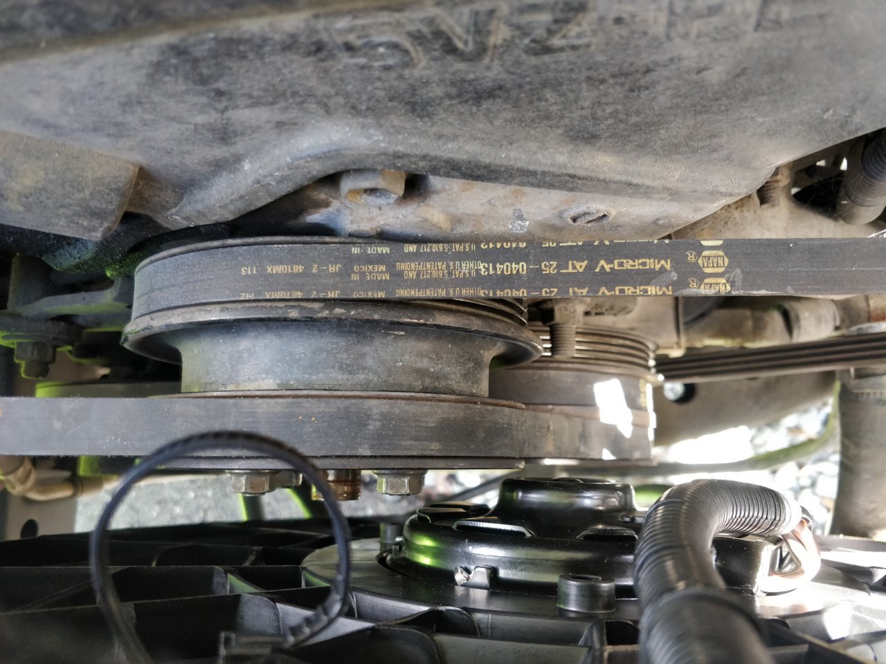

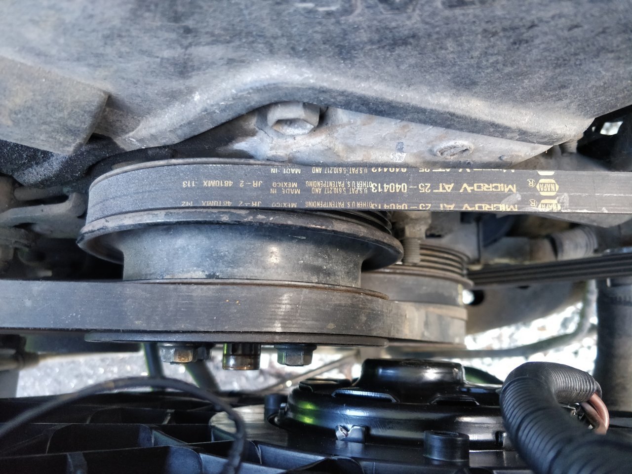

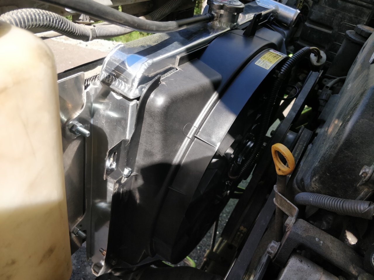

    Got the taurus fan partially installed.
    Working with some pretty tight clearances though. I'll have to see how it looks when the engine revs up. If it is a problem, I can move the radiator to the back sides of the mounts and that'll give me another 1/8" or so. Or maybe it'll do a little self clearancing :notsure::rofl::rofl:

    Same setup I’m running. Made my own fan shroud and moved the motor to a side so that it cleared.

    Right on, mine had zero clearance the other way so I went with this way

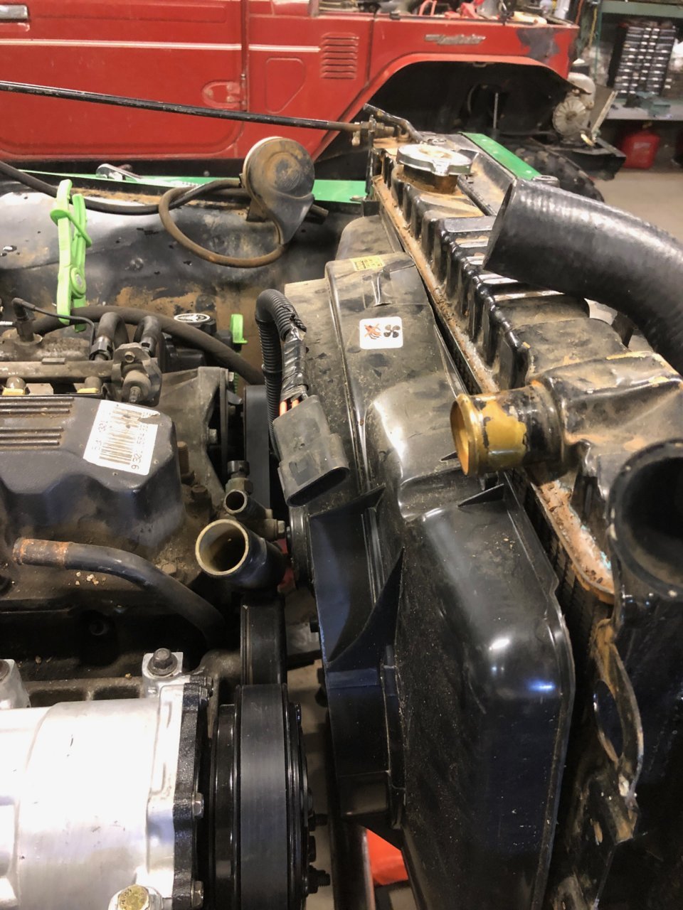

    Here’s mine. :anonymous:

    I’m going to drop the tranny a little so that should help clear a little more.

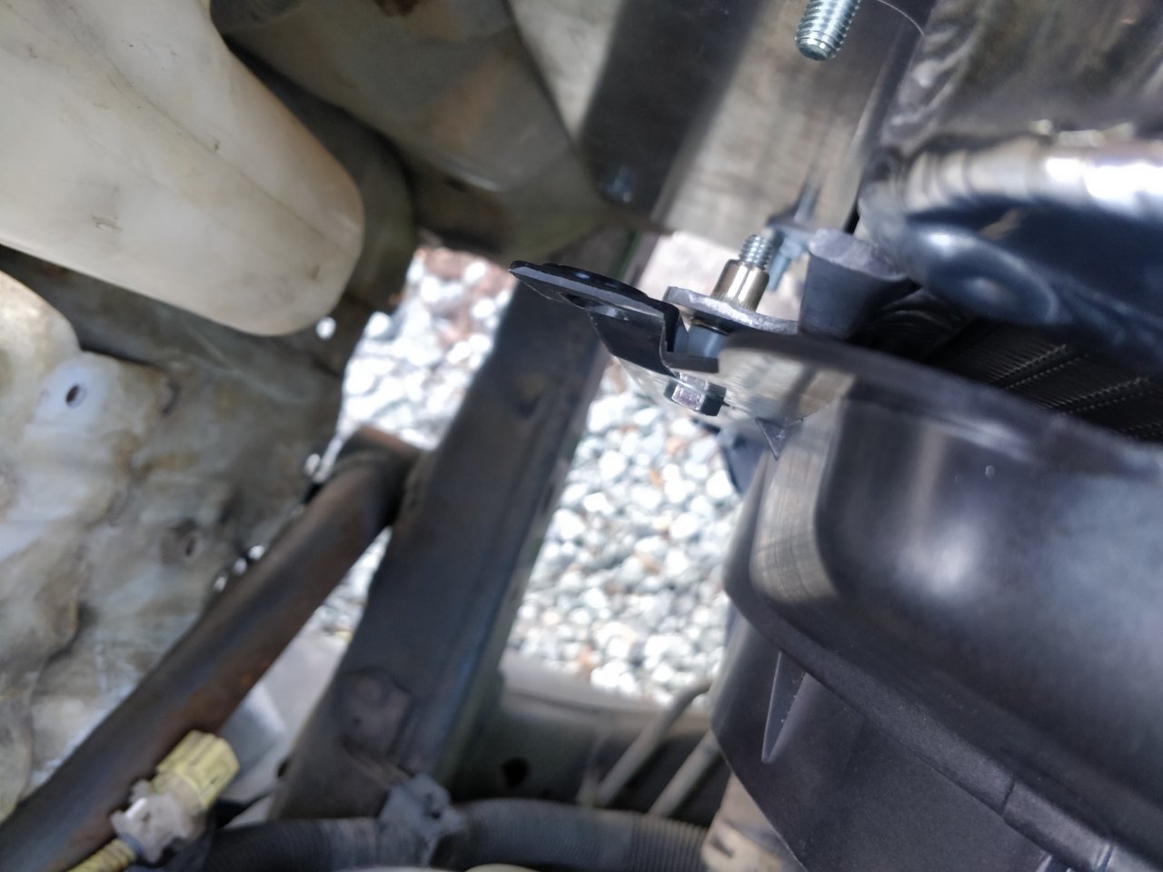

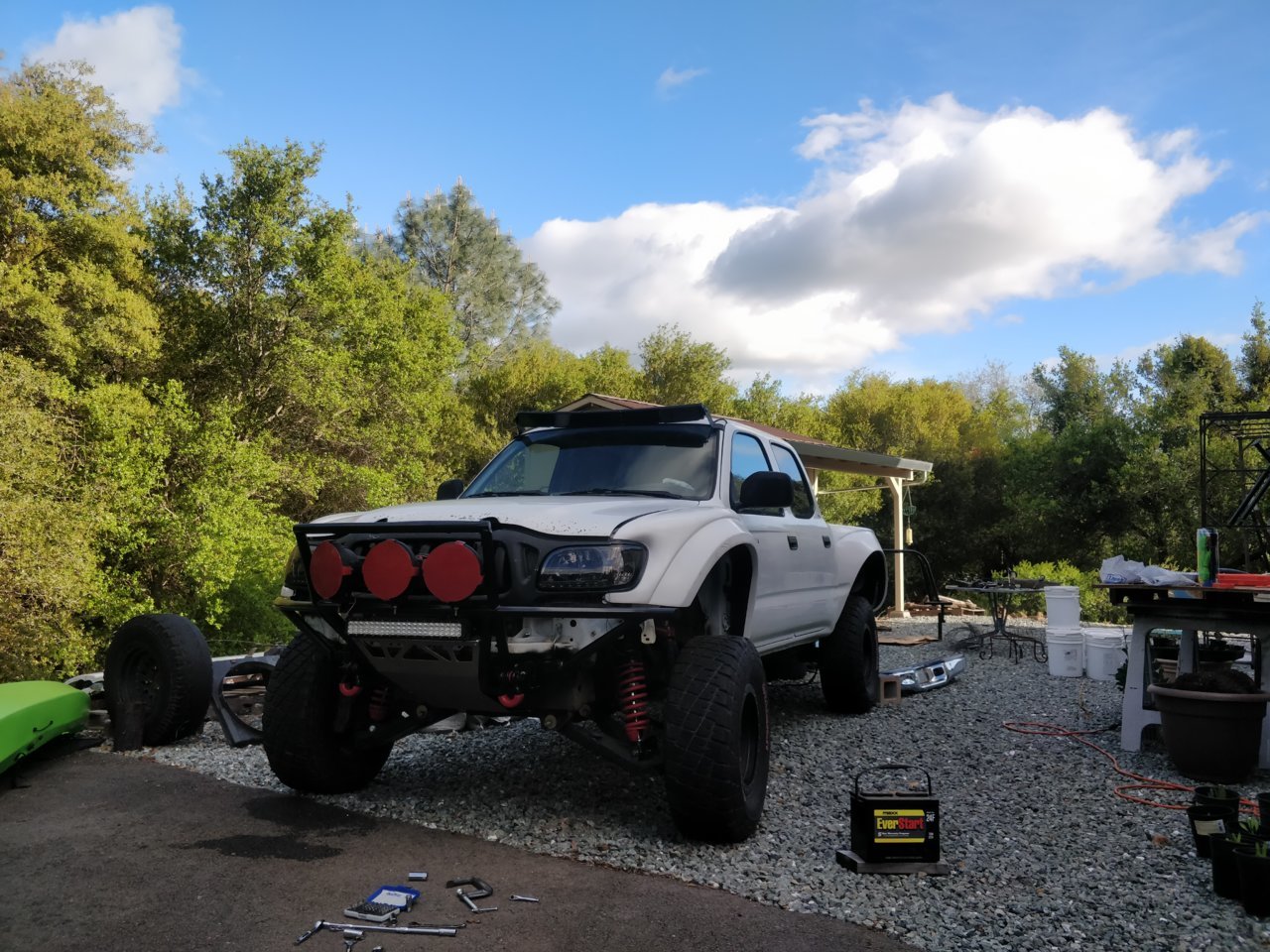

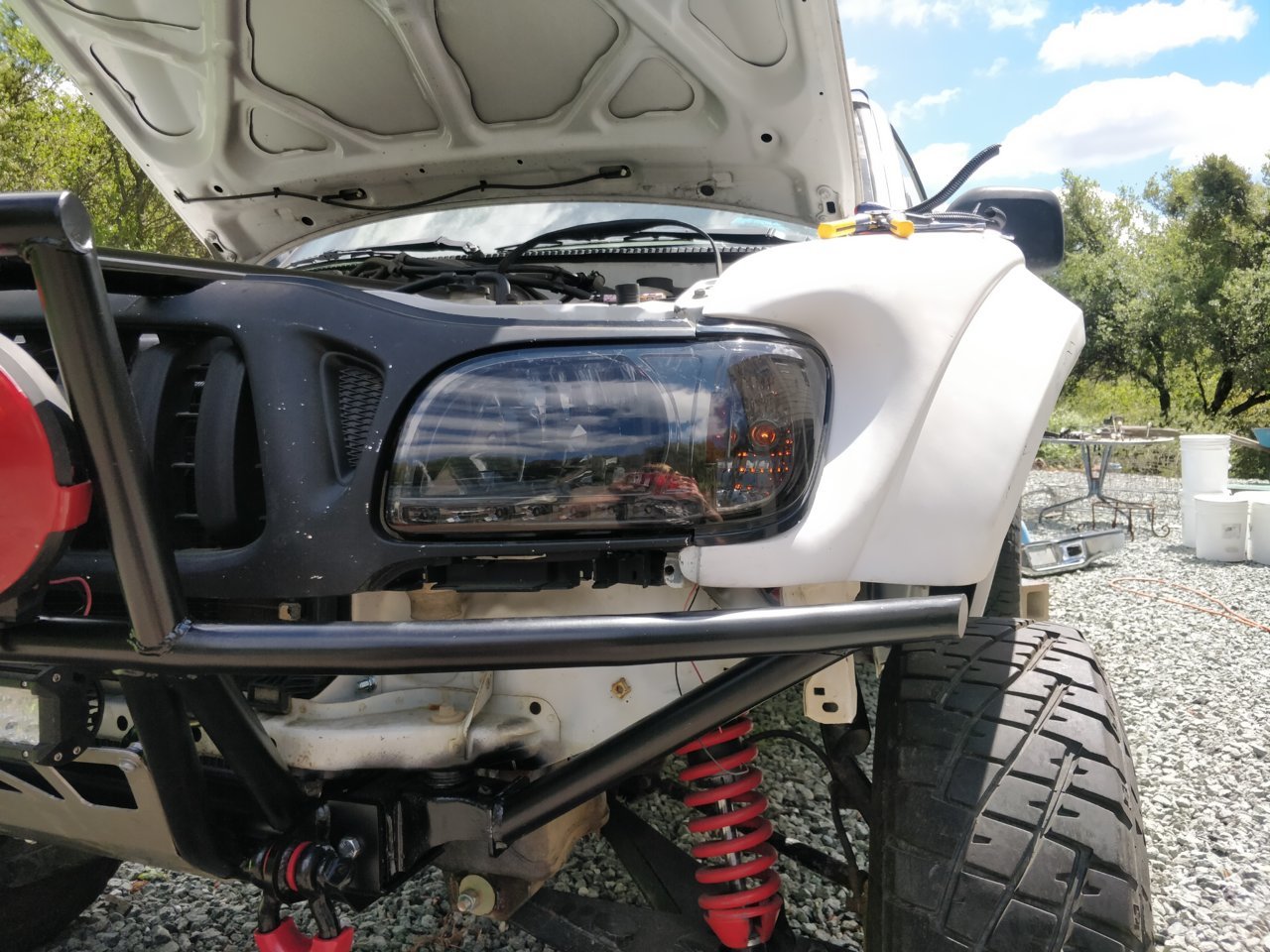

    Got it fully mounted, lookin beefy.
    Also gained some clearance.
    And mounted up the front end, and oh mah lawwd does it look good

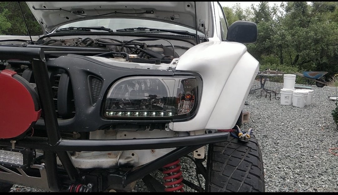

    Decided to add the led strip to the blinker/running light setup.
