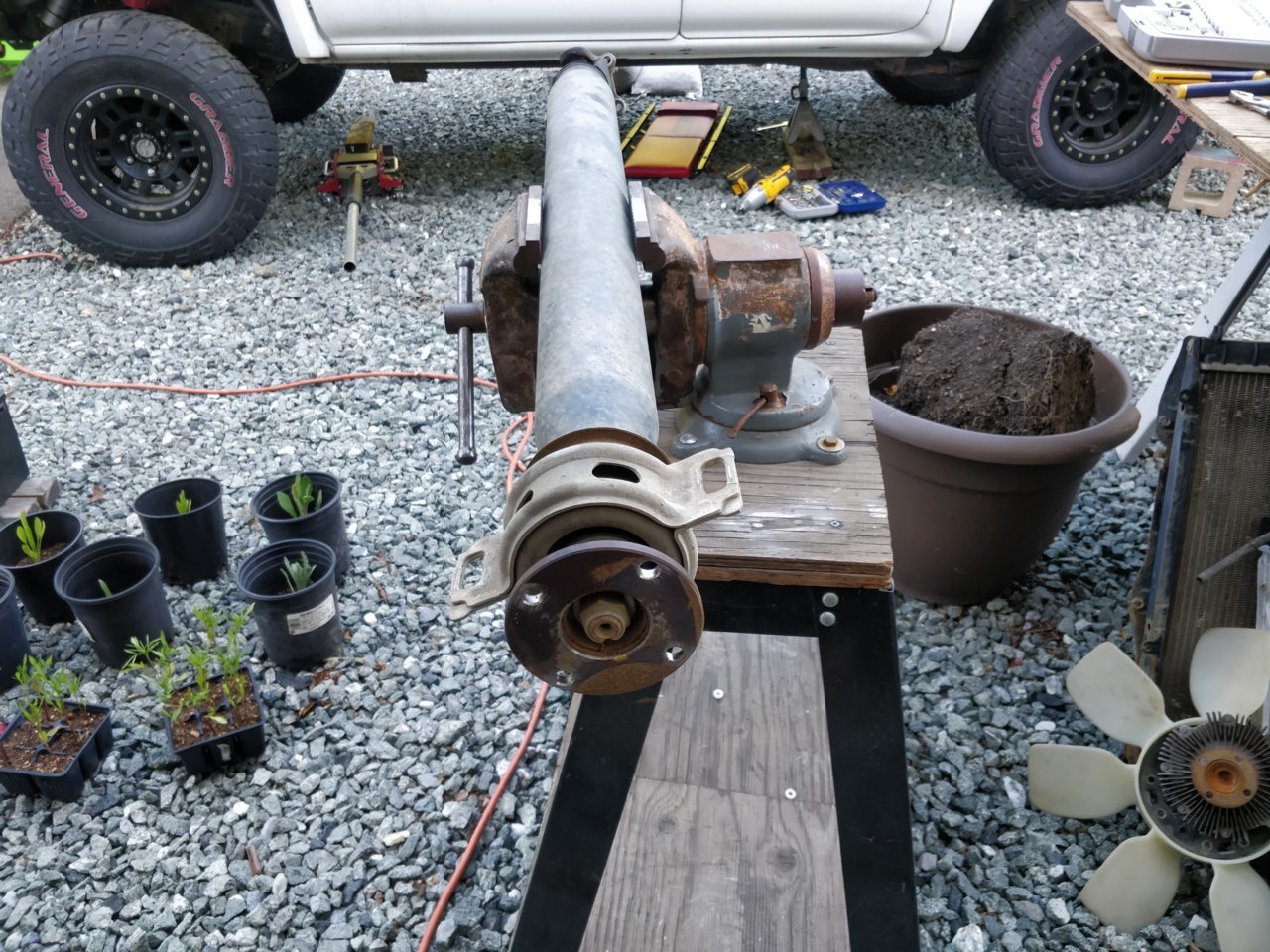

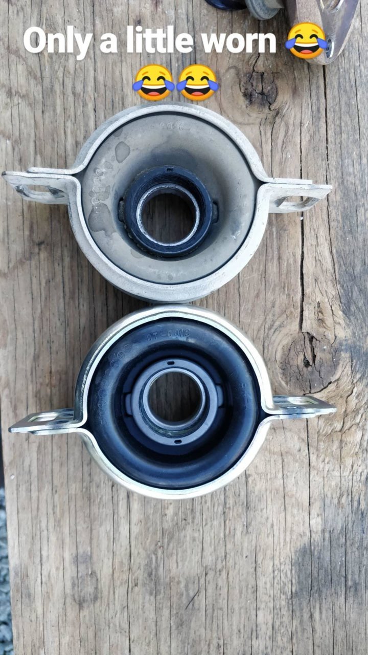

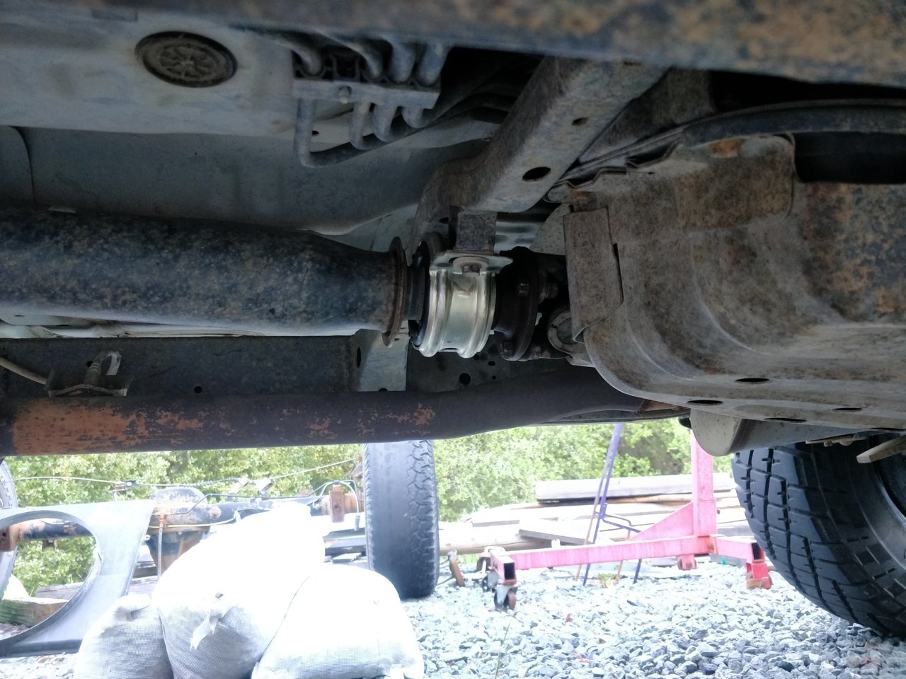

    Replaced the carrier bearing and trans mount, carrier was only a little worn :rofl::rofl:

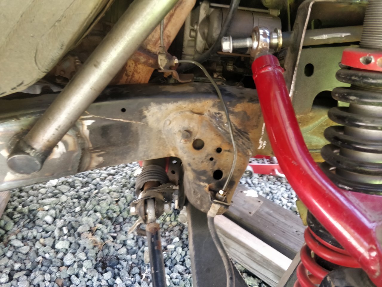

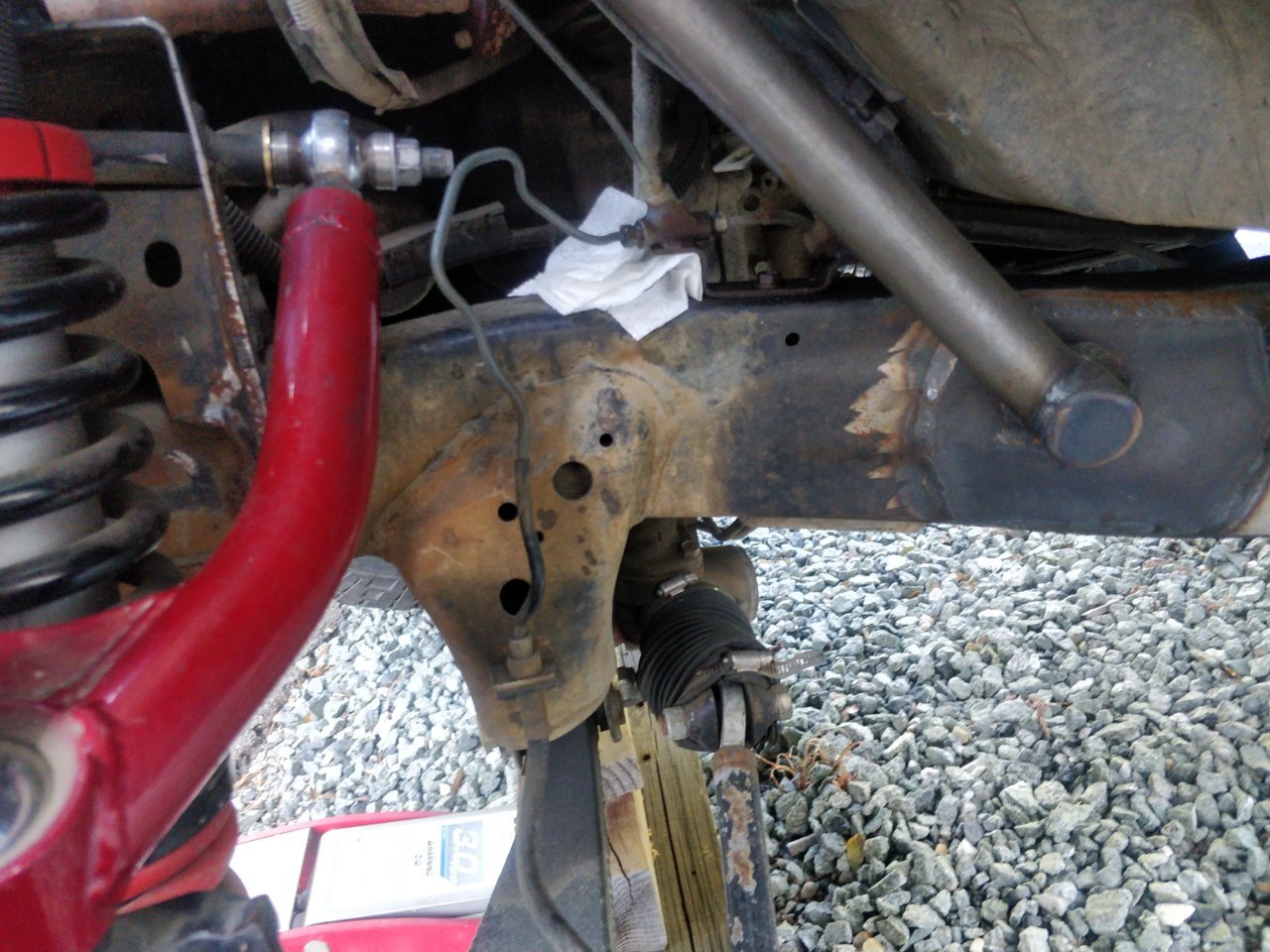

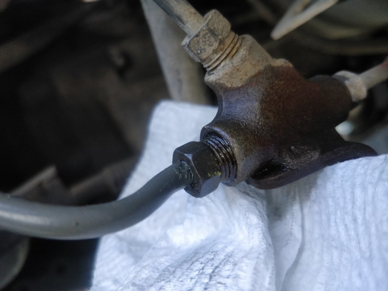

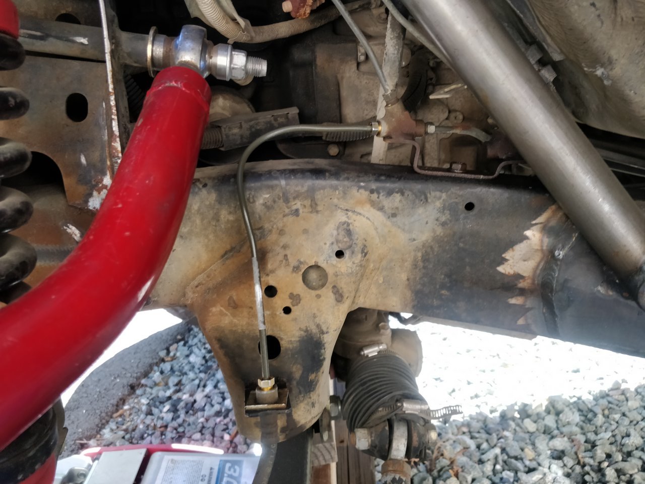

    Was putting washers in between the upper control arm bolt and this happened :censored:
    Not that bad though they weren't looking so hot anyway because I bent the stock lines because I didn't want to buy extended lines :rofl:, got straight lines from O'Reilly's and I'll bend them tomorrow.

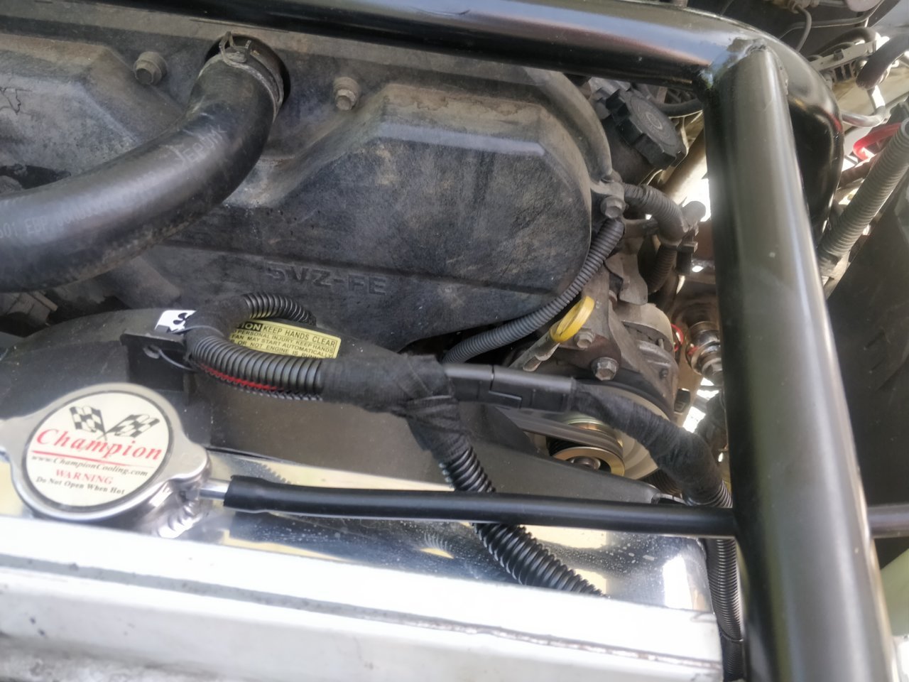

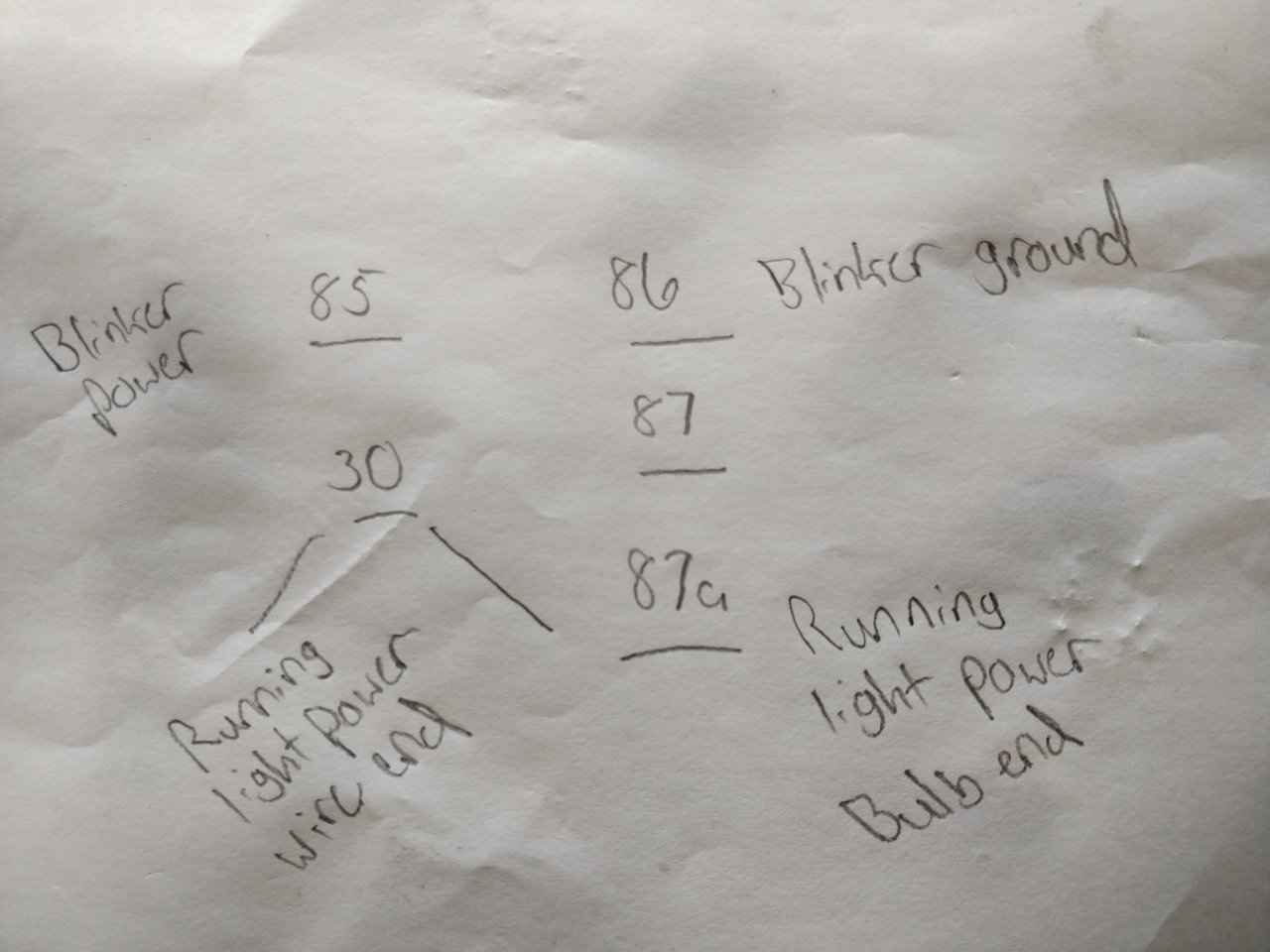

    Thanks man, they're eBay headlights, very popular around here, and I did it with a relay using the turn signal power and ground to trigger the relay

    So the lights under the headlight act as your turn signals now? Happen to have the ebay link or anything specific laying around? Also if you're interested some of us TWers are going to stoddard wells soonish if you're interested. Mentioned it on another thread

    Both the corner lights and strips under the lights work as all time running lights and blinker when the blinker is being used

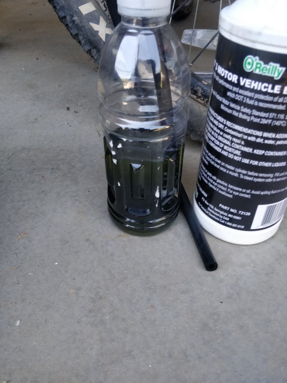

    Did the other side too and bled the brakes
    :puke:Gonna need a brake flush

    Here's this for you @Nicklovin
    Then just hook up the led strip ground and power to the running light power bulb end and the running light ground
    Nicklovin likes this.

    Thanks, screenshoted for future use.

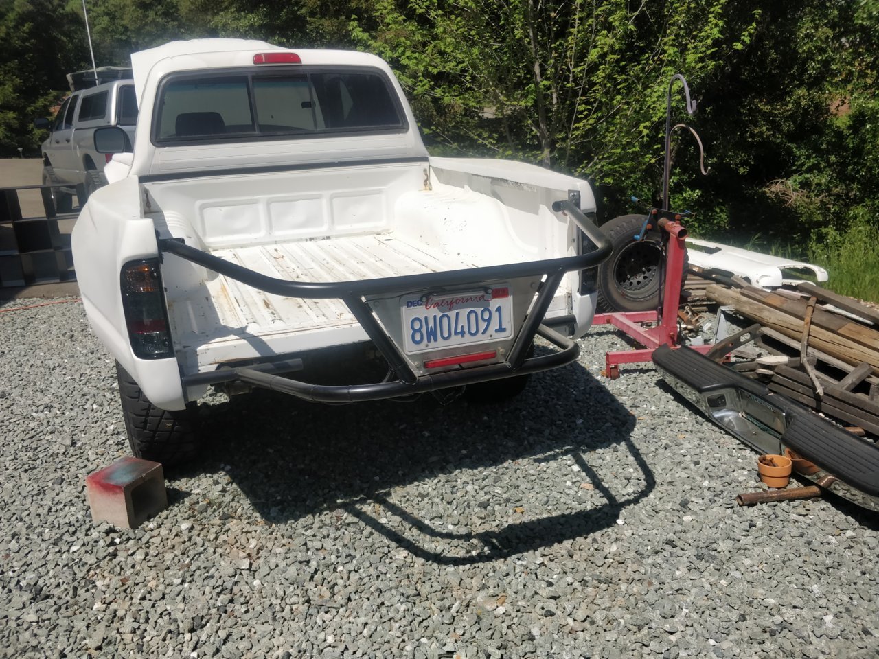

  13. Apr 26, 2019 at 3:03 PM
    #173
    RedManRocket
    RedManRocket [OP] Well-Known Member
    Mar 18, 2015
    #151238
    2,297
    Red
    Sonora, Central Cali
    2002 Double Cab LT
    Esb 5.5 with Kings Mcneil 6.5 fenders Other stuffs
    Wiring finished for the fan, wants to overheat, I'm guessing bubbles in the cooling system still
    Also finished up the license plate and lights

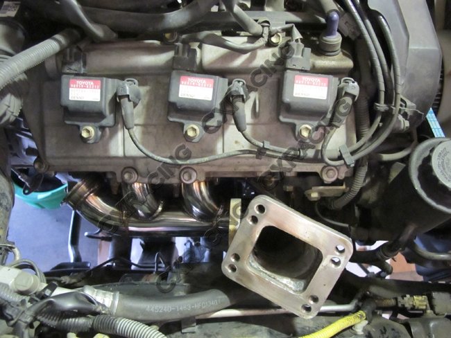

    Been looking at CXs turbo kit, man it's close, I think it'll fit. There's only one way to find out...
