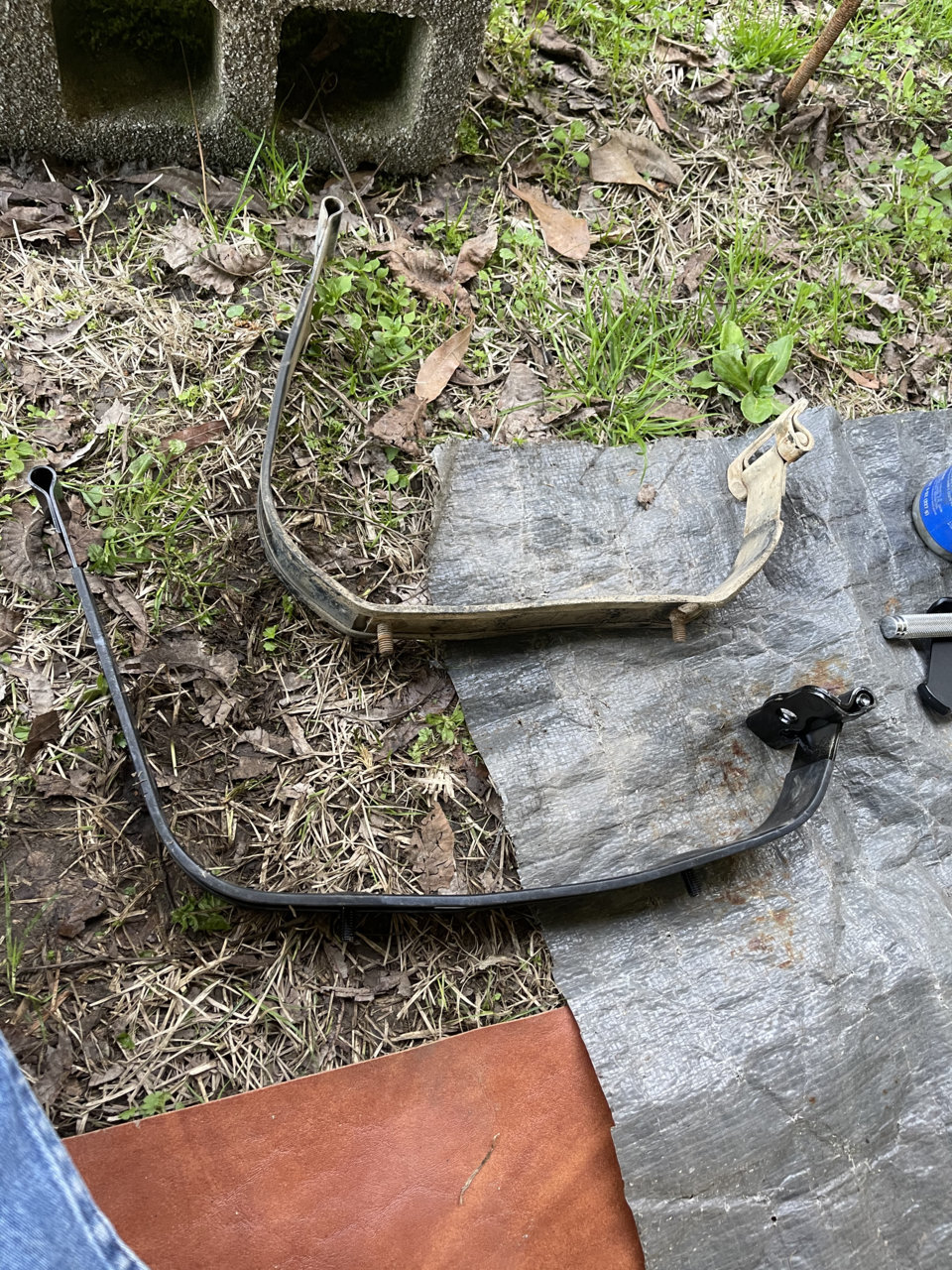

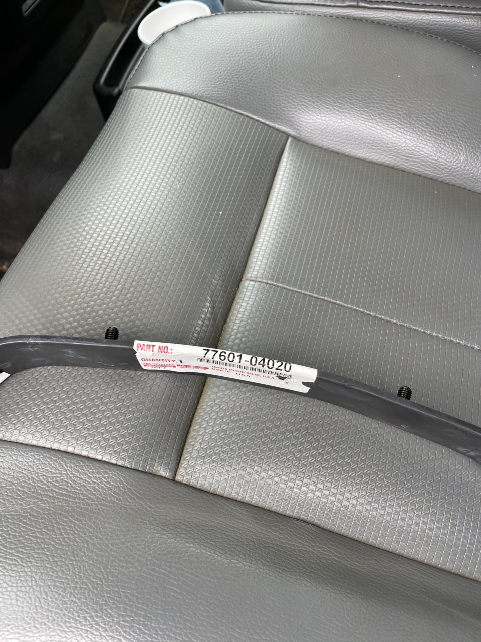

    That’s the front offroad gas tank strap with studs the rear is 77602-04020, the front on this truck is broken gonna try and get it swapped one evening.

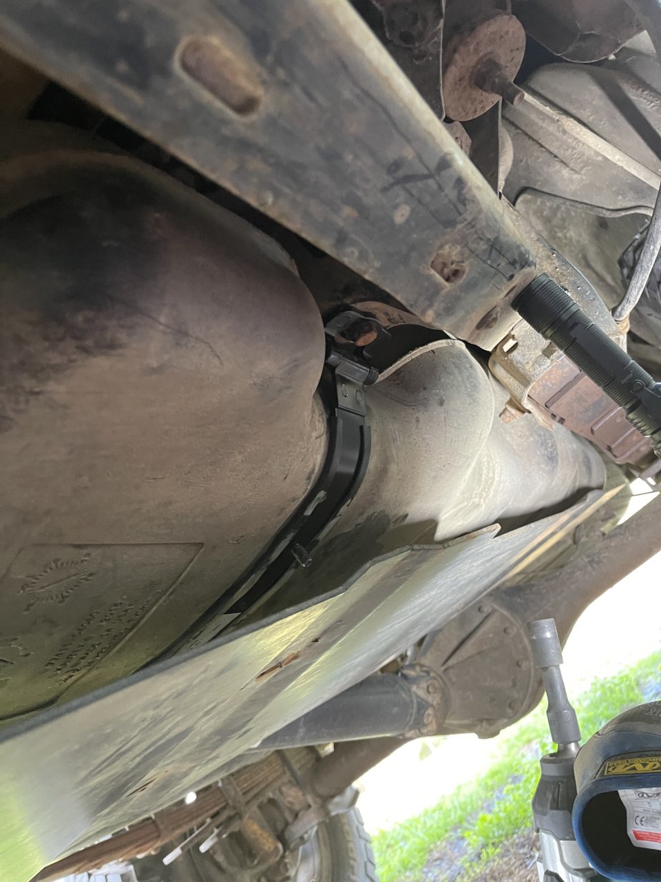

    I think it was a touch broken lol!
    All fixed up idk what brand fuel tank skid that is looks like sos but not sure? Also have I mentioned that makita impact is the best tool investment ever.

    Look close by we’re that stud is on the left it’s broke in two the only thing holding it was that rubber isolator, it was touching the driveshaft is how I noticed it. Drove it 3 hours with the rear strap hanging on lol.

    Yea I thought when I got it that skid/gas tank looked like it was hanging low wasn’t until I picked up and realized I could push it up and that rubber isolator thing was rubbing the driveshaft lol. Did they put the same size gas tanks on the rc cause I swear this holds as much as my dclb?

    Yea I ordered the replacement off the vin then I remembered shit it’s got that skid plate so had to order off road straps, but it wasn’t a big deal they swapped for the right one. Thanks man it’s fun I enjoy driving it more than my double cab, love the 4cyl 5speed. Hey found some dog tags in it want me to mail them to you?
