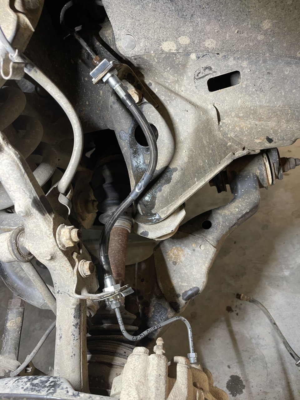

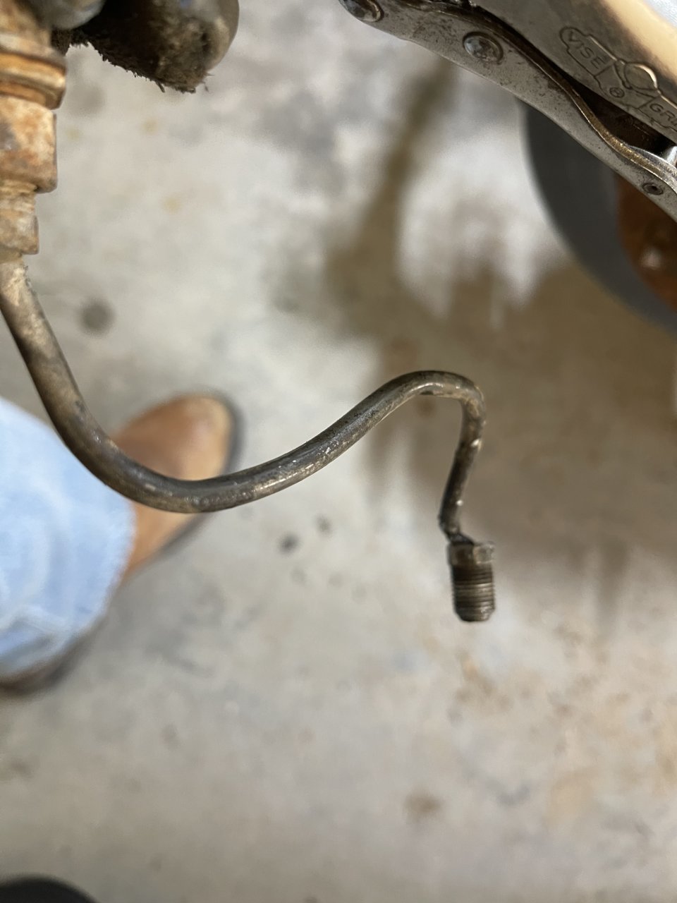

    Got the rear diff tcase changed with just regular old valvoline 75w90, the trans got some redline mt90 made it pretty smooth. Found the caliper hardline bent almost flat against the caliper may try and repair that tomorrow. :bananadead:

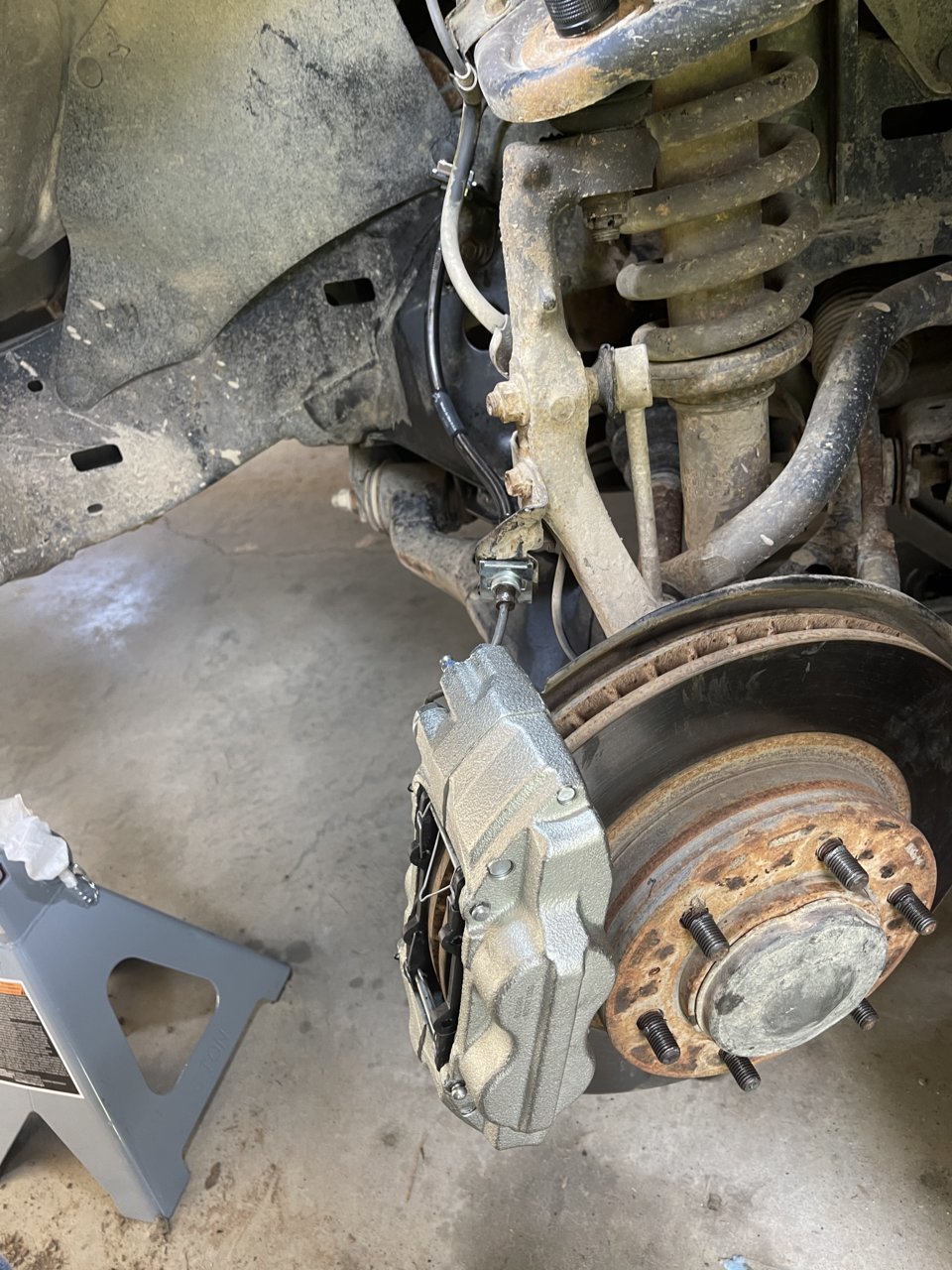

    Well had some crown brake lines meant for the blue truck but that lil s hardline by the caliper was almost broken so I decided to fix that before I drove it this week you know needing brakes and all :thumbsup:.

    Ended up having to get a new caliper after that ease out broke the mechanic at work helped me drill it and drilled to far so new bleeder screw wouldn’t stop the leak. So that and some new ceramic pads and crown brake lines and she’s back on the road.

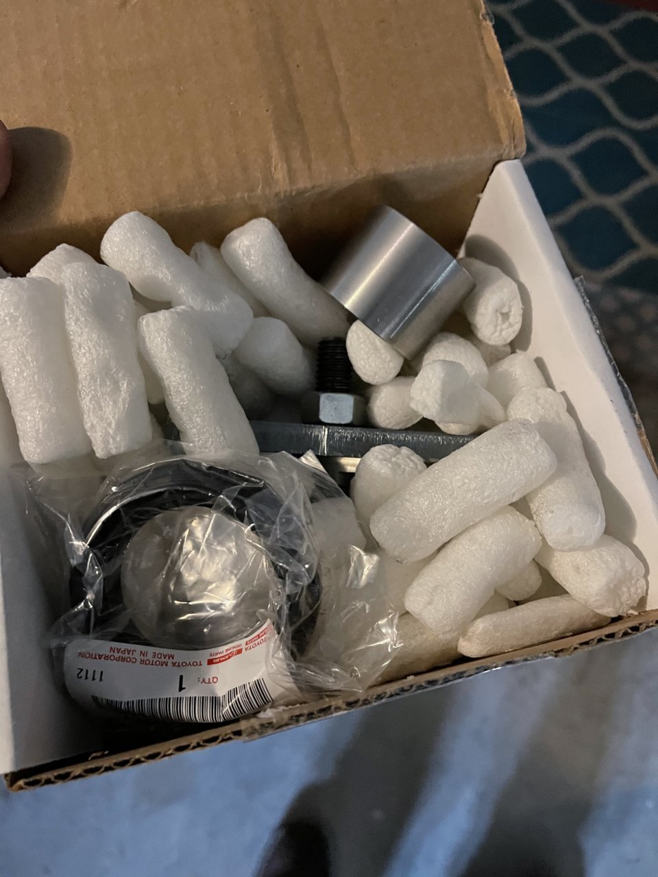

    Got the ecgs bushing and seal oil and an axle ready to go in just gotta find some time.
