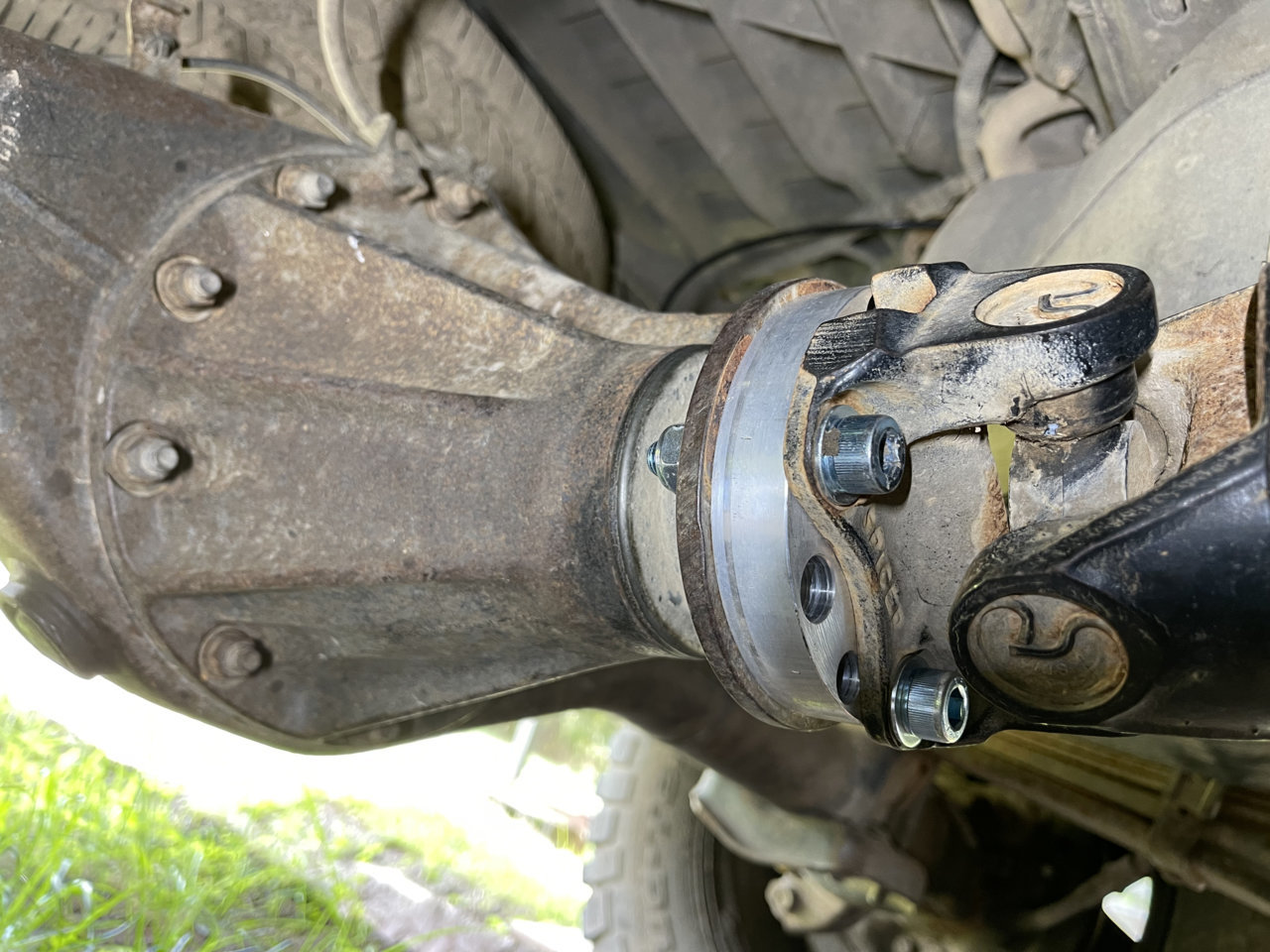

    Well put the ds spacer in, happy to report that it’s took mostly all of the vibration/grinding out of it so must’ve not had enough spline contact.

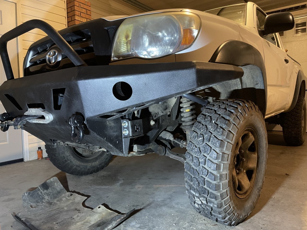

    Anybody see what’s missing here???
    Lol give ya a hint, luckily I had my old factory bump stops off the blue truck these will do till I do a ubolt flip with some superbumps one day.

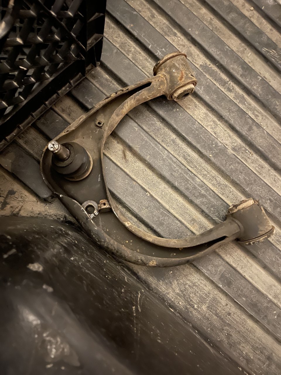

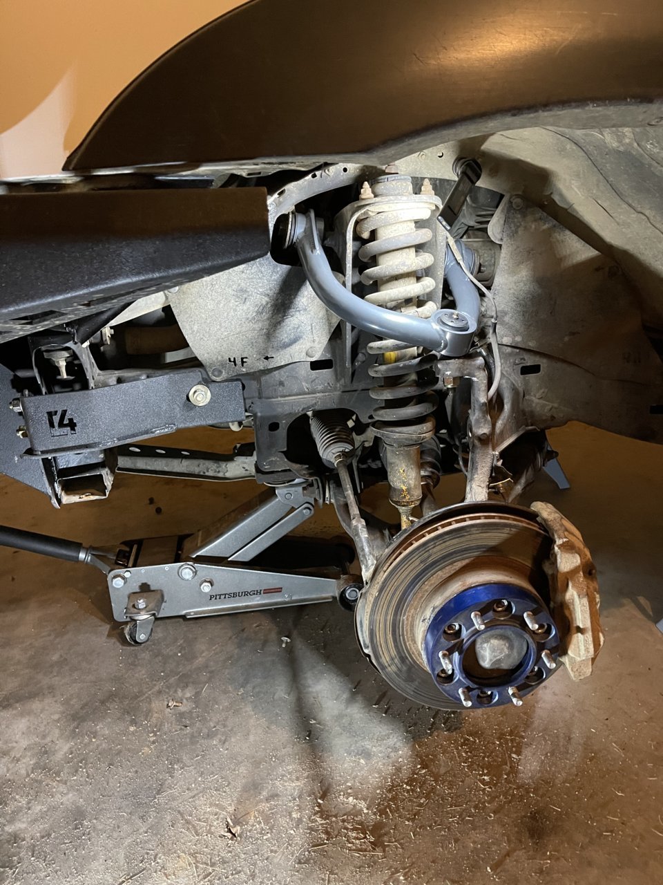

    Well decided to start the front end upgrade installed jd fab uca and the c4 bumper reinforcement, deleted the sway bar, and added some spidertrax wheel spacers I had. The nut rounded off on the ds uca so had to cut it off, turned into a pita so maybe I can finish the ps tomorrow and install my old ome nitto chargers off my blue truck their in better shape than these.

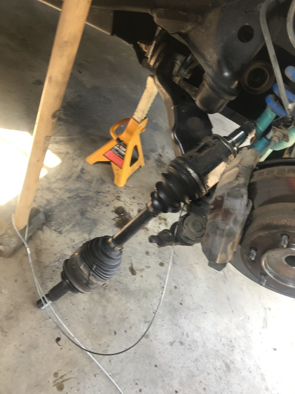

    Make sure you have plenty of beer on hand, a race driver, and a friend when you do the ECGS bushing. It's not fun, and takes all day if the CV doesn't want to come out, or the bushing doesn't want to go in.

    Yea I’ve done it on my blue truck wasn’t too bad that time, the passenger side axle gave me a fit compared to the ds it popped right out. I built a heavier cable to snatch it out so I’ll prolly try that method again. I gotta see if my race driver I bought fits the bushing I’d forgot about that.

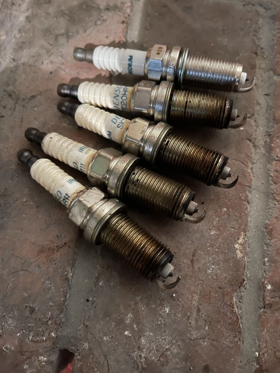

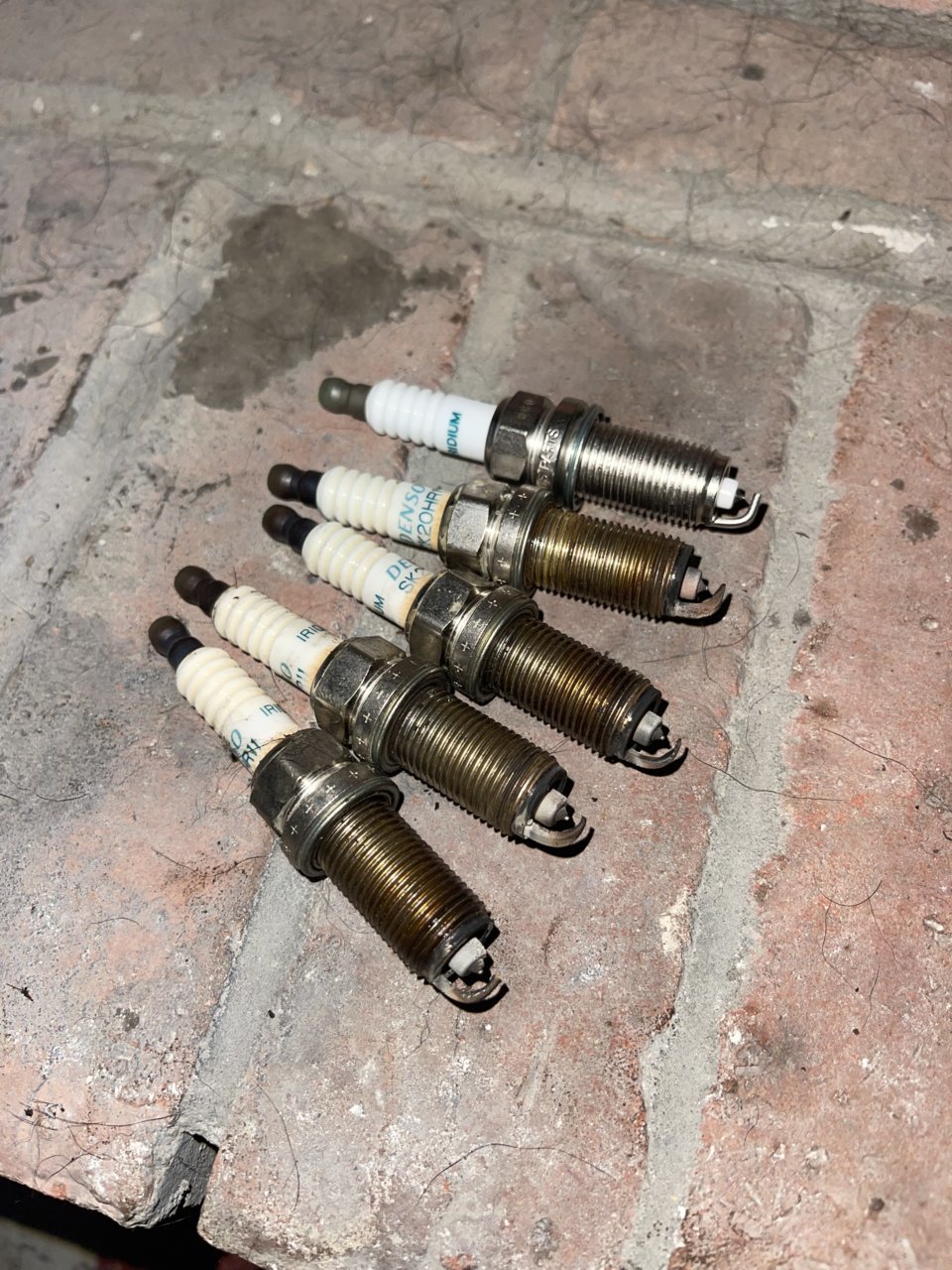

    206,400 miles on the rc truck and changed the spark plugs and cleaned the throttle body and maf sensor. Think those could’ve been original plugs the metal end was even worn thin.

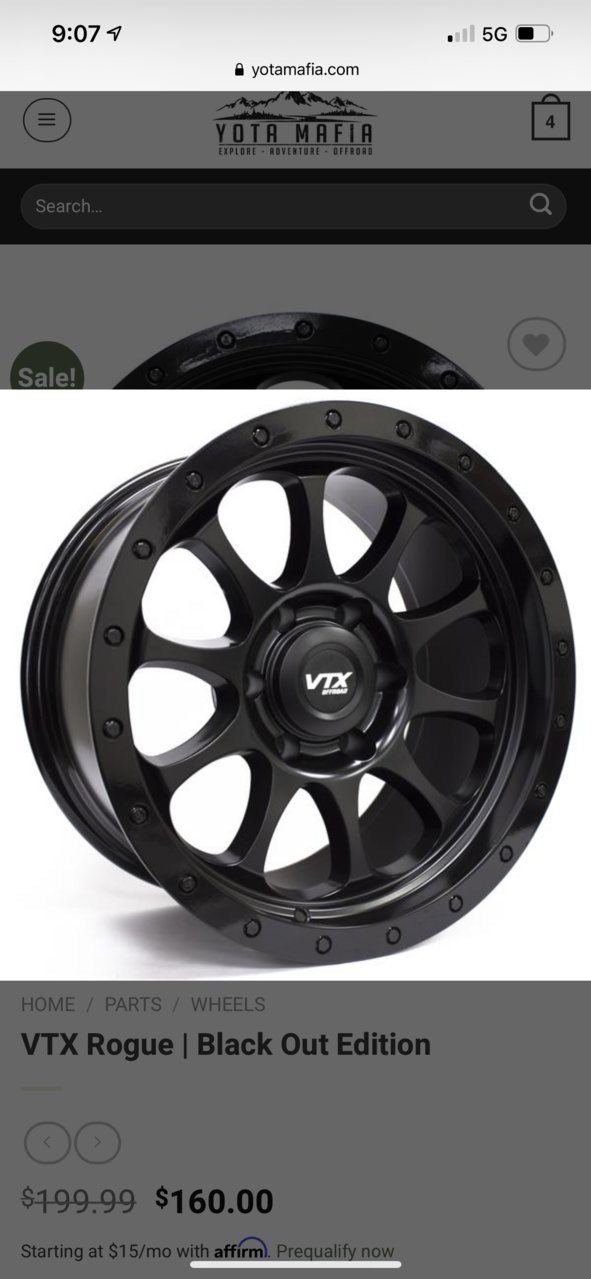

    Yea just looking for some cheap decent black wheels in a 16. I’ll check them out thanks!

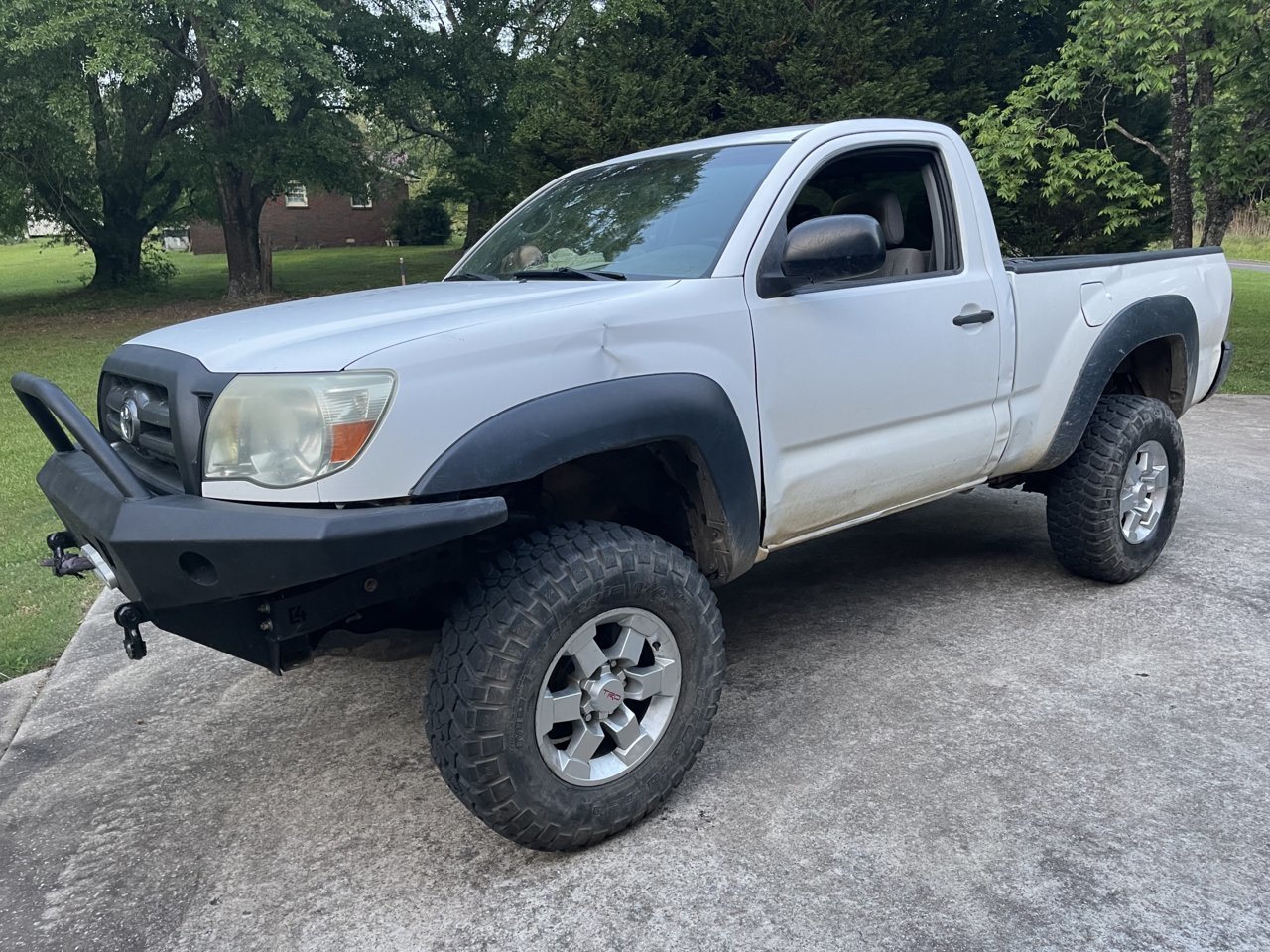

    Got the new to me trd wheels on the rc last night.

    That little truck is looking good!!!

    Thanks man that bumper helped a ton for looks I’ve used the heck out of it, it’s been an awesome work truck so far.
