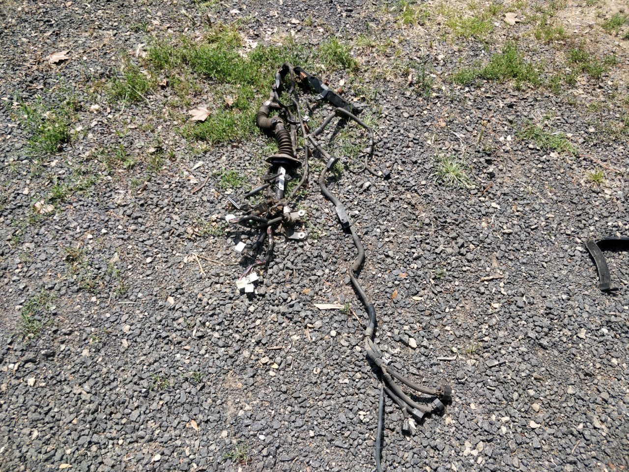

    Well I got everything out, should be ready to pull now. I'm sure there's some straggling bits but I'll find as I'm pulling it out.
    You know when you get so frustrated you just want to say f*ck it and break everything, that's what you'll look forward to when trying to pull the harness out :D

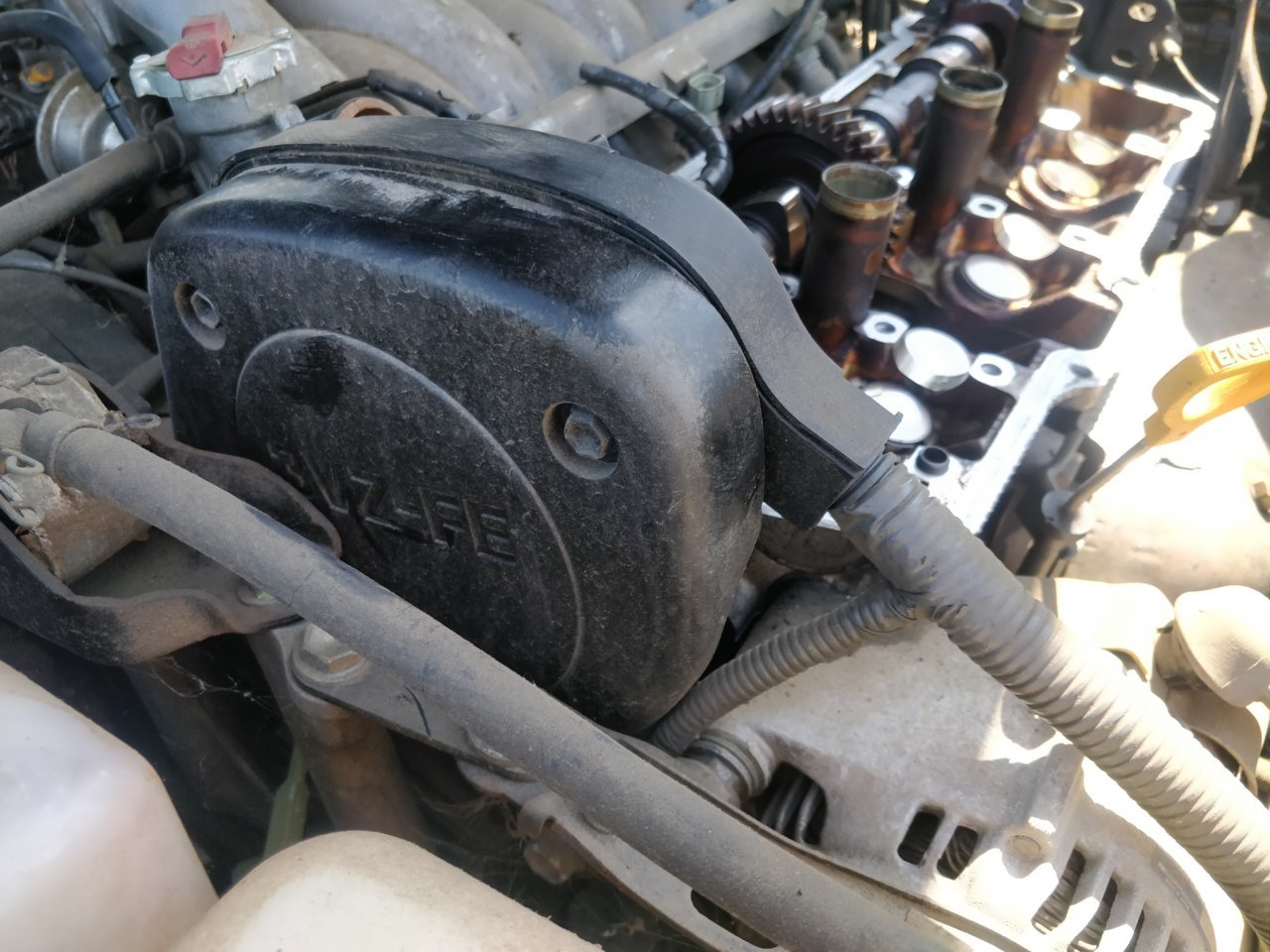

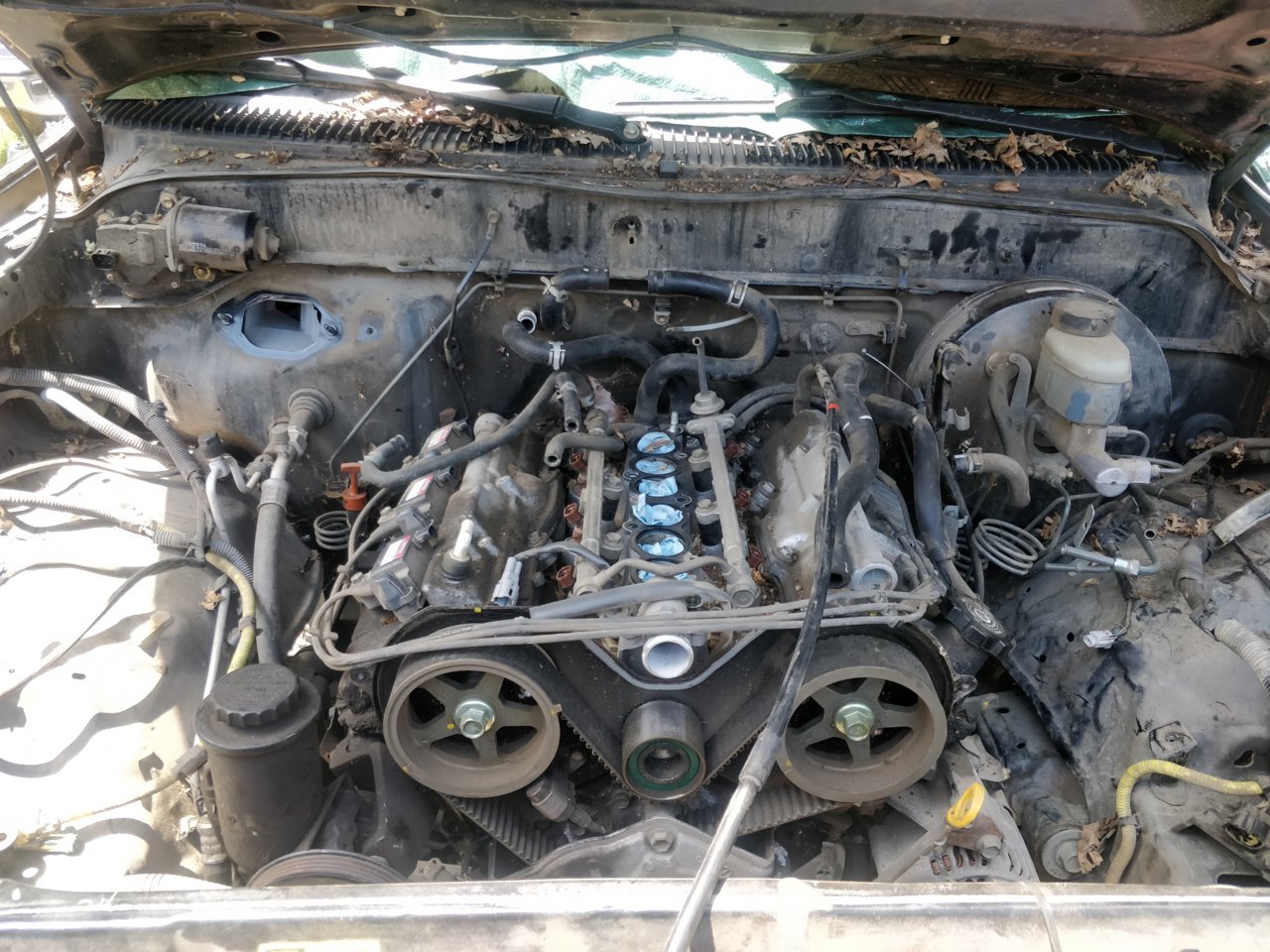

    Alright, found one lol
    Got the cams and sprockets out, taking a break and then gonna go back for the crank, try at least

    Was unsuccessful with the crank, didn't have 12 point sockets for the connecting rod nuts. Gonna go back and try again when I get them. Got a lot of waves from Tacomas, don't know if it was any of you guys :wave:
