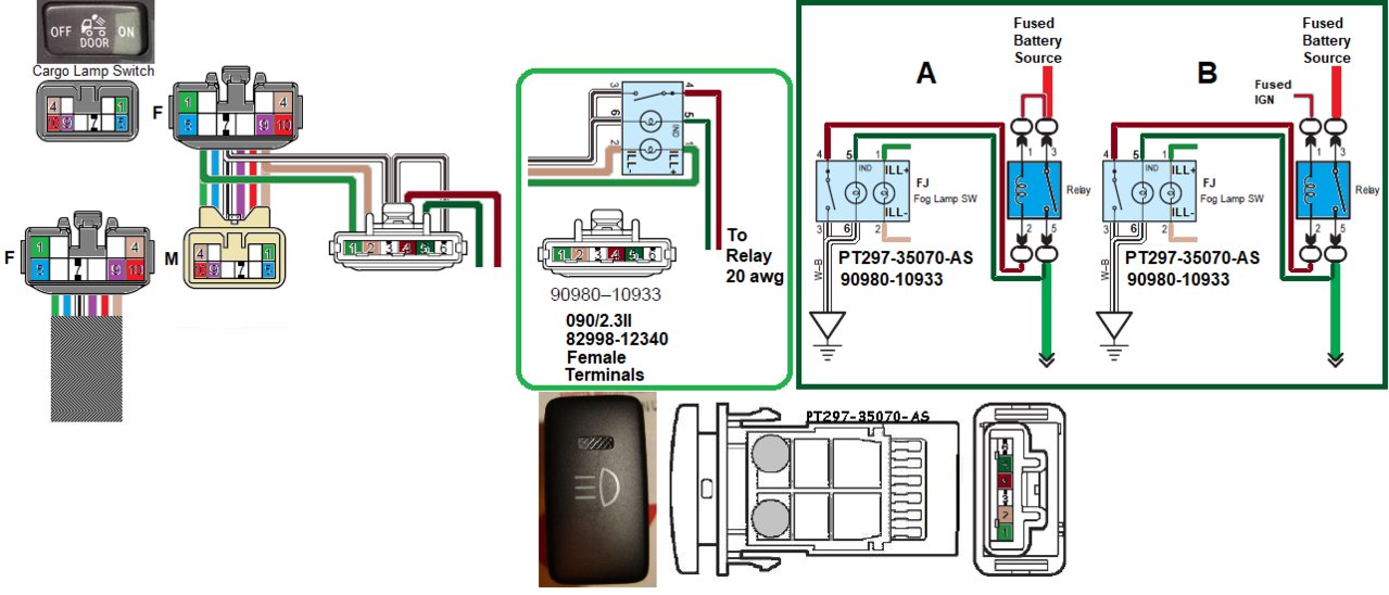

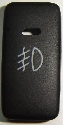

    The one from Caribe’s example is the fog switch for the FJ. PT297-35070-AS plus the connector that mates with it.

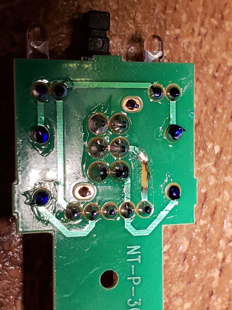

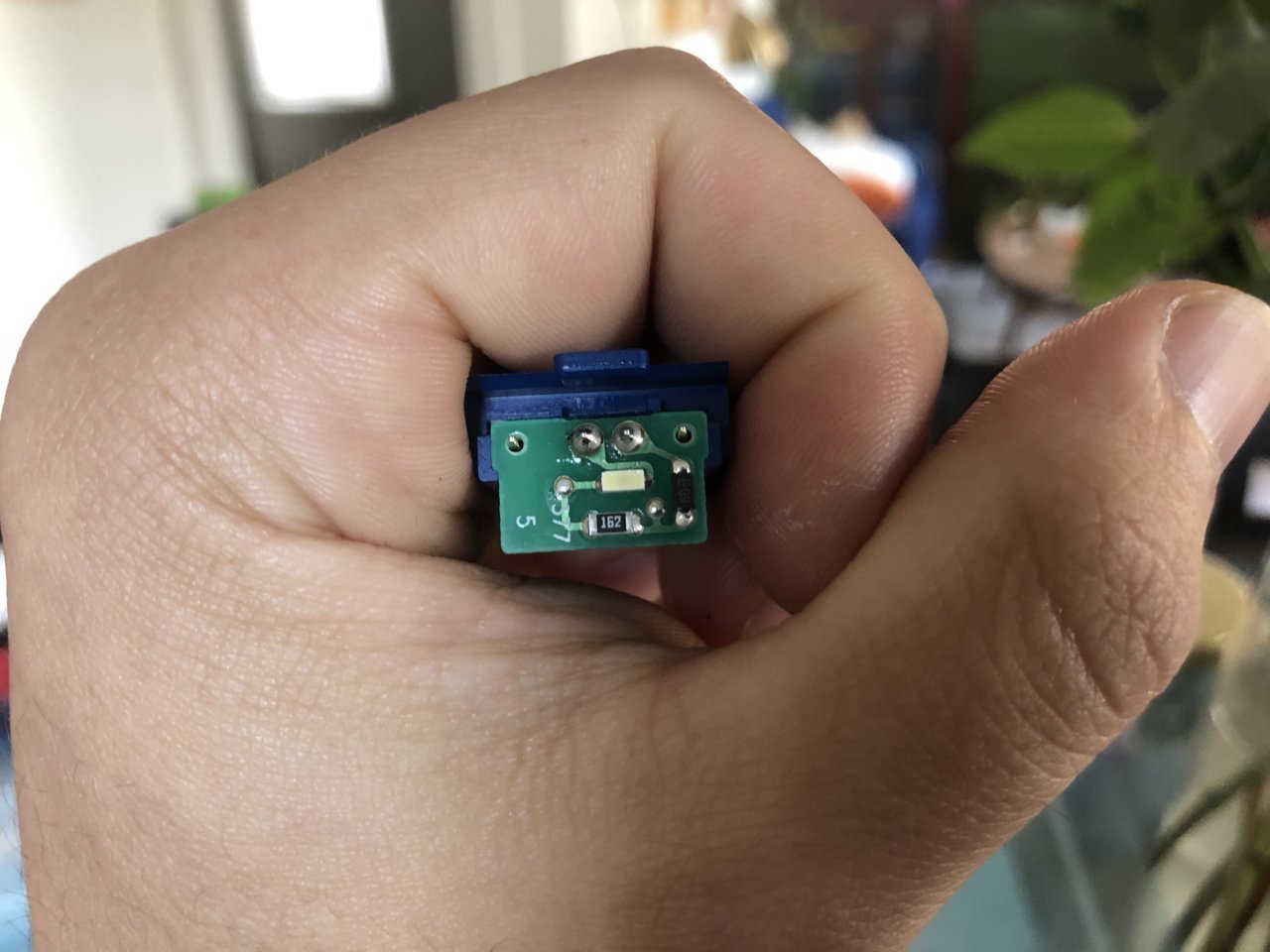

    2110 (much smaller). Here’s what they look like on an OEM board.
    Definite “mod at your own risk” situation... running the hot air too high can melt stuff.

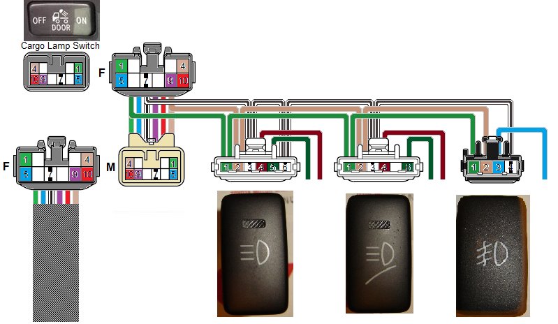

    No trouble at all. It's one thing to see it on "paper", another to have it in your hand. :rockband:

    Oh the drawings completely makes sense to me. I'm more referring to the fact that these symbols:
    Screen Shot 2021-05-06 at 10.16.04 AM.jpg Screen Shot 2021-05-06 at 10.16.06 AM.jpg Screen Shot 2021-05-06 at 10.16.09 AM.jpg
    Would make a hell of a switch panel :rofl:

    Have a part number for those ice blue leds?
    Would be nice to have the switches match the oem dash lights.

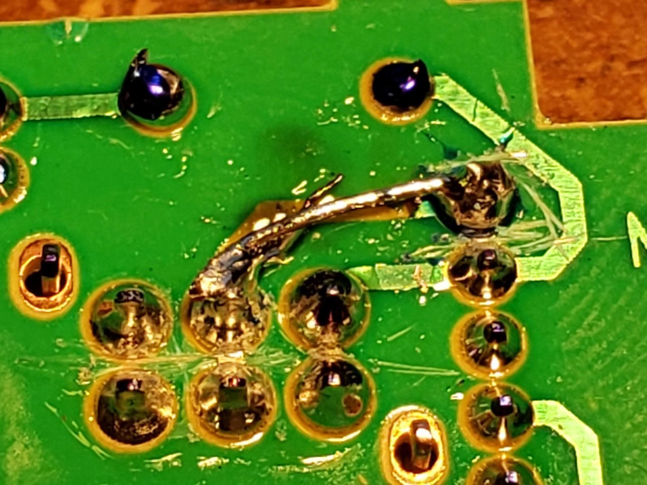

    Been known to go a bit beyond simple plug and play. Blew the trace of the switch board. And being "resourceful" otherwise known as cheap.. I had to see what went wrong.. when the switch stopped working.
    A simple fix and a fe w minutes of time..
    Still working to this day.

    They are harvested from an interior LED bulb using hot air :D The axial lead LEDs are from an Amazon kit. The CH4x4 switches call for a 3 mm axial lead LED.

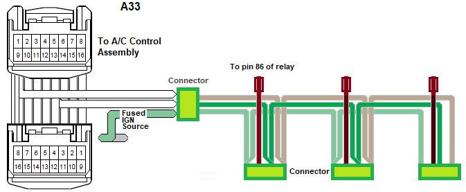

    Maybe soon?
    If MESO's panel is ever availableo_O:D:burp:
