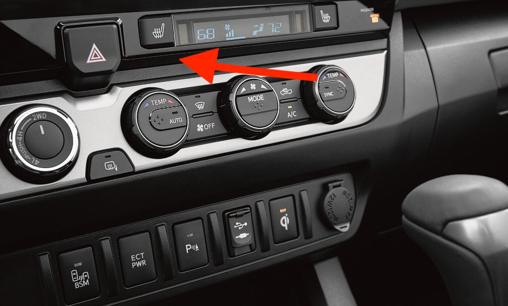

    @kmorgan3 if we did the MT harness for under the radio, which switch do we connect/tap into for the illumination? The parking sensor switch?

    The HVAC plug, IIRC.

    It's for the HVAC control connector. Remove the head unit and then reach your hand down around the ridge to find the connector roughly in this area:
    It will be black

    God, you guys are legends. Got it to work. Thank you!

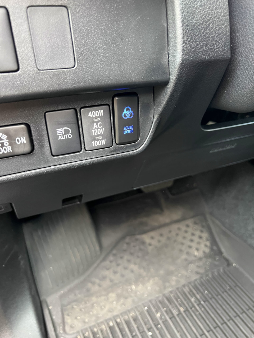

    Installed mine today. Took about 10 minutes to do the two switches I needed illuminated. Works great!
    Now I have a few spares for the other switches that will be going in!
