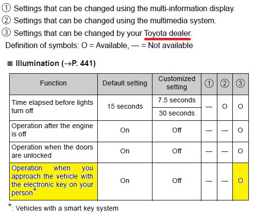

    I'll check tonight. Tried in the day but it's too damn bright out. I know it at least turns on when a door opens but don't think it's on when I approach prior to unlock.
    The A-pillar tap is the one I hear about the most but I'm guessing there's gotta be another tap? Or would it even matter since that 24awg is on the same circuit so is the limiting factor?

    Ok, confirmed my cargo light does NOT come on when I approach the vehicle. Switch was in door mode.

    Hood Struts, My version Fogs always ON, Map & Overhead Light Mod,

    That's for the cargo light? I could adjust that but I'm fine with just the maps and domes fading on/off and using that to trigger just the rack and slider lights.
    Hm, as I think more about when I'd use the bed and aft lights, I'd probably be fine with just manually turning those on when I need them. I'm already planning to build a switch panel back there anyway.
