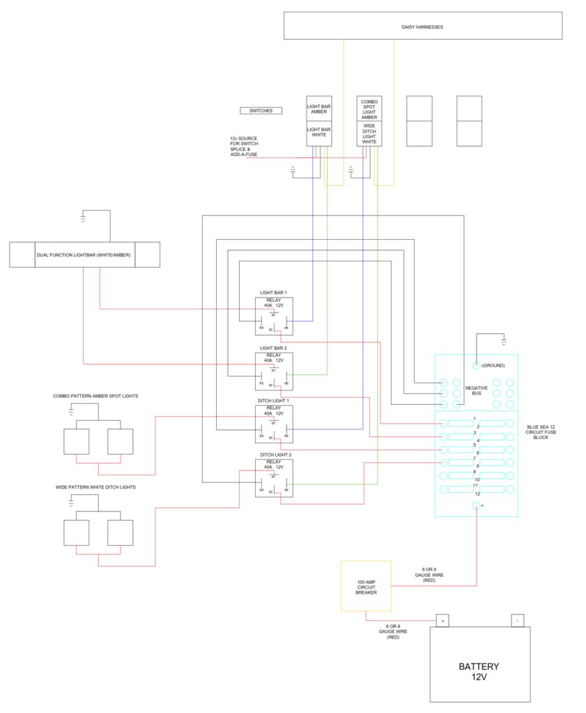

    Hey there! Just came across this thread and I'm in the midst of figuring out how to wire up some new lights I'm looking at. I wanted to use the CH4x4 dual switches as well. Do you still offer daisy chain harnesses for those? Below is a quick wiring diagram I came up (apologies if it's chaotic, I don't normally make wiring diagrams) with for a dual function (amber & white) light bar and two sets of ditch lights. Was hoping to use the daisy chain to illuminate the switches but all I've found online are the single switch (4 wires) daisy chains, nothing for the dual switches (5 wires).
    Skimmed this whole thread, to my understanding I wouldn't be able to add in a single switch if I've already got dual switches daisy chained correct?
    (PM'd you as well)
