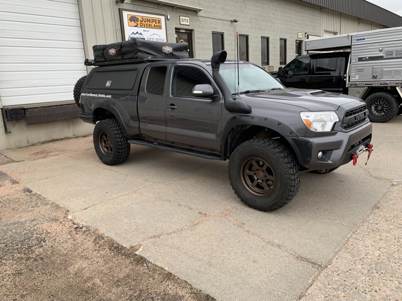

    Some of the things...
    Current Pic as of 4/33/19
    Current Mods:
    Front Suspension:
    5100's
    OME 887's
    1/2" Toytec Spacer on Driver's Side
    1/4" Wheeler's Spacer on Passenger Side
    Wheeler's Super Bumps with 1/4" Spacers
    Sway Bar Delete
    Camburg BJ UCA's
    Rear Suspension:
    B110 5100's
    OME EL096R Springs
    Wheeler's U-Bolt Flip
    OME Bushings in leafs and factory shackles
    Dobinsons Greasable Bolts
    Defined Engineering Shackle Mount Crossmember
    Drivetrain:
    TRD Supercharger
    AFE Stage 2 CAI
    Oil Catch Can
    Hurst Core Shifter
    URD Stage 3 Clutch
    URD TOB and Sleeve
    OEM Clutch Accumulator Removed
    Airflow snorkel
    Armor:
    Pelfreybilt IFS Skid (Aluminum)
    Pelfreybilt Trans Skid (Aluminum)
    Pelfreybilt Mid Skid (Steel)
    Pelfreybilt Gas Tank Skid (Aluminum)
    US Offroad Winch Mount Bumper W/ XRC 9500
    Allpro HD Bolt-On Sliders
    4xInnovations High Clearance Rear Swing Out Bumper
    Misc:
    eBay bushwhacker flares
    Tires:
    Current: 315/70/17 procomp mt2s
    Old;285/75/17 Toyo Open County M/T's (33,000 Miles, no flats yet)
    Old: 265/70/17 C Load Goodyear Duratracs (20,000 Miles, 8 flats)
    Old: 255/80/17 E Load Cooper S/T Maxx (47,000 Miles, 1 flat)

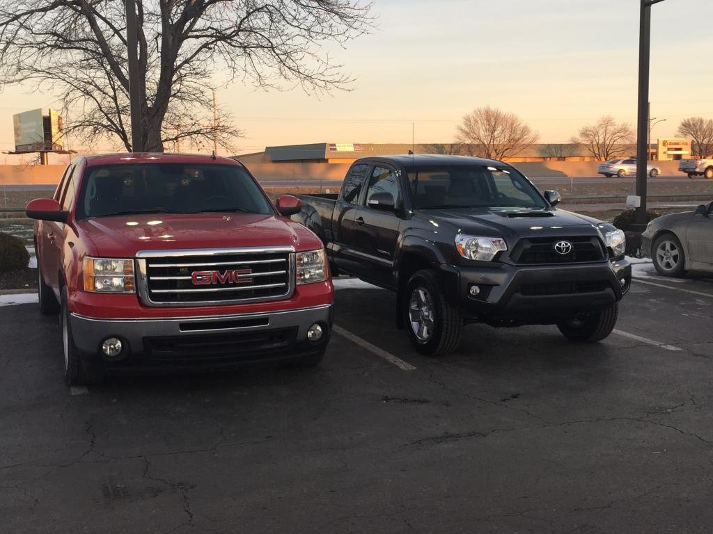

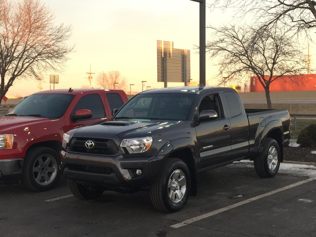

    Hey guys, figured I'd throw together a build thread to help me track mods and share photos. I traded in my 12' GMC on this truck and was sorry to leave the power behind but I love this new truck in every other way.
    Ordered it October 3rd of 14 and took delivery January 6th, 2015.
    The Truck:
    2015 TRD Sport Access Cab 4x4 MGM 6 speed with every option except JBL
    First impressions:
    It rides way nicer than my 2wd GMC did. The 6 speed is awesome although my other DD is a 13' BRZ with a short throw shifter so switching back and forth throws me for a loop. It seems to have a decent amount of power for what it is. Alot of people claim the 4.0 is lazy and doggy but maybe the 6 speed makes up for it? Anyway I wasted no time getting black SEMA 4runner wheels and 265/70/17 Duratracs mounted. Then I dipped the emblems. The tires rubbed badly on the front flaps so i pulled them off along with the rears. I installed the husky liners (xact contour) after reading the review here on TW and I love them. Also I put in the TRD quick shifter and knob and had the windows tinted.
