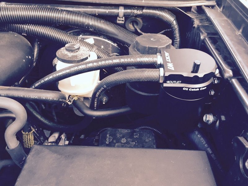

    ADD W1 catch can:

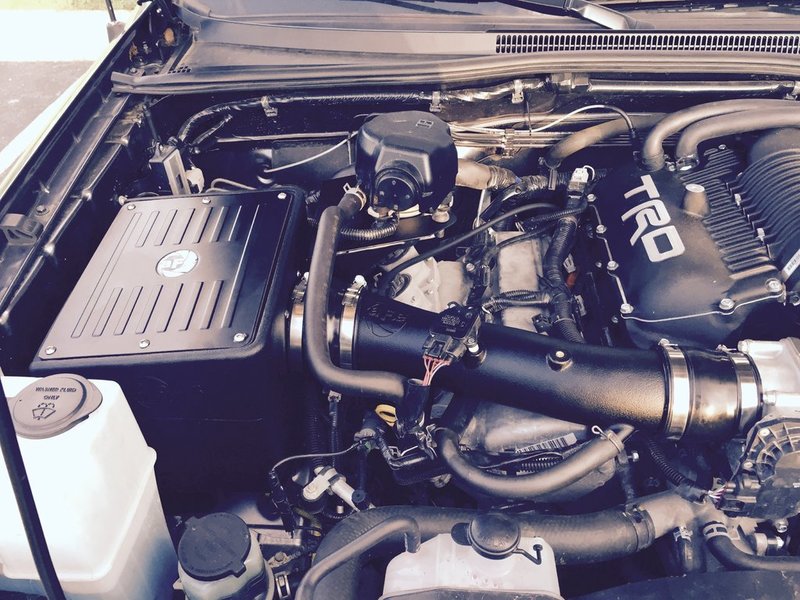

    I was just getting to the point where I wasn't roaring off from every stop light... Now with the intake I'm back in the throttle just to hear that addicting whine. I notice a decent bump in throttle response, my AFR's jumped up .4-.6 so now I bottom out right around 10 even, and it sounds wicked. Worth $400? Well I'll revisit that question after some miles. The catch can looks clean and was an easy enough install.

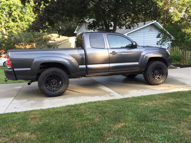

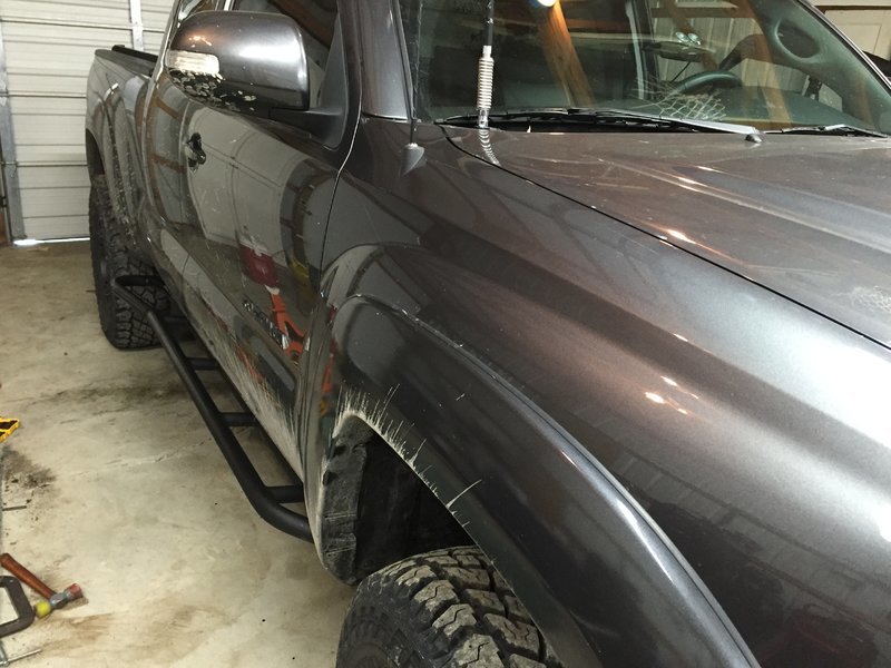

    Sliders:

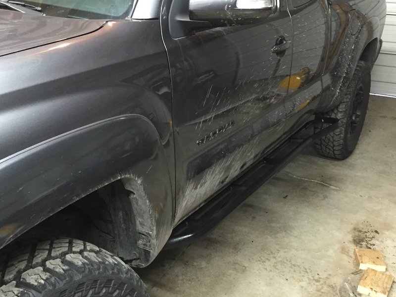

    I landed on Allpro for a set of their bolt on hd sliders. I installed them with a nasty hangover but managed to get them mounted in about 4 hours. I primed them with 3 coats of primer and top coated with 3-4 coats of dupliclor bed armor. I was disappointed at first as handling them peeled the liner right off but after reading the cans it doesn't set up fully for 7 days! The finish is nice and is rock hard now that it's dry. Easy to touch up so far.

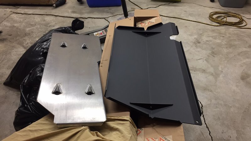

    After looking at options since I purchased my truck, I picked pelfreybilt for their ifs and mid skid both in aluminum. These things are gorgeous and I'm feeling confident about not smashing my underside bits. Total weight for the skids was 51 lbs and after removing the stock splash guard and supports (9 lbs) the truck only gained 42 lbs in the process. I left them unpainted and we'll see how they hold up to decide if I need to coat them. Oil changes will be a bitch so I did one before I mounted everything up.

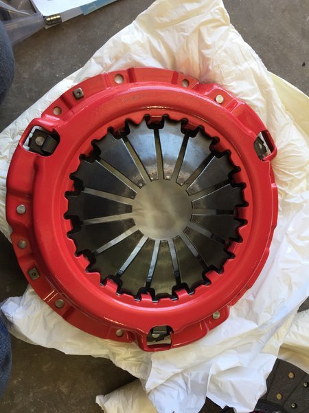

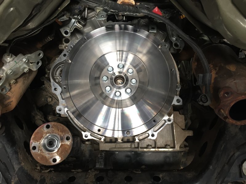

    Urd stage 2 clutch and torque u flywheel installed plus the tob fix. It's a dream to drive with the heavier flywheel and the 33's. Wish I would have done all of this when I did the supercharger. The surface where the tob rides was badly grooved and scratched at 30k miles. What a joke! The urd sleeve and new tob are super trick and really do address a factory flaw. The clutch only has 175 miles on it but it engages smooth and doesn't give the impression that it's not factory. I may have Gone stage 3 if I had known how nice this stage 2 drives.

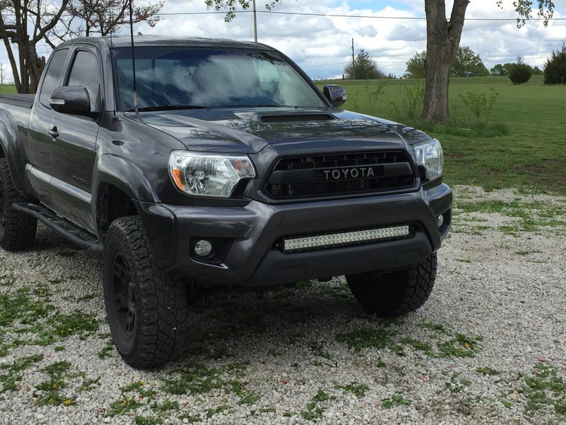

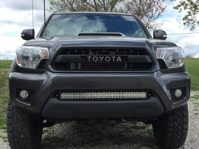

    Trd pro grill installed:

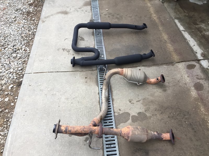

    Armor update:

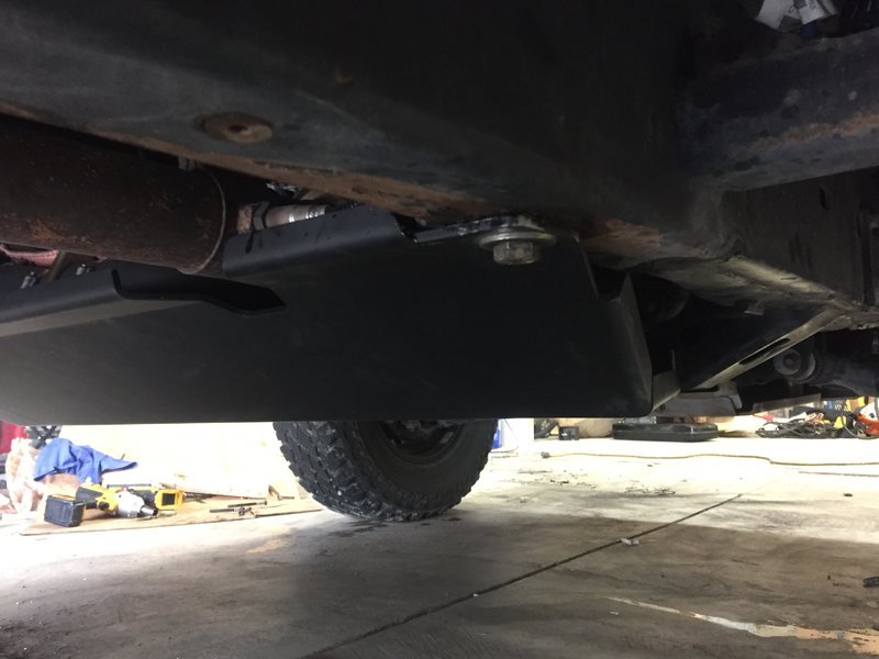

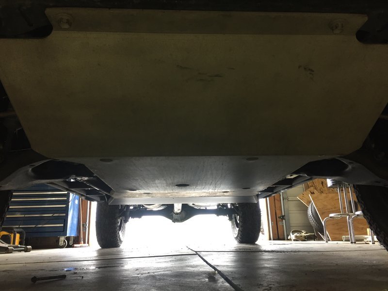

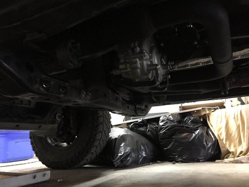

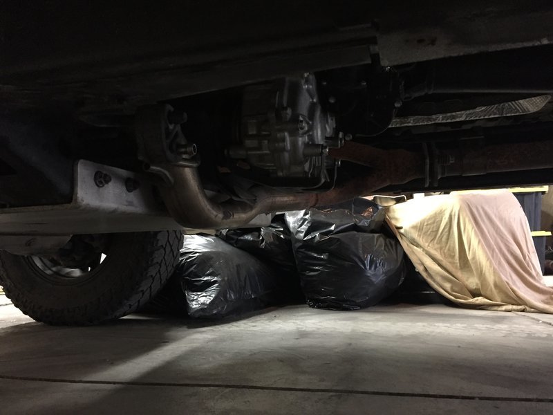

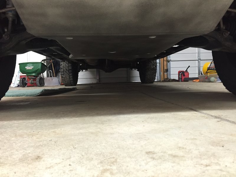

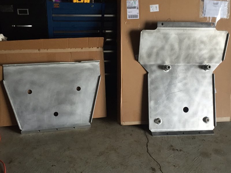

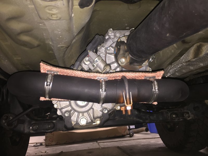

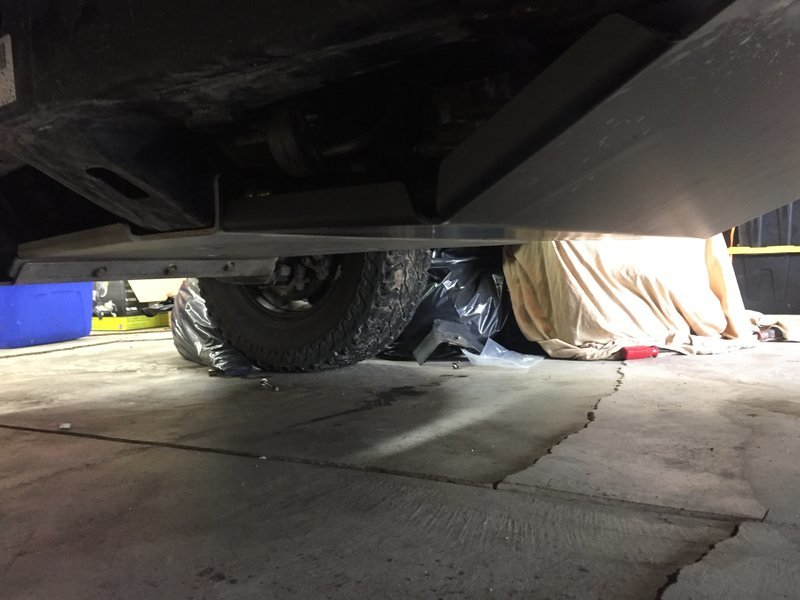

    I ordered a pelfreybilt rear skid and gas tank skid. I also picked up a Doug thorley pipe bomb y pipe so that I could have the pelfreybilt with exhaust relocation ( slightly better clearance ). I'll just photo dump and if you have any questions feel free to ask.
    image.jpg image.jpg image.jpg image.jpg image.jpg image.jpg image.jpg image.jpg image.jpg image.jpg
