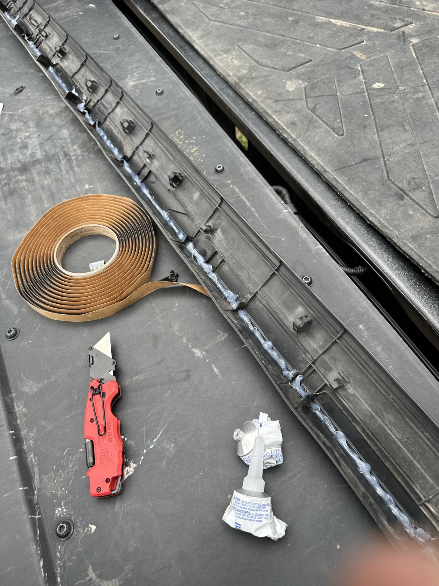

    Pretty much what everyone has already said is what I did. I also sealed the front bed rail along the cab and put black waterproof gorilla tape over the drain holes in the bed floor so I can remove it to wash out the bed or whatever. Just the tailgate seal combined with Rock Block will cut down on dust intrusion immensely. Also, unlike that video I left the outside of the bed rails unsealed to allow air/dust/water to exit towards the outside.
