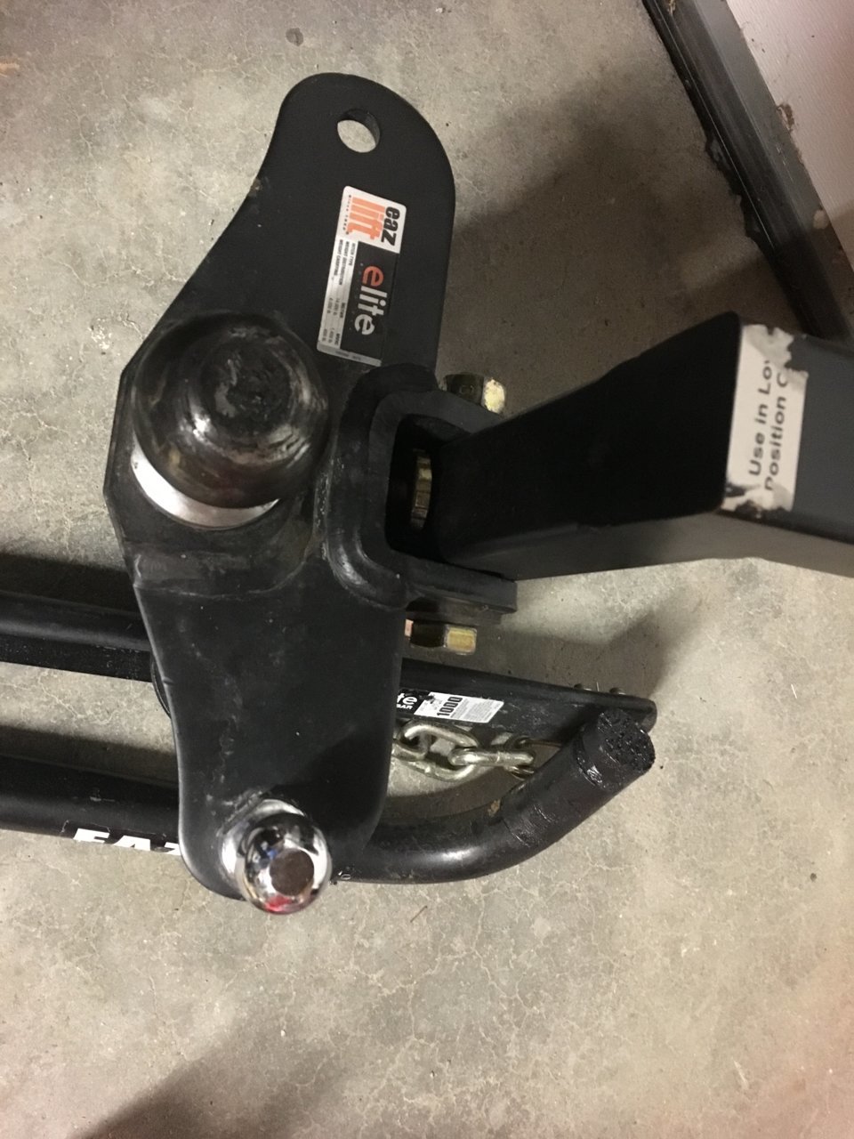

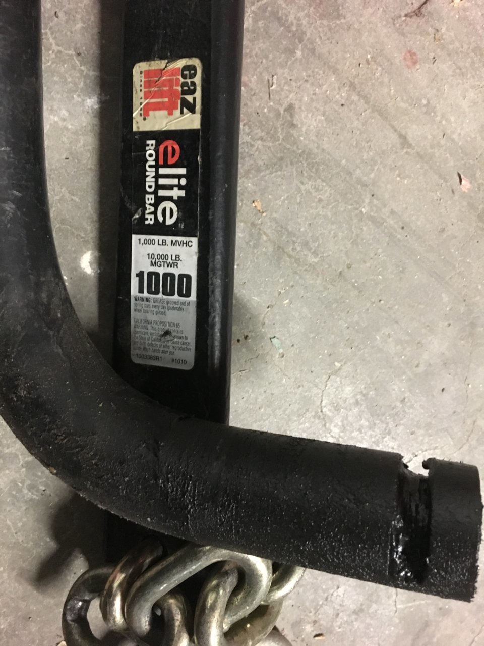

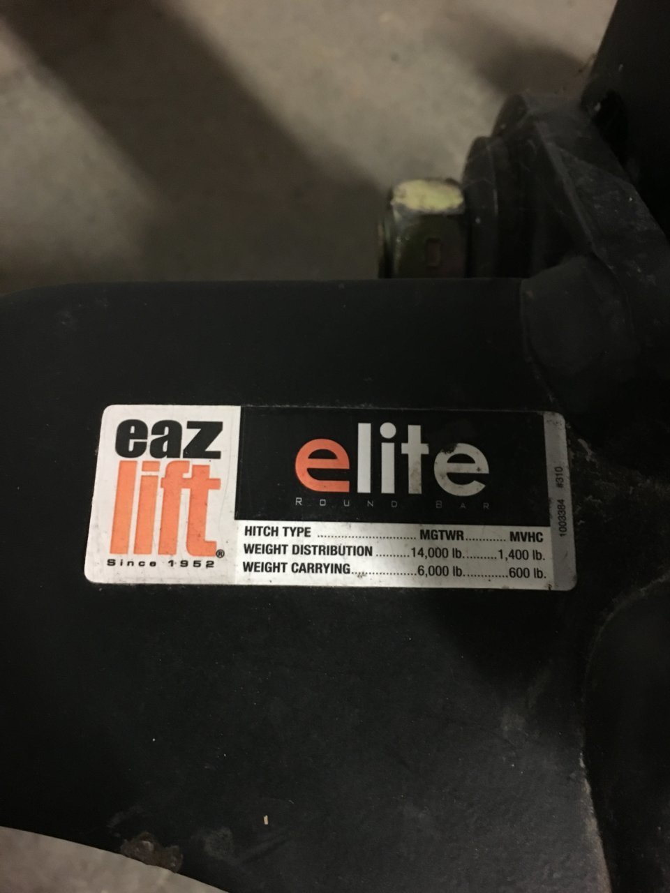

    I hitch up, run the jack down until I can hook the 5th link from the end on the round bar chain to the brackets on the trailer frame.
    When I was running stock rear springs I would hook the chain on the 6th link from the end and it would sit level but I had to nearly lift the rear tires off the ground with the tongue jack to do that.
    Here's my hitch. I have a longer than usual drop on it now because of the high clearance rear bumper.

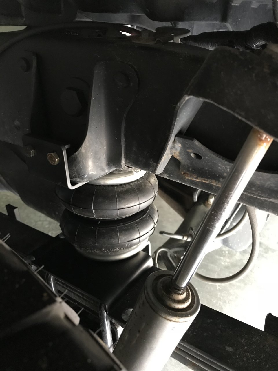

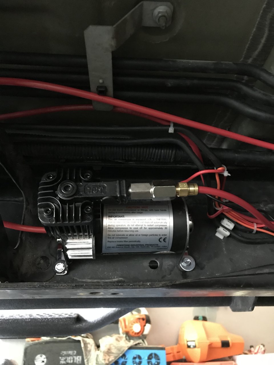

    Ride Rite air bags and compressor kit $560 through SDTRUCK Springs...easy to install.2D063BAB-9F8D-49CB-8B82-B6AB527E1667.jpg0020FC2C-413B-411D-B576-378DE15FF2AE.jpg
