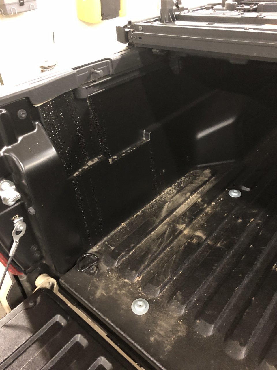

    So, mine does this too — and its not the tonneau cover — the water is getting kicked up from the tires, and going up and around the (for some reason unsealed) bedside.
    For me only on the left side because they removed the lefthand bedside cubby for 2019, which would have prevented most water from getting up there. I’d bet mudflaps would help too. Odd oversight from Toyota

    I’d look into mudflaps, or simulating the bedside cubby with something to block it. Because on my offroad model at least, its actually getting kicked up from the tire thats exposed beneath the wheelwell liner, straight into the bed cavity between fender and bed, and then up and over the bed wall

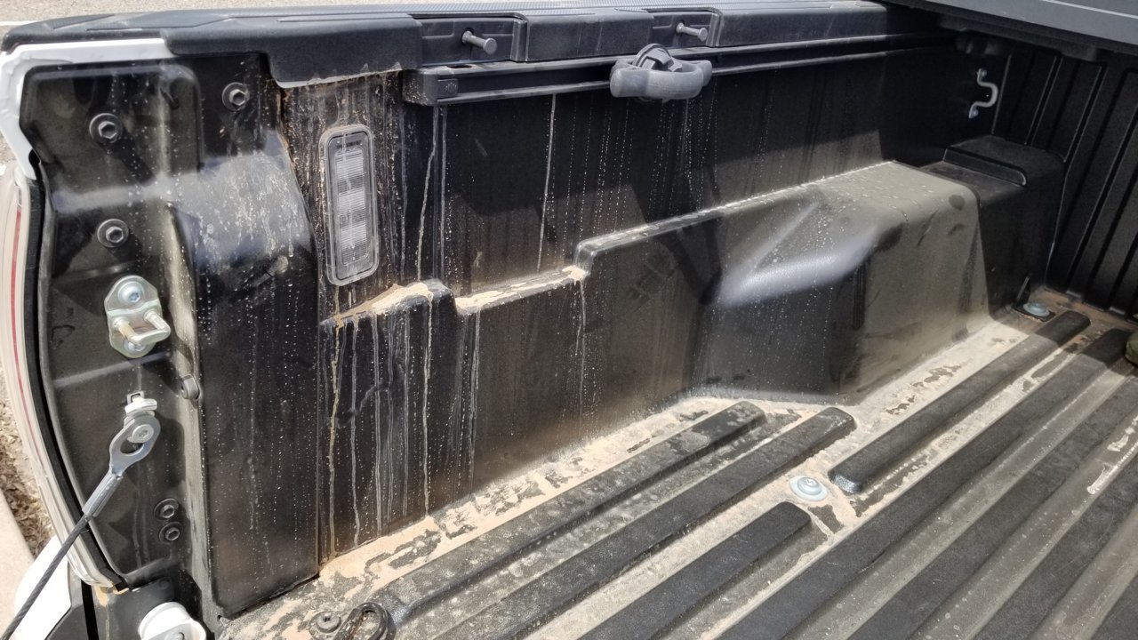

    This is the exact problem I'm dealing with right now. Tons of mud in the bed, even from just driving over slightly wet roads. I'm worried about road salt anytime I'm up north now. Did not have this problem with my 2009.
