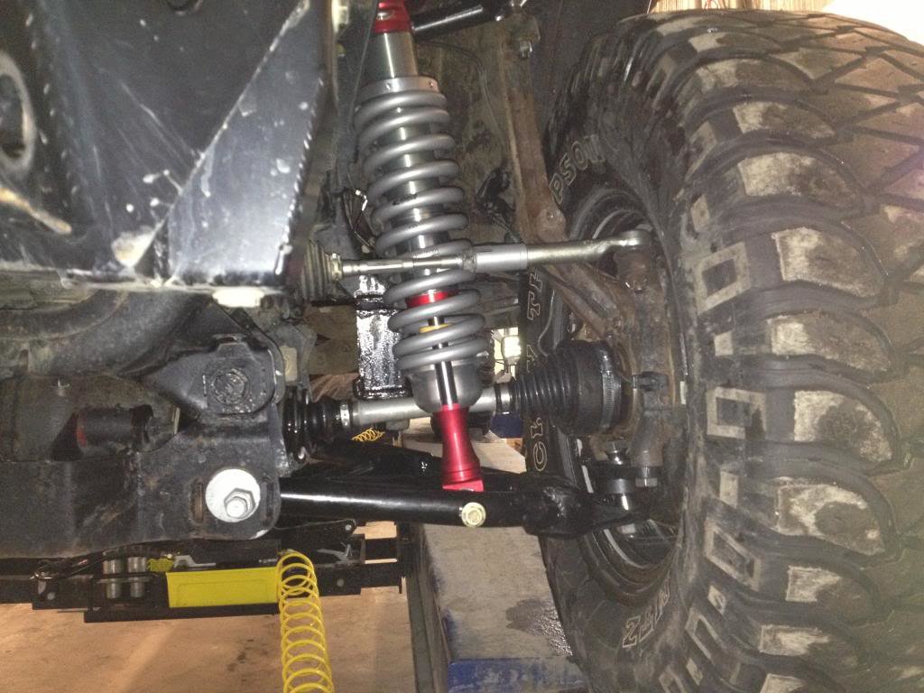

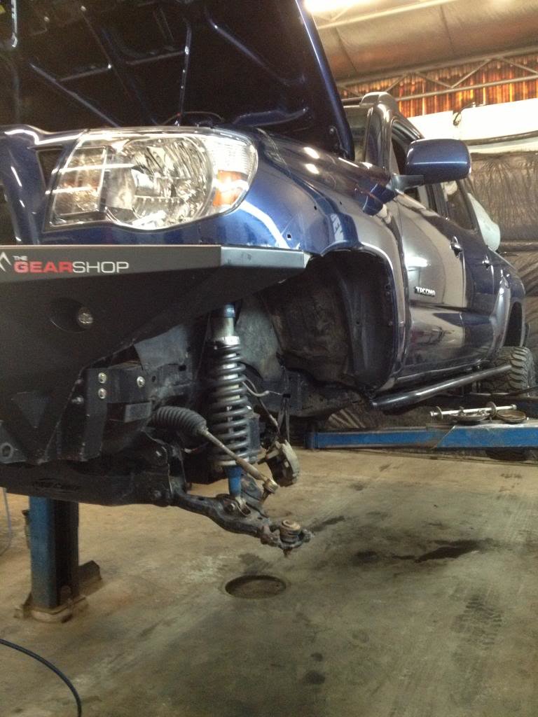

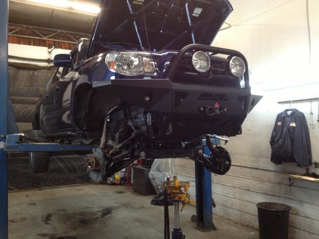

    Finally dove into this one head first with Spoonman being a Massive assistance. Big Thanks to him for his help!!! Some of the old stuff still hanging in there.

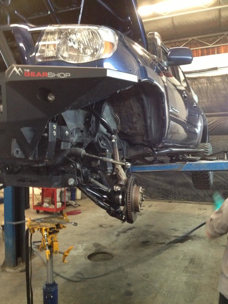

    Both sides came apart relativley easy and were ready for the new within maybe an hour and a half.

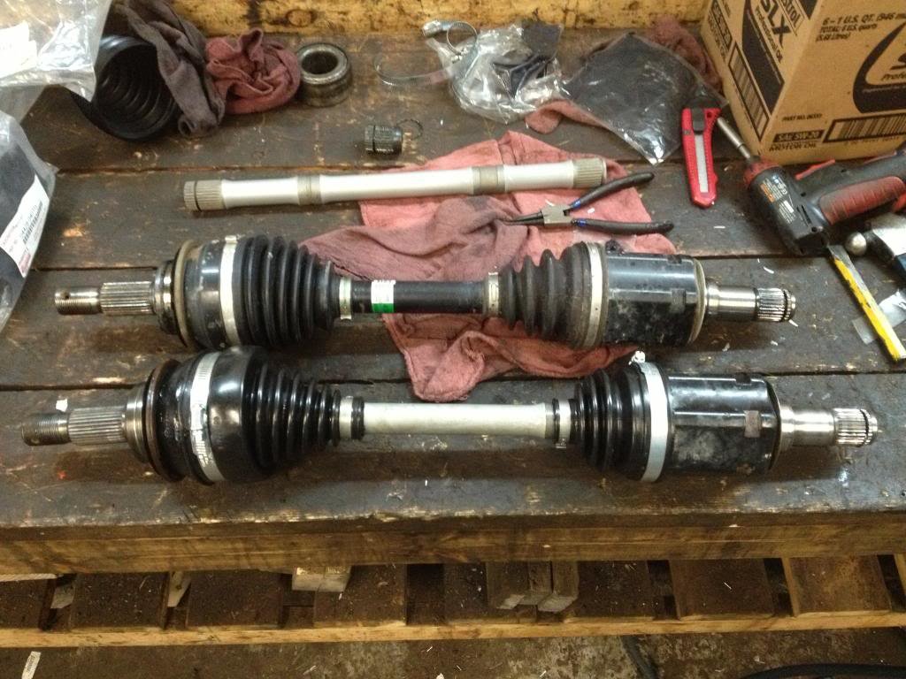

    For reals this guy needs to offer this as a service. Crazy skills on the axle work.
    Started getting the UCA and LCA's on fairly quick.
    Both new axles installed at this point.

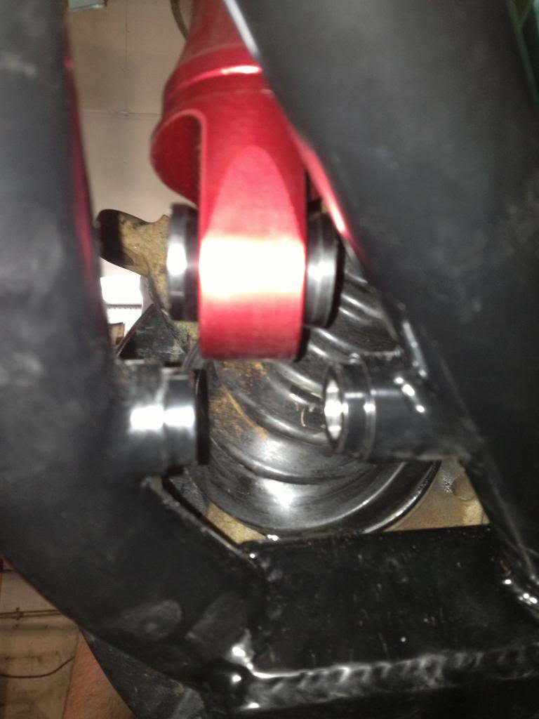

    This is where I would like to say Walker Evans fucked up!
    They shipped my coil overs with the wrong sleeves for the LCA shock mount. Heres how it looks ~ The black parts are the sleeves and they dont fit in any tighter to the actual shock. This was the first real crappy part of the day.
    In order to get the truck so it is at least mobile for the time being we needed to take away some of the stock off the sleeve with a grinder. Walker Evans will be getting a phone call come monday morning and I sure as hell hope they have what I need in stock so they can express or airmail it!

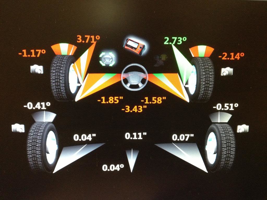

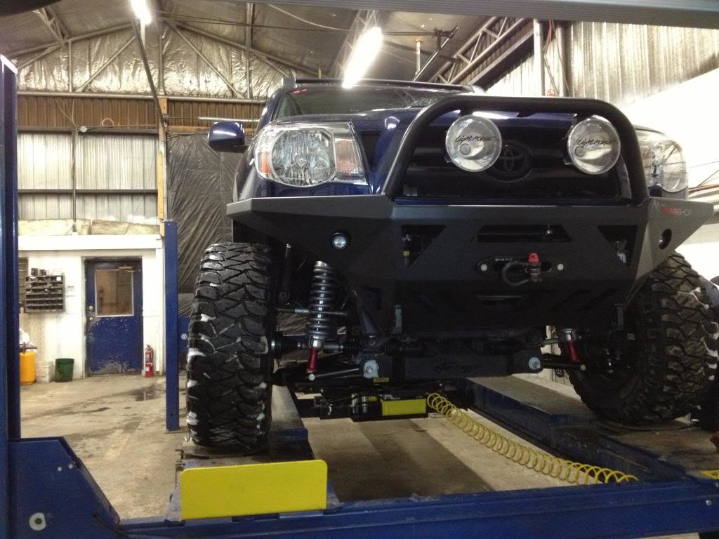

    We got it on the alignment rack.....and yes it needed it badly. That stance is wide as hell.
    Wow hahaha
    Spoonman realized while we were trying to get the alignment in or close to spec for now that we needed to trim a little off the DB. Turns out it was stopping the control arm from moving free left to right for alignment. We got that solved.
    We then discovered I will need to find some custom made tie rod extenions of a shorter length than the standard 2". Also need to re adjust coil over and put new sleeves in the lower coil over mount. Then go round two on alignment!
