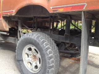

    A guy I work with did a sweet 6" "custom" body lift to his Nissan. I will put you in touch Ryan, he is a great fabricator....

    That's not a death trap at all
