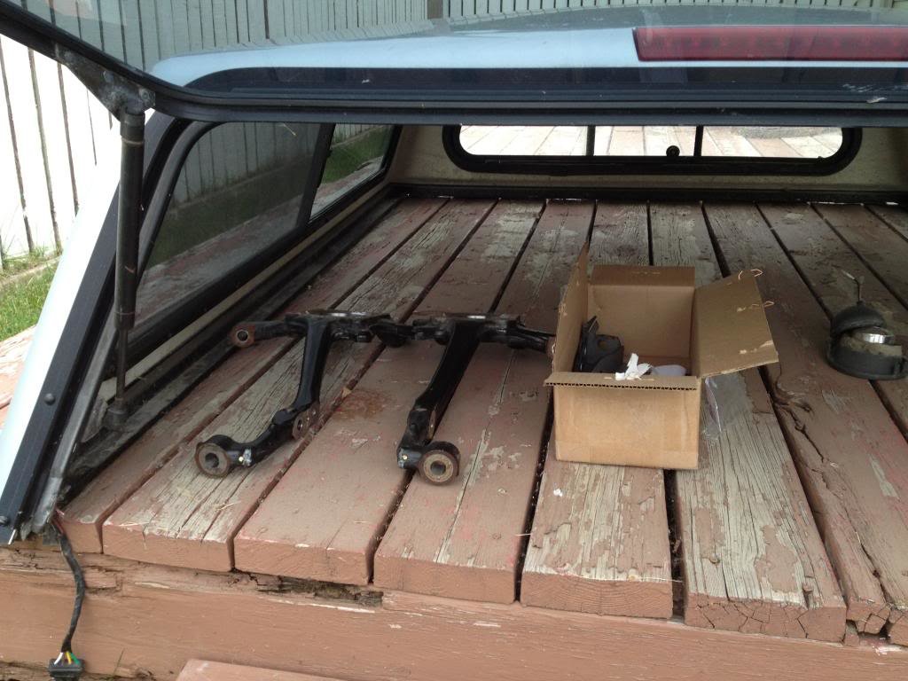

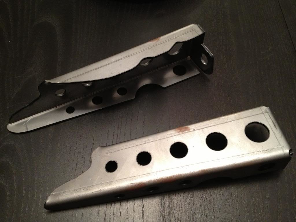

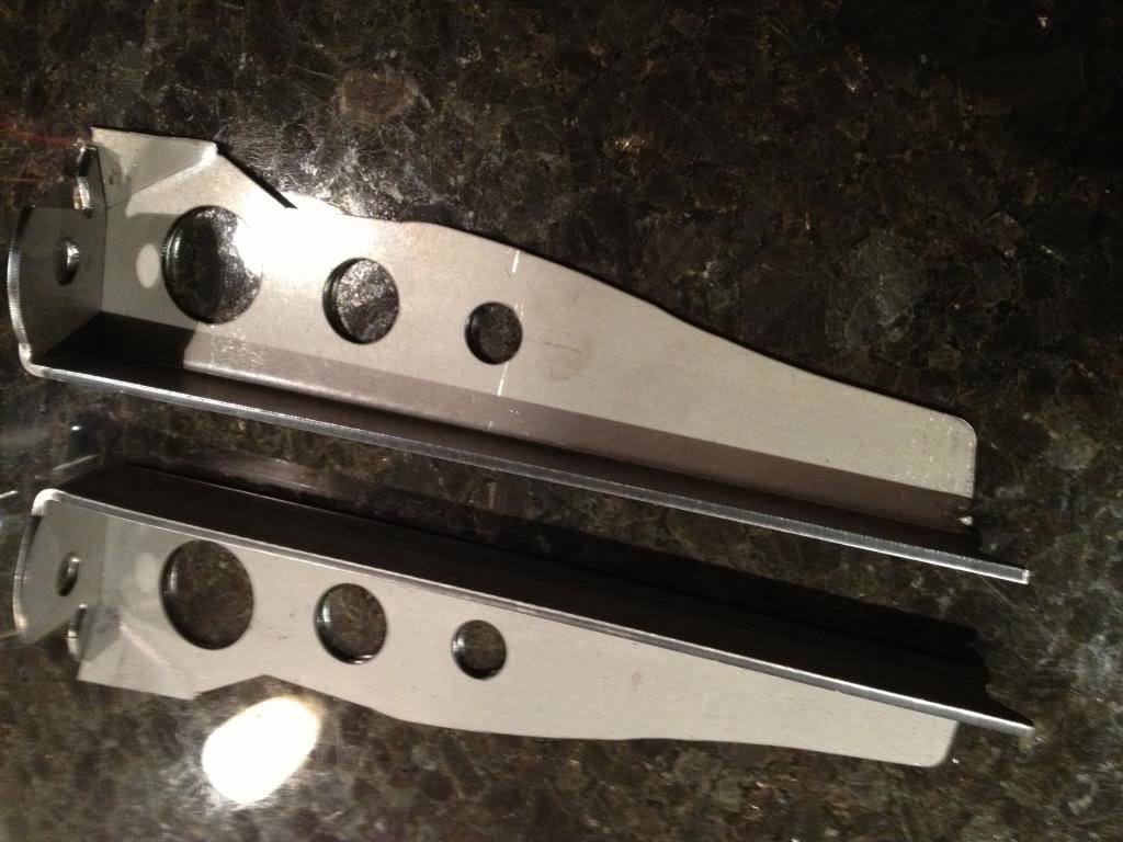

    I got these Spindle Gussets with my AP LT kit
    I was and currently am running the 2" Kit with a Pro Comp diff Drop lift.....I didnt need to use the gussets because I have the larger spindles installed from the diff drop kit. I actually expected that I wouldnt have any issues with these two working together....the 2' and the DD. Anyhow the angles because of the larger spindles and the actual drop brackets are way out to lunch....well its just barely streetable and shredding through my MTZ's with it "aligned"
    So the new plan is...... I have sourced out the piece of crossmember I need to replace the one that was cut out for the Diff drop. I actually have two different size chunks. One will get sized right and welded backinto place when we REMOVE the diff drop.
    I have also found some 2012 spindles thanks to a good friend
    I recently ordered a set of the TC spindle gussets and have another good buddy doing some welding this week for me to glue them together :)
    So this week I should have the new spindles with gussets ready to go. Hoping to maybe line up a few of the bro's for next weekend and remove the diff drop crap all together and replace missing chunk of cross memeber, then install factory spindles and get it all set up again.
