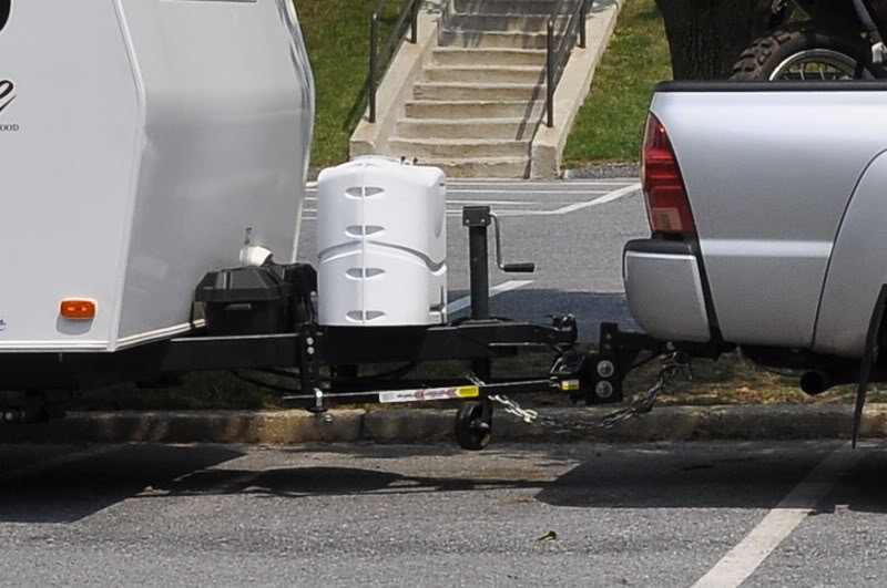

    *IMPORTANT NOTE: THE WD BARS SHOULD ALWAY BE PARALLEL WITH THE TRAILER FRAME. THEY SHOULD NOT BE PULLED UP TIGHT OR HANGING LOOSE.

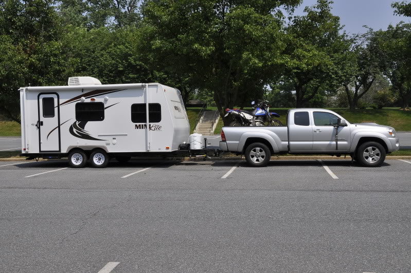

    Here is a pic of my rig loaded with the bike on the bed.The bike created 1" and the trailer 1" for a total of 2" rear sag and the front had 1" of rise. before the WD was hooked up. After WD adjsutment, 1/2"front rise, 1.5" rear sag on truck. The trailer is higher by 1/2" in the front. All with in specs It handle great!
    close up of the equalizer WD. Notice the parallel bars and tilted head

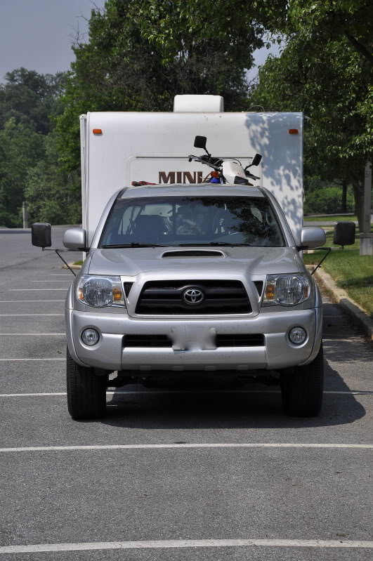

    Front view just for the hell of it. I'm using Mekesh mirrors
    I do have the spring TSB on my truck and I think if I did not it would not handle the load as well.

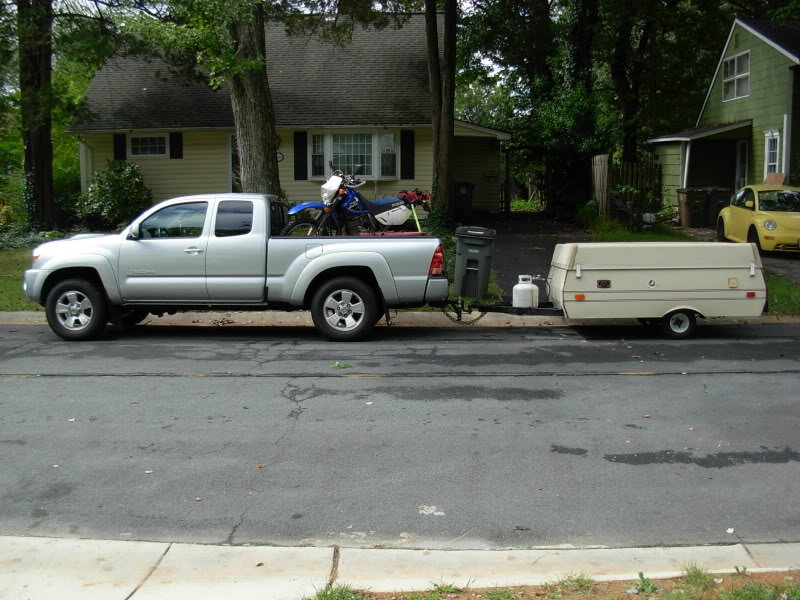

    Here is a picture of my previous rig w/o the TSB and you can see the sag in the truck
    The trailer is level though,
