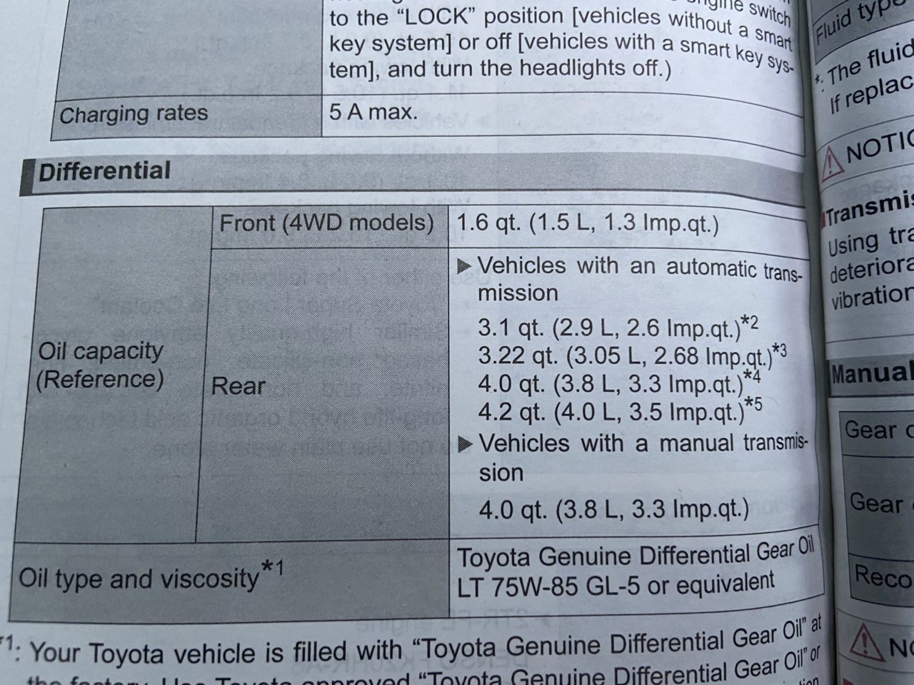

    A few questions about refilling the front differential oil:
    1. Is 75W-90 the correct type of oil ? That's what the label says on the ADD module.
    2. Is the correct drain plug torque 48 lb-ft and 29 lb-ft for the fill (source) ?
    3. What is the oil amount/capacity I should be looking to pour ?

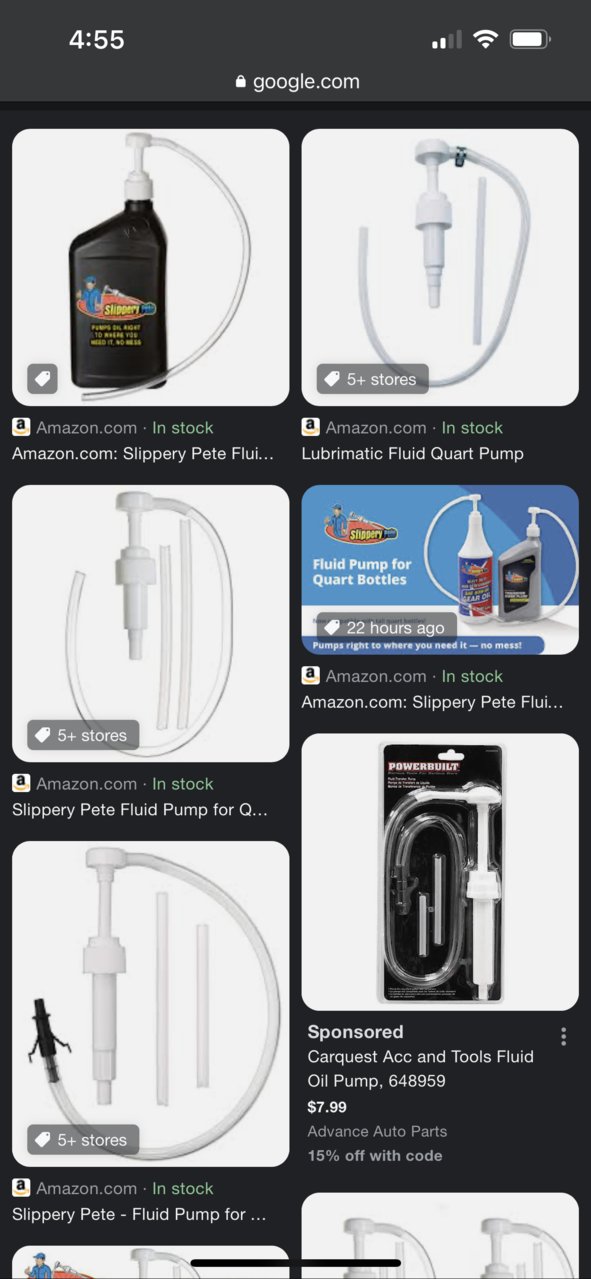

    4. The fill plug is awkwardly located. Is the best way to fill it to take a hose that will fit through the fill hole, guide it to the top of the engine under the hood, and fit it onto a funnel?

    Most common way is to use a pump that screws onto the oil and you hand pump it on.

    pretty sure manual calls for 85 but its okay to use 90, very little difference. my drains and fills are an allen key plug. never torqued them with a tool just by hand and its never been a problem. manual tells you the capacity. pump is best way to fill it i have found, make sure you are on level ground too. hope that helps somewhat. I actaully just got some Red Line 75w85 for my transfer case and fromt diff today!

    for future reference this is what it says in my manual for 2018 sr5 4x4. calls for 75w85.

    Another way to pump….
    I buy the valvoline gear oil that comes in bags. Easy to fit it up there and squeeze it out.
    Just an option.
