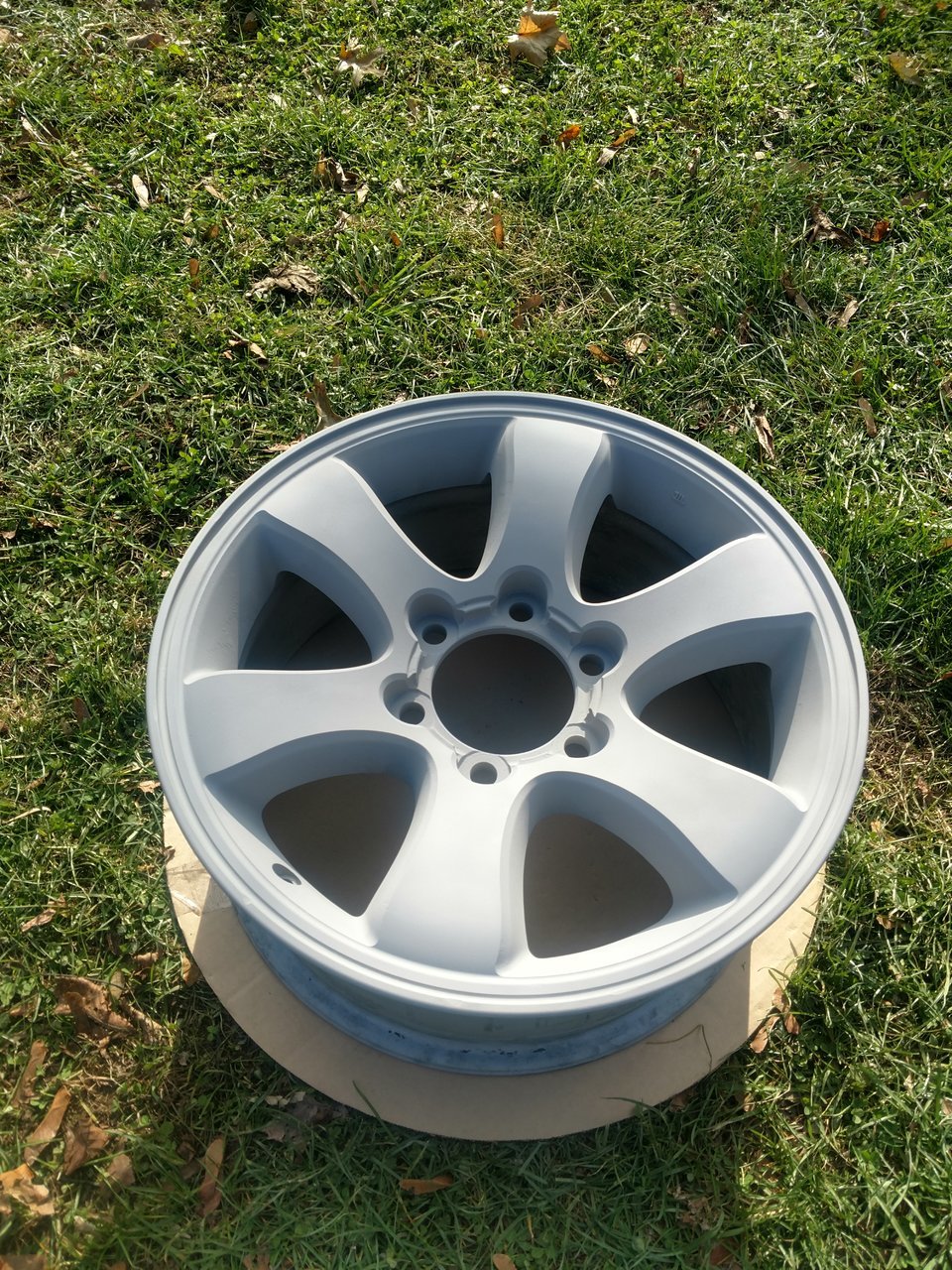

    Ready for primer:
    I had this primer lying around from a different project. Good enough. I did 2 coats.

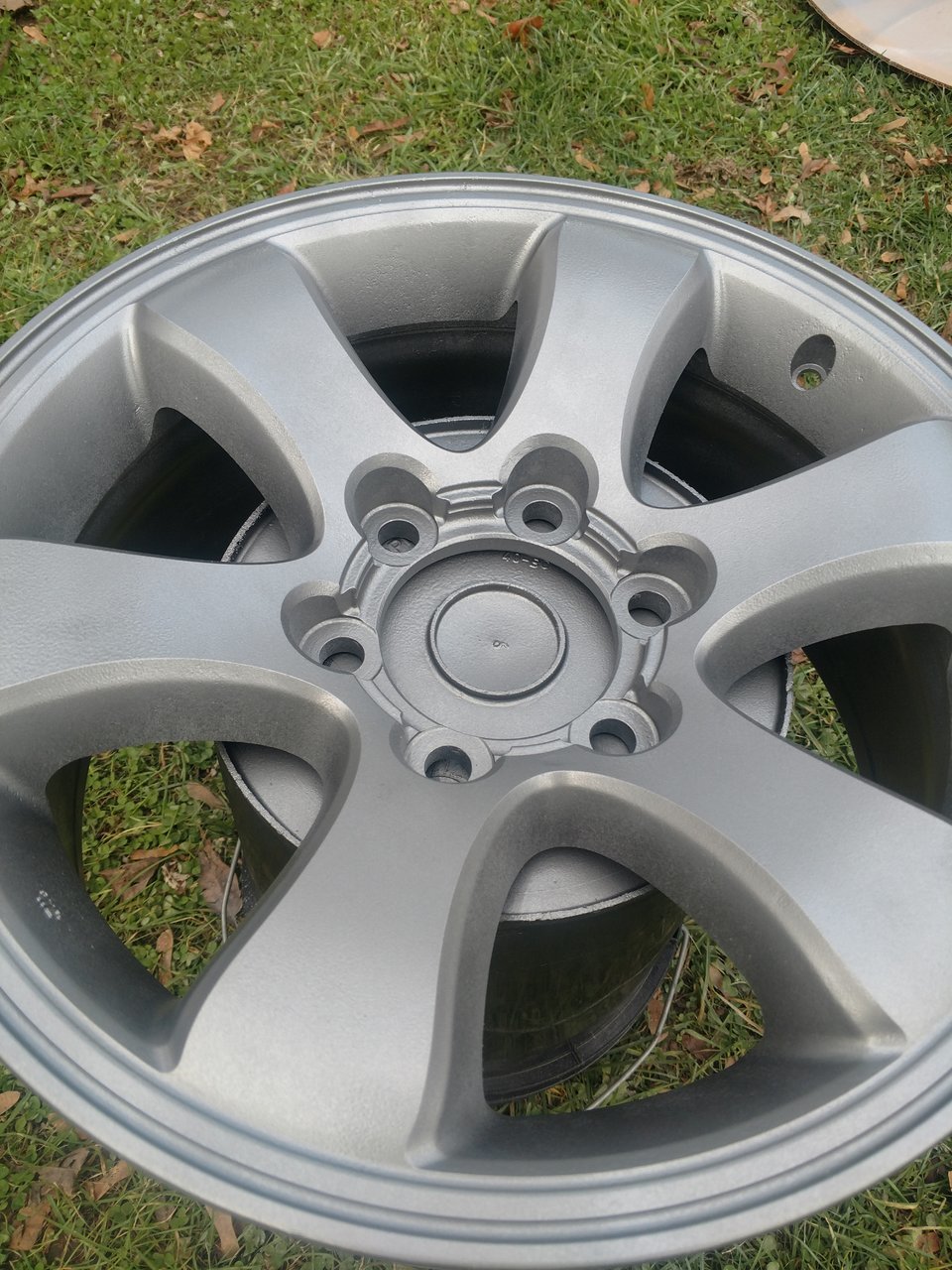

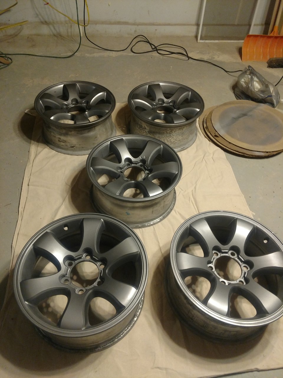

    Had some civic rims redone, they were stripped, inserts painted black, aluminum finish buffed, and a ton of clear coat.

    I just did mine with some rattle can auto primer and Rust-Oleum hammered finish after my buddy blasted them. Granted they are only for snow tires, but here's hoping they hold up decent.
