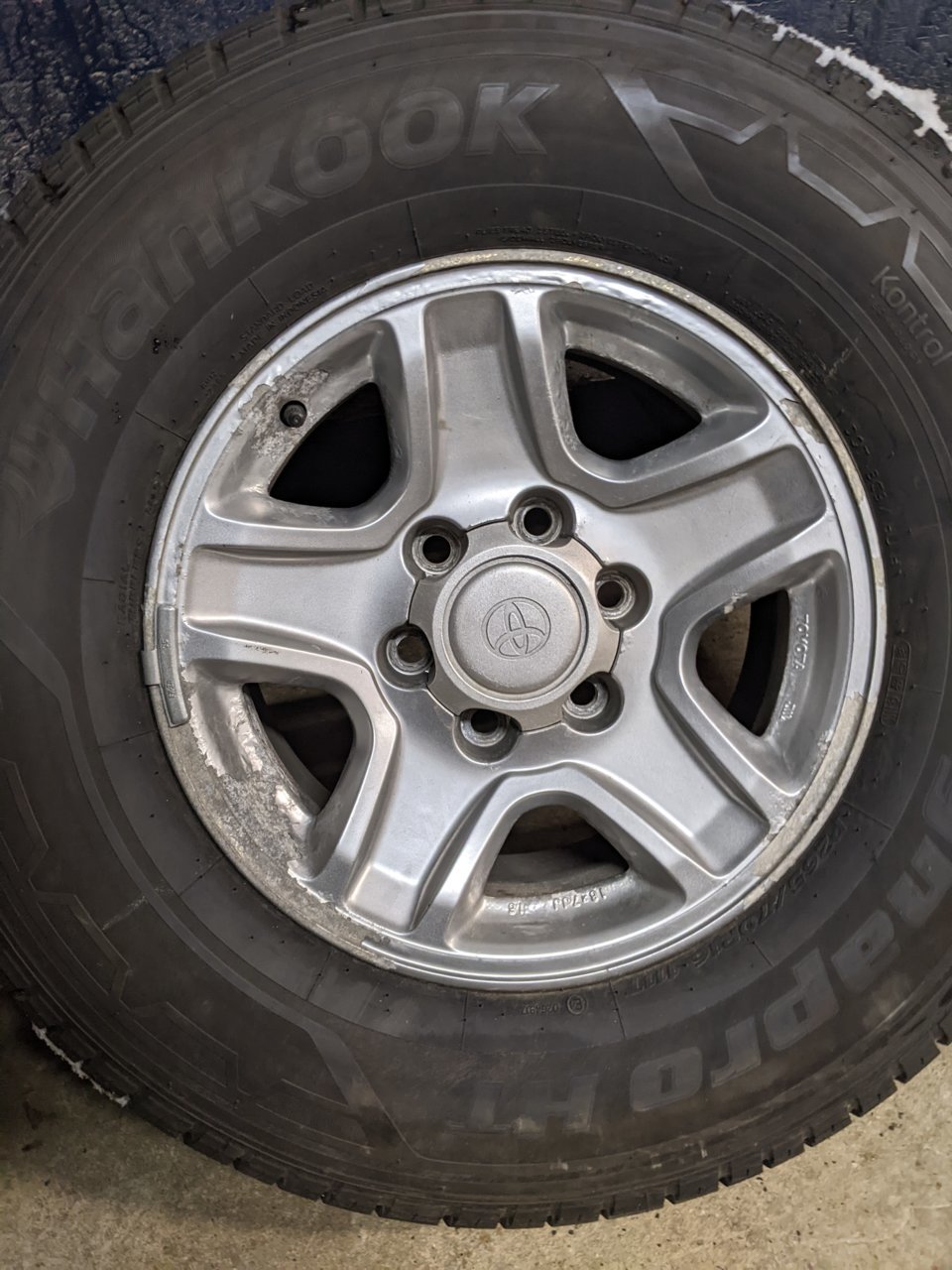

    Looking for some input on how to go about resurfacing these rims. I have corrosion that caused paint chipping. No scratches or curb rash though. Anyone know of a good method for clearing the corrosion and leveling out the paint for a fresh coat of primer and paint? Might just take these into a shop but always try to do it myself if not too bad.

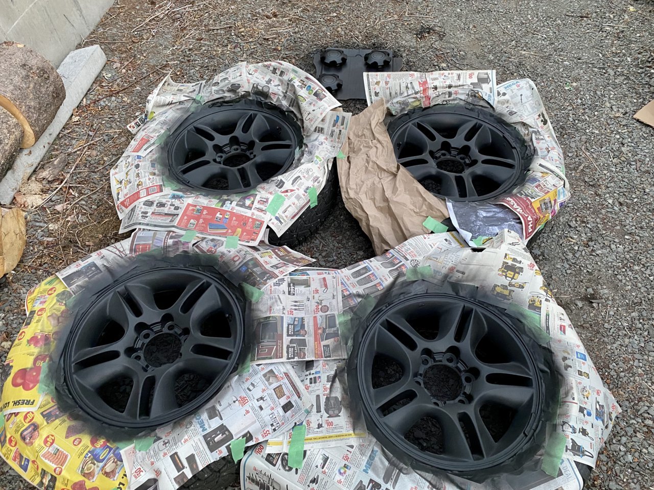

    This fall I fixed up some Lexus wheels to run on my brother-in-laws Tacoma.
    They looked like yours when we started, a bit of prep with a sanding flap wheel on a drill and a few dremel bits and we got any of the flaking finish off and cleaned up the corrosion.
    Sanding those spots clean and then a few coats of primer and wheel paint and they are good for snow duty;

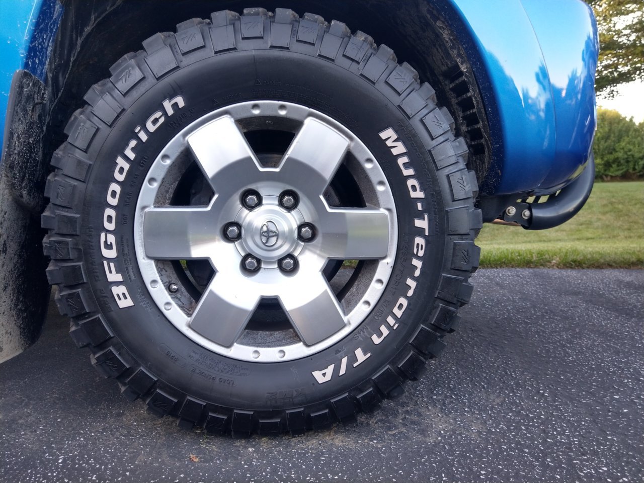

    I had my FJ wheels "remanufactured" by AWRS a few years ago and the results were great. All I did was drop off my truck and pick it up 2 days later. The price they quoted included everything to get the job done, including minor repairs. You can also choose from hundreds of colors. I choose black, so my OEM wheels look more like aftermarket. AWRS is a nationwide franichise, so there's probably one close to you. They do a lot of work for auto dealerships. 3 years ago it cost me $625 for all four, and that was with a sale price at the time. They run specials at different times of the year, so check out their website.
