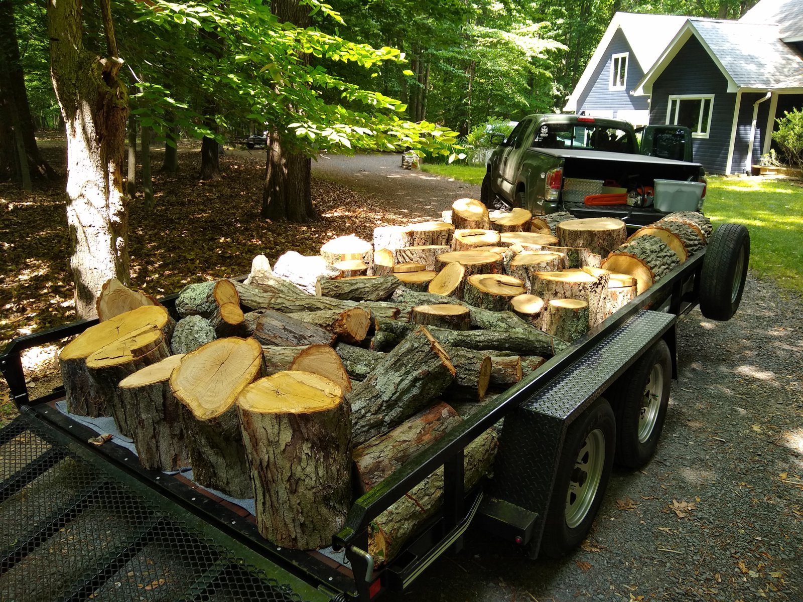

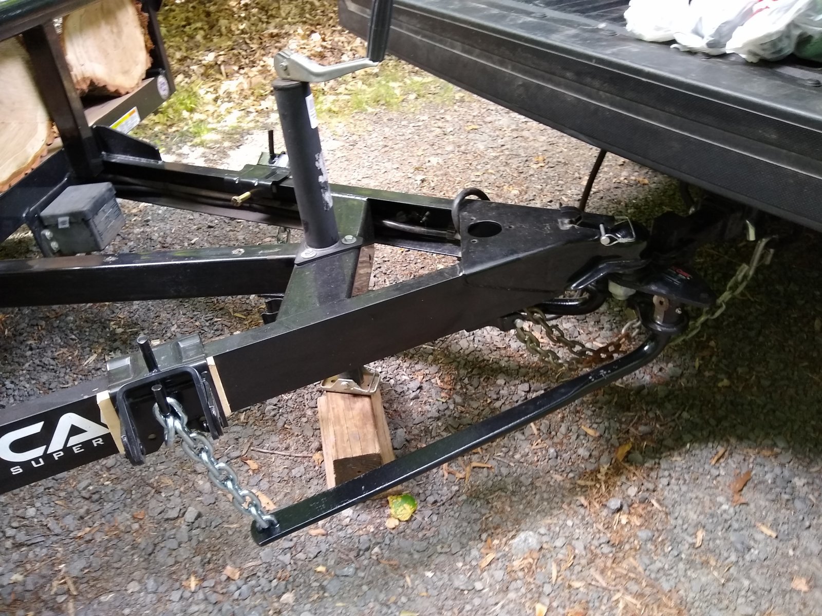

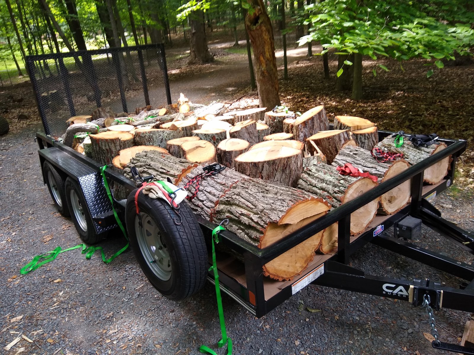

    KDmax Pro9.0 ECU tune w/ "normal" throttle, 17x8.5 Fuel wheels, 32" Falken Wildpeak AT3's, S&B CAI, tonneau cover, PCV catch can, hood deflector, clown head tow ball cover..
    I've pulled up to and dare I say a bit over rated max and haven't had any issues pulling around town and on the highway.I don't pull heavy load often so didn't want a full-size. I've got the sumosprings on the rear plus load leveling bars on the hitch. Also have an ECU tune. Anything's better then hauling oak rounds with my Acura 2-door sedan I was using prior though I guess..
