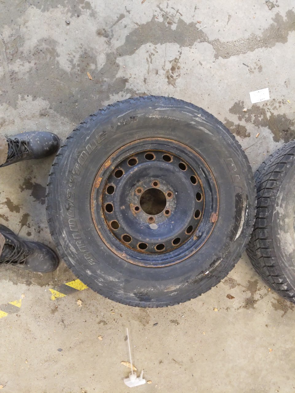

    I picked up some FJ steelies that happened to have some usable Blizzaks attached. I mostly wanted the 17s so I would have some more size options for tires down the road, but a dedicated set of winters isn't horrible to have in the frigid Northlands.

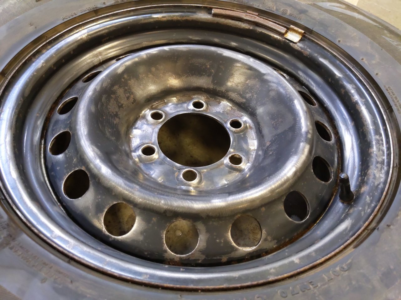

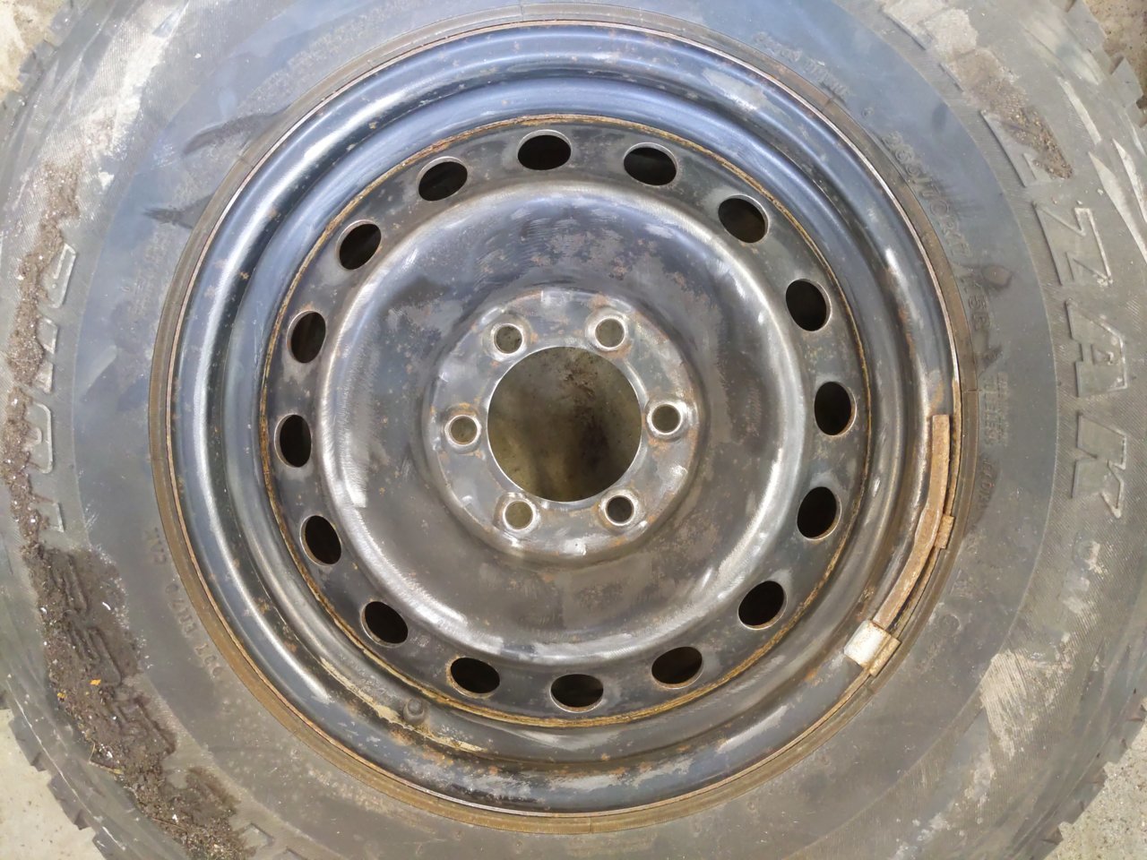

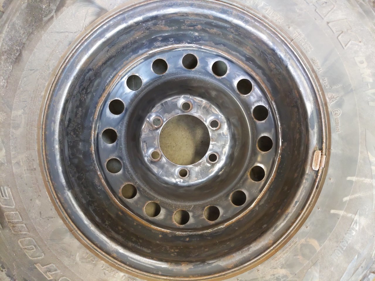

    I went after them with a wire wheel to get the big crud off:

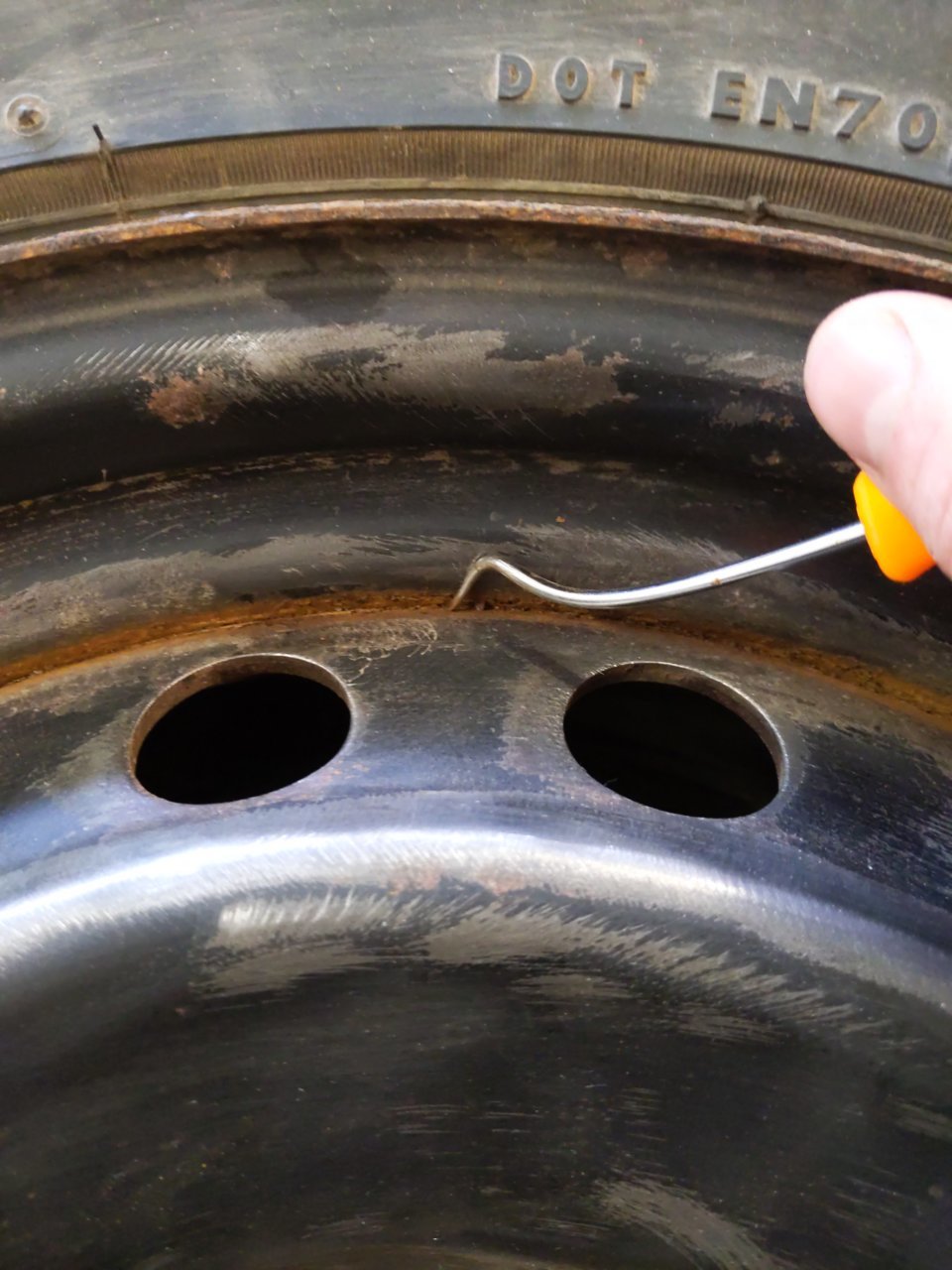

    And in the exterior seam, I used a shitty old o-ring pick to dig out as much crap as possible:
    If these were rare, valuable, or important steelies (or if I was having a particularly detail oriented day) I could have folded a piece of sandpaper and got farther into the groove. But I didn't.
    I did, however, grab a small wire toothbrush and get after the worst rust bubbles around the valve stems and in some other areas my wire wheel and wire cup wouldn't reach.

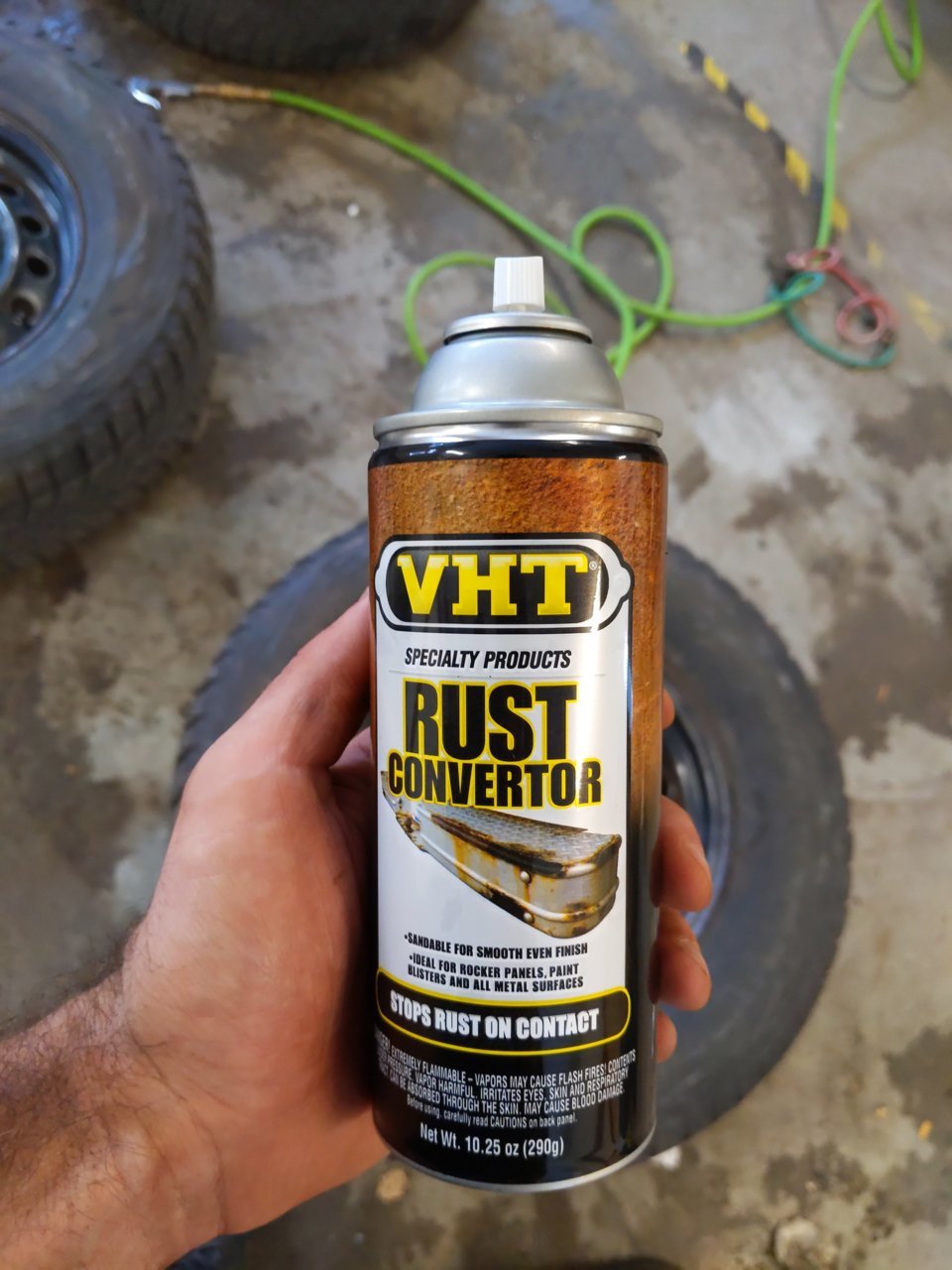

    After a rinse and degrease, they looked about as rust free as I was willing to put any more time into, so I dried them off real thorough-like with compressed air, and applied my favorite magic in a can:
    It got down pretty good into the seam and the areas I couldn't reach with the wire wheel. Two coats per directions printed on the can did a pretty good job:
    I'm going to give it overnight per the directions on the rust converter, then prime and paint.

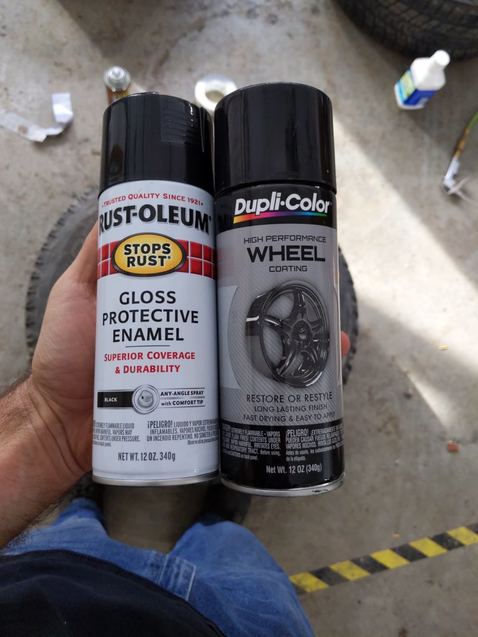

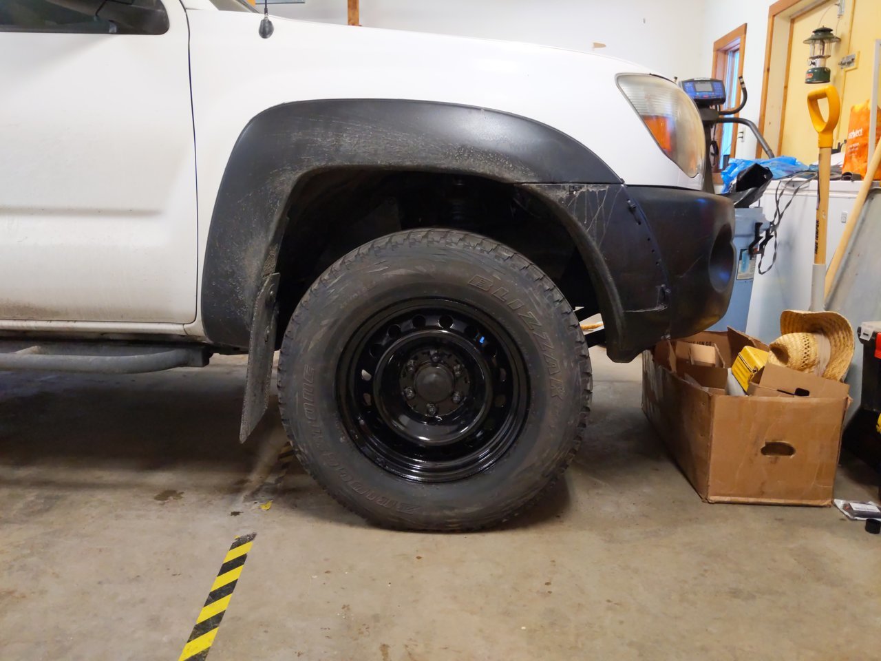

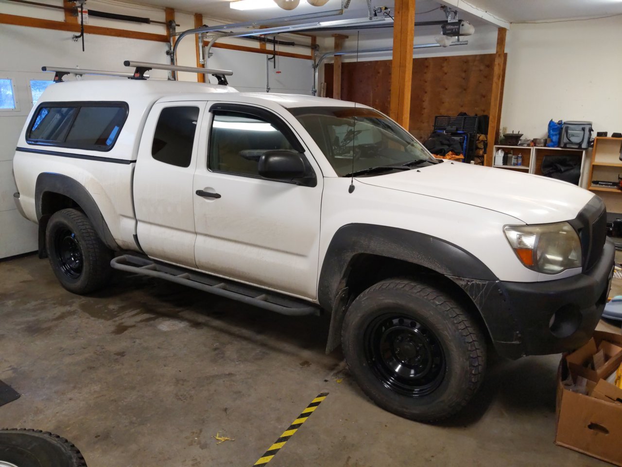

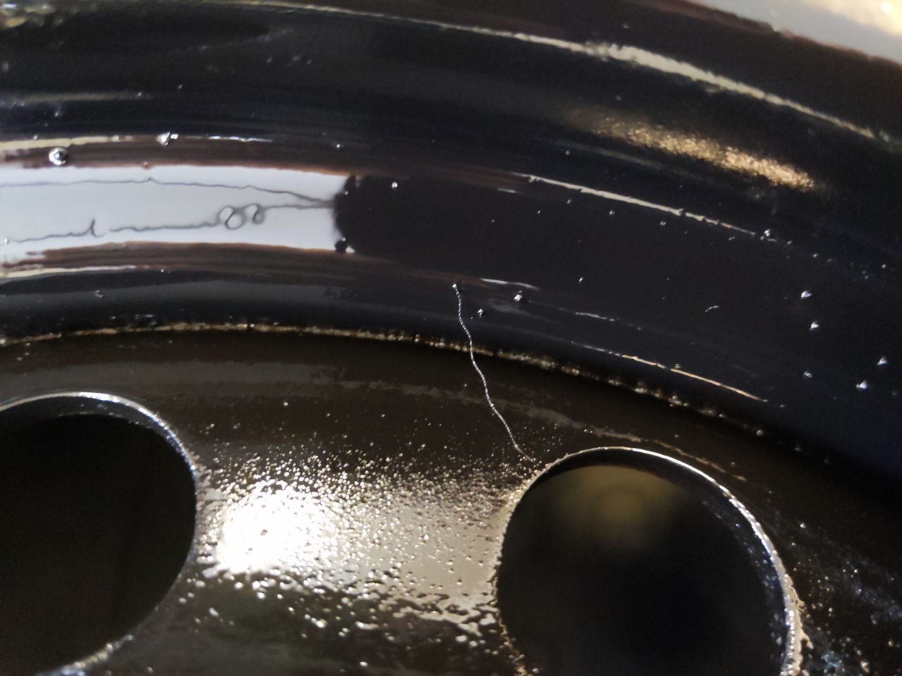

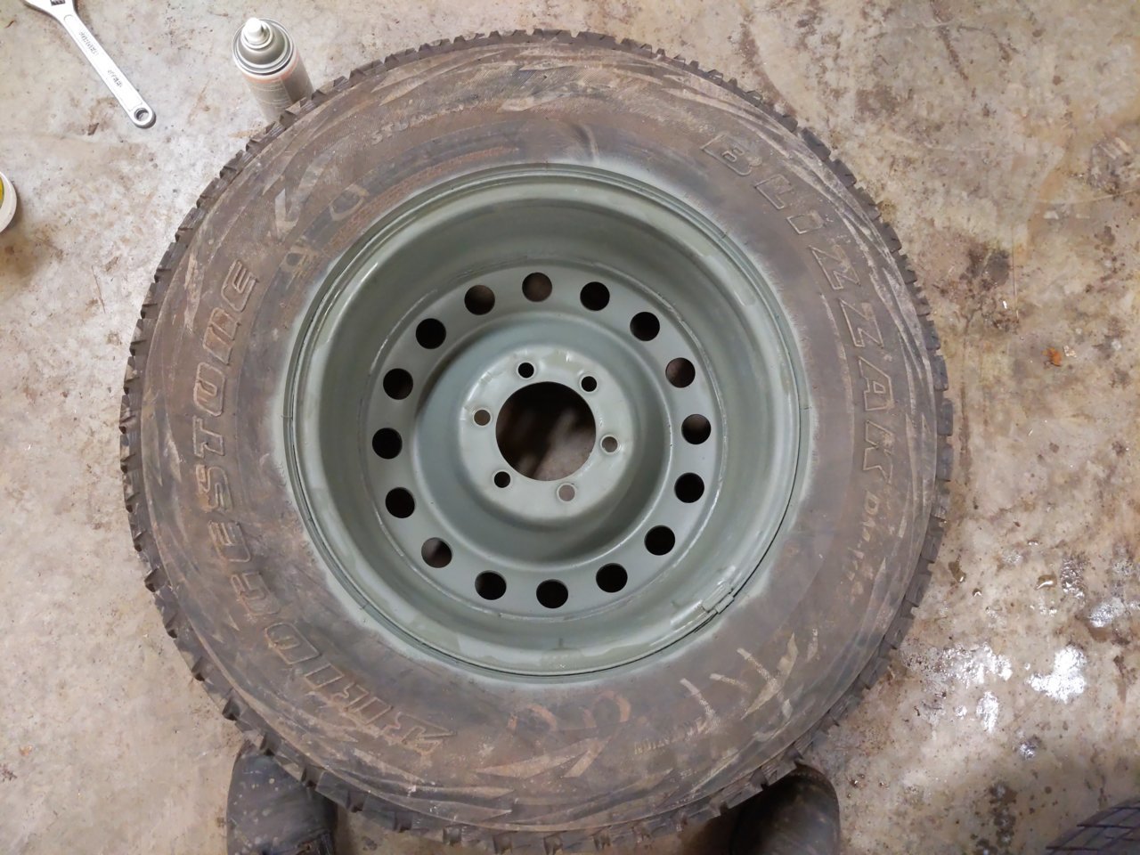

    Applied self-etching primer to the interiors. I didn't mask the tires on the insides, and you can't say anything that will make me regret it.
    I did the insides with two different paints as an experiment. One side got old trusty and always faithful Rustoleum Gloss Protective Enamel, the other got Dupli-color Wheel Coating. Both interiors got two coats according to the directions on the respective cans, and I marked the Dupli-colors with white dots so when my dumb ass forgets which is which, I can look here and remember.
    Dog hair everywhere. 24/7. He has hair on continents he's never been to.

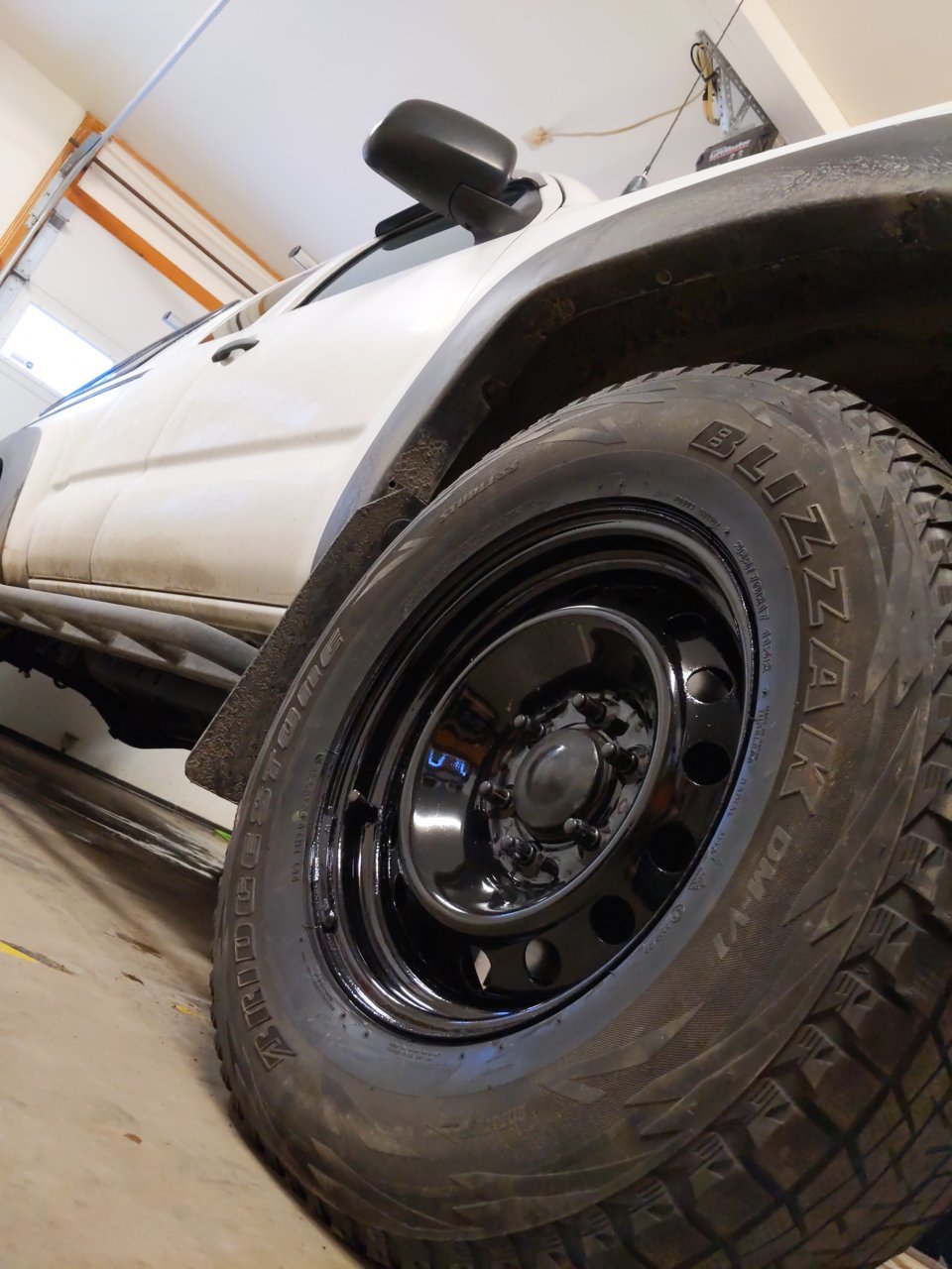

    Three coats of Rustoleum Gloss Protective Enamel on the outsides, which I did mask. Here's the money shots:
    They will never, ever be this clean again.
