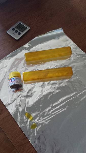

    I bought thses lights a year ago and they worked well, but were sealed like crap so water got into them and the lenses became discolored. So I decided to open them up, clean them up and give them an amber tint for when the snow season comes.
    Final product.
    Method:

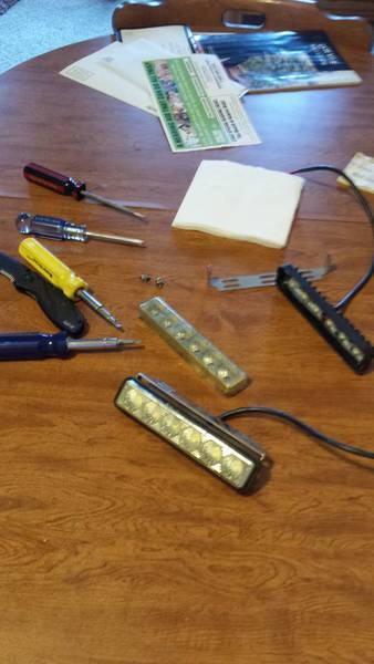

    The lenses poped off with a screwdriver.

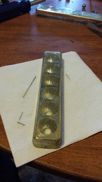

    crap and discoloration
    I then cleaned the lenses, sanded them a lot, wet sanded and added a few coats of this paint.
    sanded more and more with HIGH grit. and sprayed a few layers of clear on.
    Finally got them wired up and they seem to have a lot of yellow output.

    Yeah it was an easy task.
    When I opened them up it seemed like the glue they used was a hard epoxy that dried out and cracked and eventually let the water in. So when I resealed them I used a softer silicone that should seal them up for the long haul.
