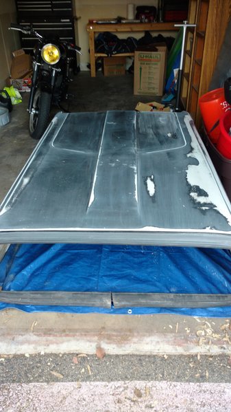

    I picked up an old camper shell for my 2000 reg cab taco a few months back for 150$. It's old, paint sucks, door is iffy/plexiglass is just flimsy. But it was cheap and fit pretty good. Also it is structurally very sturdy. I liked this one because it has no side windows or access so it's good for stashing my surf gear and nobody can see what's inside.
    Today I decided to start the refurbishing process, I'm going to post here for anyone who cares, or would like give me any tips/input.
    1) replace paint, probably a matte black, haven't decided
    2) somehow make door more sturdy, maybe replace plexiglass with diamond plate, also needs new shocks, hinge system is also pretty crappy
    3) might go by a local camper dealer to see if they can replace the old boot?? Pretty old and dry
    4) considering carpeting the inner roof, my buddy does commercial carpeting and flooring so I would ask him if its up his alley.
    5) roof rack probably Yakima style cross bars for less light weight, would only be used for surf trips
    6) create a carpet kit/subfloor storage system, probably out of mostly 2x4's. Goal would be to have storage under the floor, but also strong enough to sleep on top for camping and stuffIMG_20160509_180151592.jpg IMG_20160509_191138008.jpg IMG_20160414_144019312.jpg
    Okay that's the before, and after some sanding. Will update as often as possible
