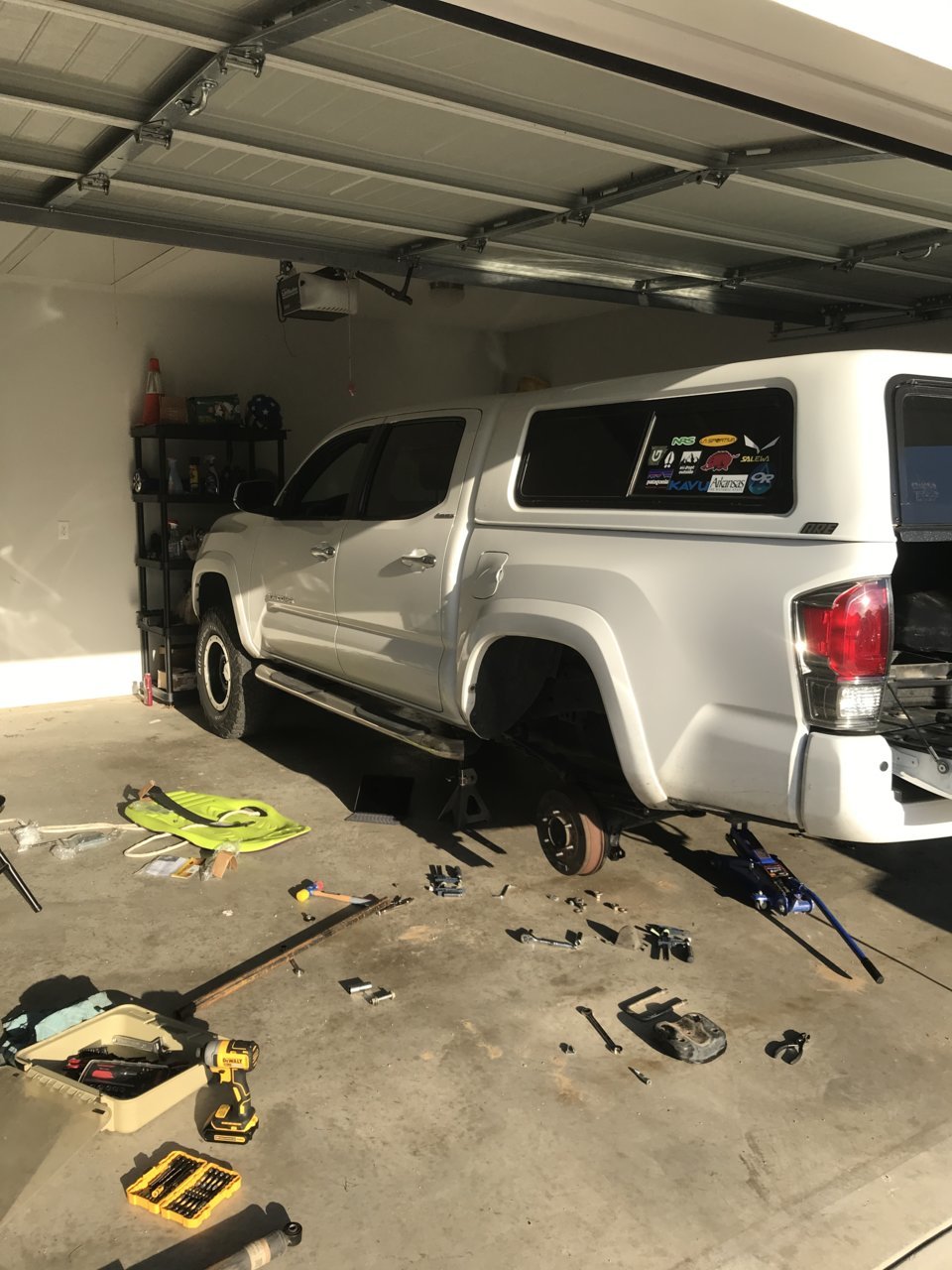

    83A43554-E6BB-4E97-BFBE-BD1B4F831A33.jpg Heres how things are going here. Honestly not too hard. The bolts that came with the aal are ridiculously long so i had to go buy an angle grinder so i could get the bump stop back on
    Orco59 likes this.

    Yes retain the overload spring if you use the bed, even more important with a shell. Without overload you’ll wear out the springs quicker and will loose the progressive-ness of the leaf.

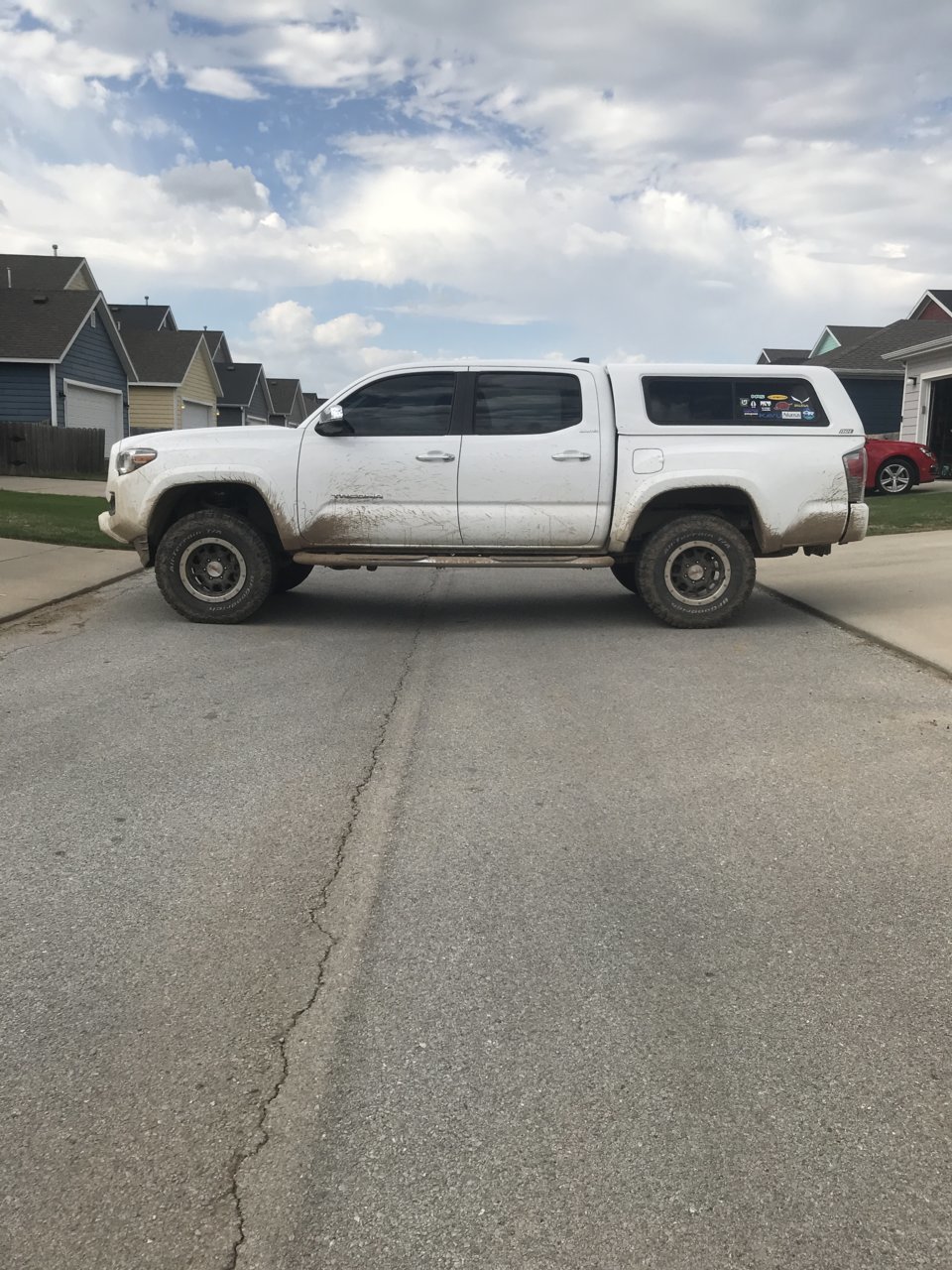

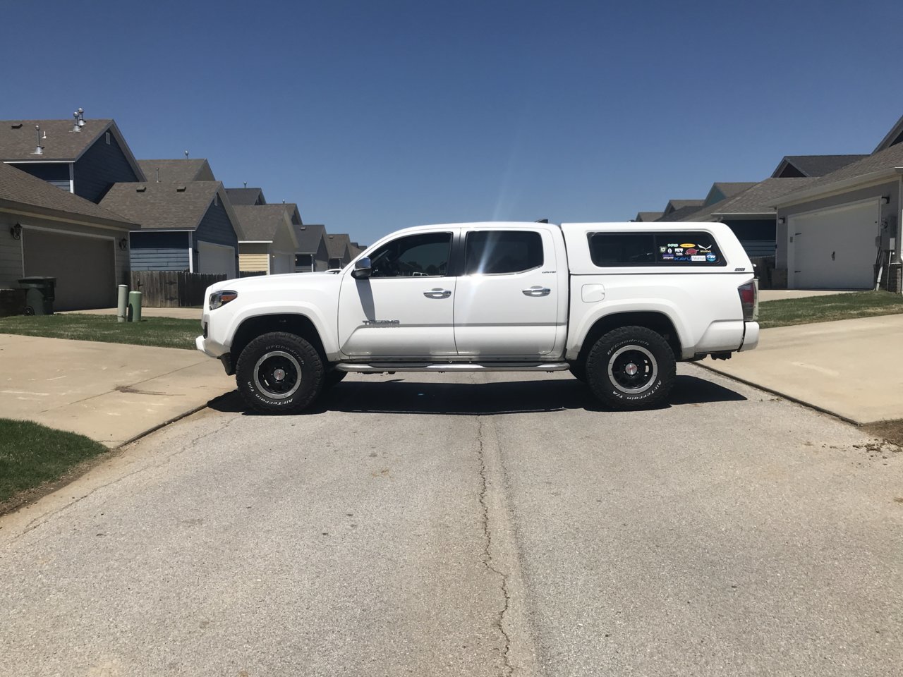

    Here is a before and after pic
    Before:8A207F69-70C3-4FE6-A5E4-21B97C7C514C.jpgAfter:BAEAD155-AA29-4038-83B2-E06F619EF3B6.jpg

    Clean vs dirty :)
    Does it seem to drive or feel different? Better? Worse?

    As soon as the lift went on, I took it to an offroad park up here in Arkansas. It really doesn’t feel all that different. It stiffened up the rear enough to account for the weight so it rides pretty close to stock if not a little better in my opinion.
