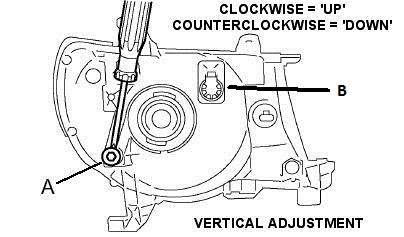

    Hope this helps
    "B" is horizontal adjustment which you "shouldn't" have to mess with.

    It's plug and play, and not hard to adjust at all. The only thing you're adjusting is the beam of the headlight. With the diagram above, it's real easy with the twist of a screwdriver

    Honestly I didn't even need to use a screwdriver when I re-installed them after the BHLM. The adjustment wheel is big enough to use your fingers.
