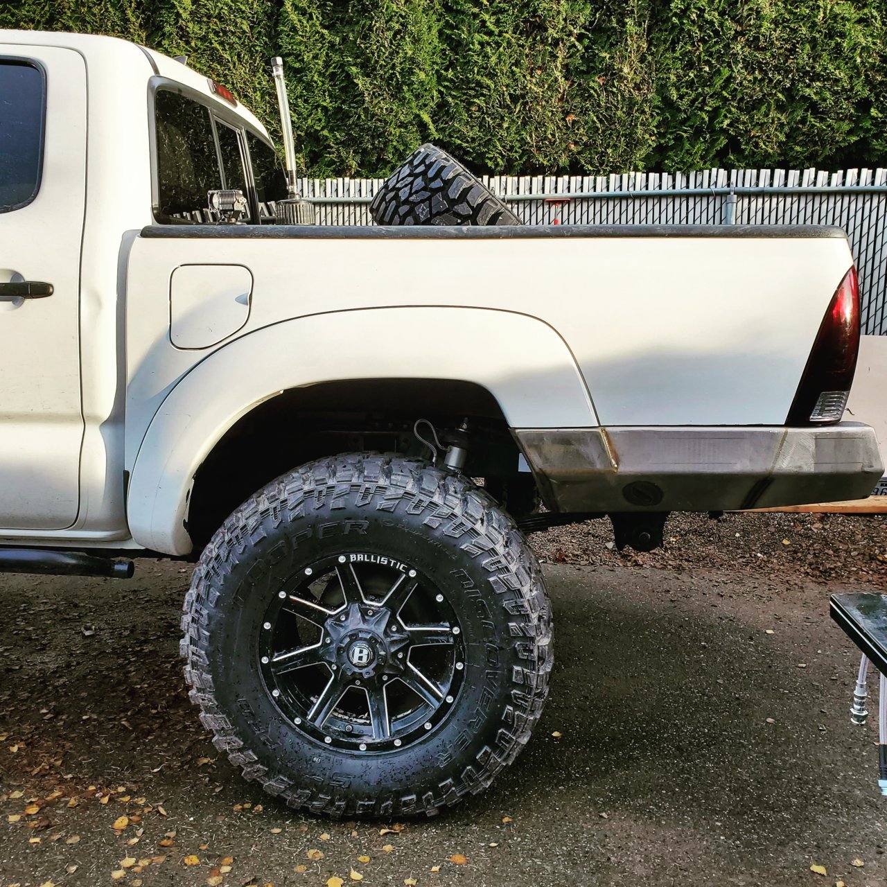

    I'm headed for a regear and I am looking for input on whats best for me. I am currently on 35s with a 3" lift. 4:88 or 5:29 its a daily with every weekend spent trail riding and crawling. Front and rear bumper along with sliders not sure if the weight plays a roll in decision. Automatic Transmission, thank you.

    4.88 if it’s a AT or 4.56 MT. Does not the same issue as a 3rd gen.
    i have a AT w/ 4.56 315’a and heavy as hell and wish I had 4.88 but did 4.56 when I had 285’s and it was perfect. if you want more offroad less highway go 4.88/5.29 but you’ll be screaming on the freeway.
    Also weight def does. If I knew how heavy my truck was I would have gone 4.88 for sure. I doubt 5.29. Your truck does not look heavy.

    I'm an AT on 35s and a lot of weight, probably a little lighter than @nudavinci64 though with no RTT or swing out, but I got steel bumpers, sliders, bamf hangers, all steel skids (BAMF trio, LCAs, and rear diff, plus Pelfrey gas tank), etc.... I'm on 35s and it is my daily. I'm happy with 4.88s day to day. Of course, when wheeling, 5.29s would be nice, but it is my daily and a not trail only truck. As he pointed out you seem lighter, and even if you plan on adding weight, you stated it is your daily. Especially if you commute, don't stay only in town, and your wheeling spots are not necessarily close, I'd probably go 4.88s over 5.29 if I were you. Most people (2nd gens) I know went 4.88s on 35s with AT.

    This is what I wanted to hear, im adding a front locker while I have the chance. 4:88 also seems like a happy medium to me. My front and rear bumpers are in powder now and of course under armor will follow shortly. Appreciate the response.

    But agree with you. If I knew I was going to go up to the 35's range I would have done 4.88 hands down but at 285/33's 4.56 is a good play. If you even remotely think you will be going bigger then go for 4.88. 5.29 would be a weekend crawl rig then a daily on the 2nd gens in any version (unless you running 37+). My rec/vote is still 4.88 based on your setup (even 4.56 would not be bad since you are not armored up and would be closer to stock gearing.
