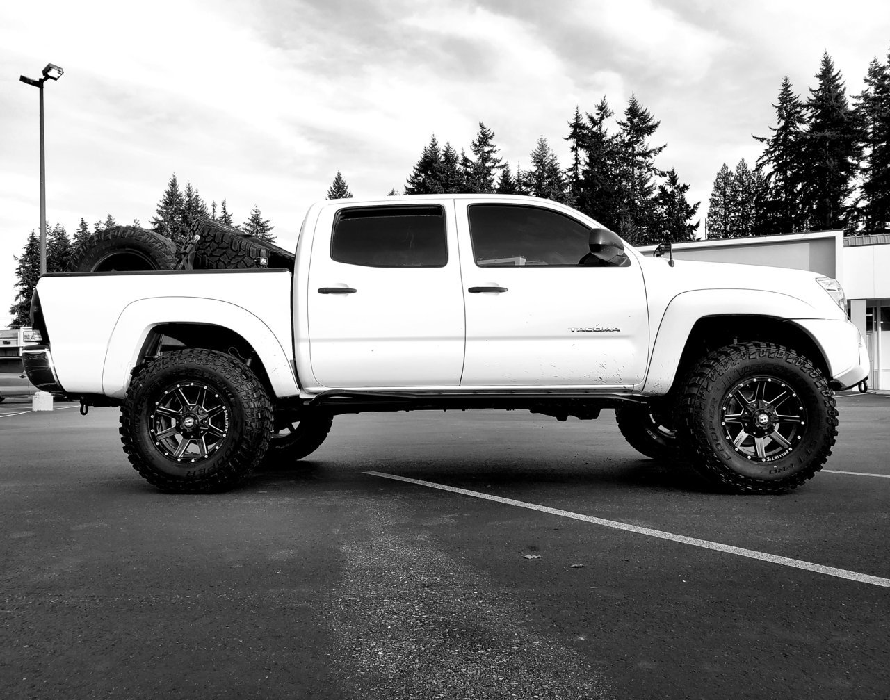

    4.88s for sure. Just went 4.88s with 35s and I’m super glad I did. I think 4.56 would be better for a daily with little weight added

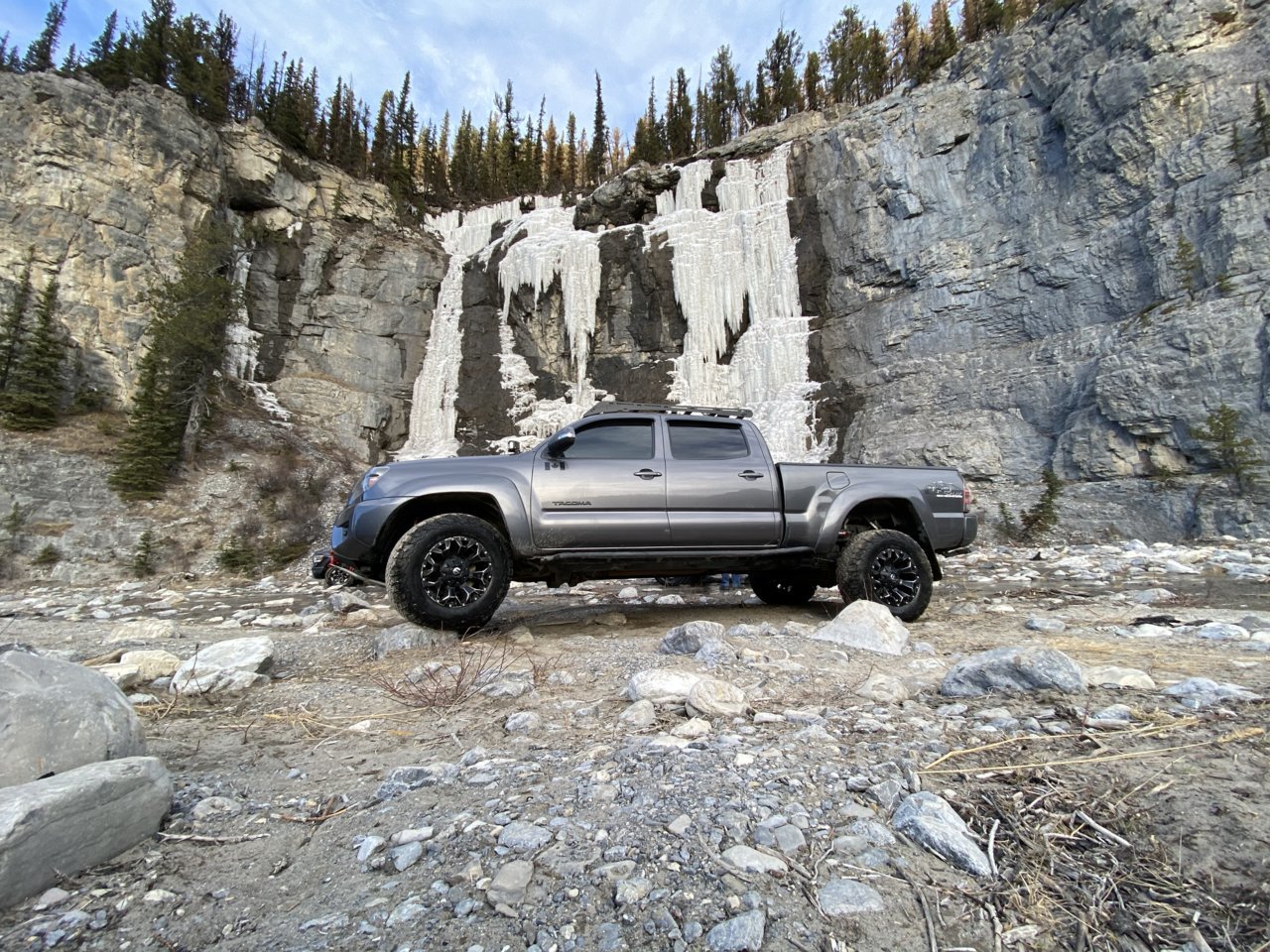

    SCS ray 10s. 315/75/16 Yokohama G003. Elka 2.5 dc w/remote resi. SPC uppers. Dobinson heavy leafs. Timbren bumps. Spindle gussets. Cab mount relocate. TRD catback. Toyota trifold tonneau. Full spare in bed. Hood deflector, side visors. Danger Customs Front/rear high clearance bumpers and full skids. 2 way remote start. Safari snorkel. Front 30% tint. Bed step. Anzo LED head lights. Weather tech mats. AllPro HD sliders linexed. 10k smitty x20 synthetic. Factor55 flatlink. Linexed bushwhackers. Rigid industries bumper pods. Ridged industries DSS ditch lights. Diode Dynamics amber pods. Prinsu roof rack. 42” Caliraised Amber single row. Switch Pros in sunglass holder. Custom Bed rail mounts for recovery gear.Northstar AGM battery. 4.88 nitro gears. Front and rear ARB lockers. ARB air compressor in bed cubby using expedition essentials mount.
    I have 4.88s on 32” tires currently waiting on 35s.
    Regeared and added front/rear air lockers.
    Some extra weight. No rtt or canopy.
    Hwy driving 110km/h rpms @ 3000k
    That’s on the 32s
