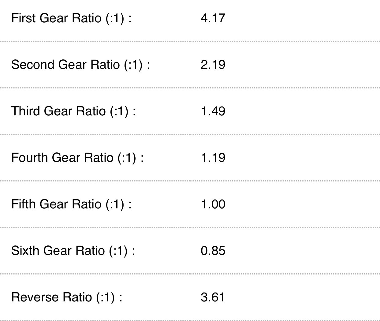

    Hey Baggett, what size tires did you start with, what will it take to get you back to where you started? & Bannerman, if I read your post right, the 6 spd manual 4 is OD that means 5th, & 6th are taller & taller. I never knew any trans where 1/2 the gears were OD.

    I’m wrong.

    After reading thru this stuff again, I think maybe some are talking driving in OD & others are talking driving in 5, as recommended for towing trailers. Just say'in you'll run appx. 800 rpm. higher in 5 than OD (6).

    2nd gen/2013 automatics don't have a 6th gear. Only 3rd gen automatics have 6th.

    Thanks for all the help! And to think I was getting quotes on 5.29 gears. That would have been so wrong if I installed those on my 2013 since it doesn't have 6th gear.
