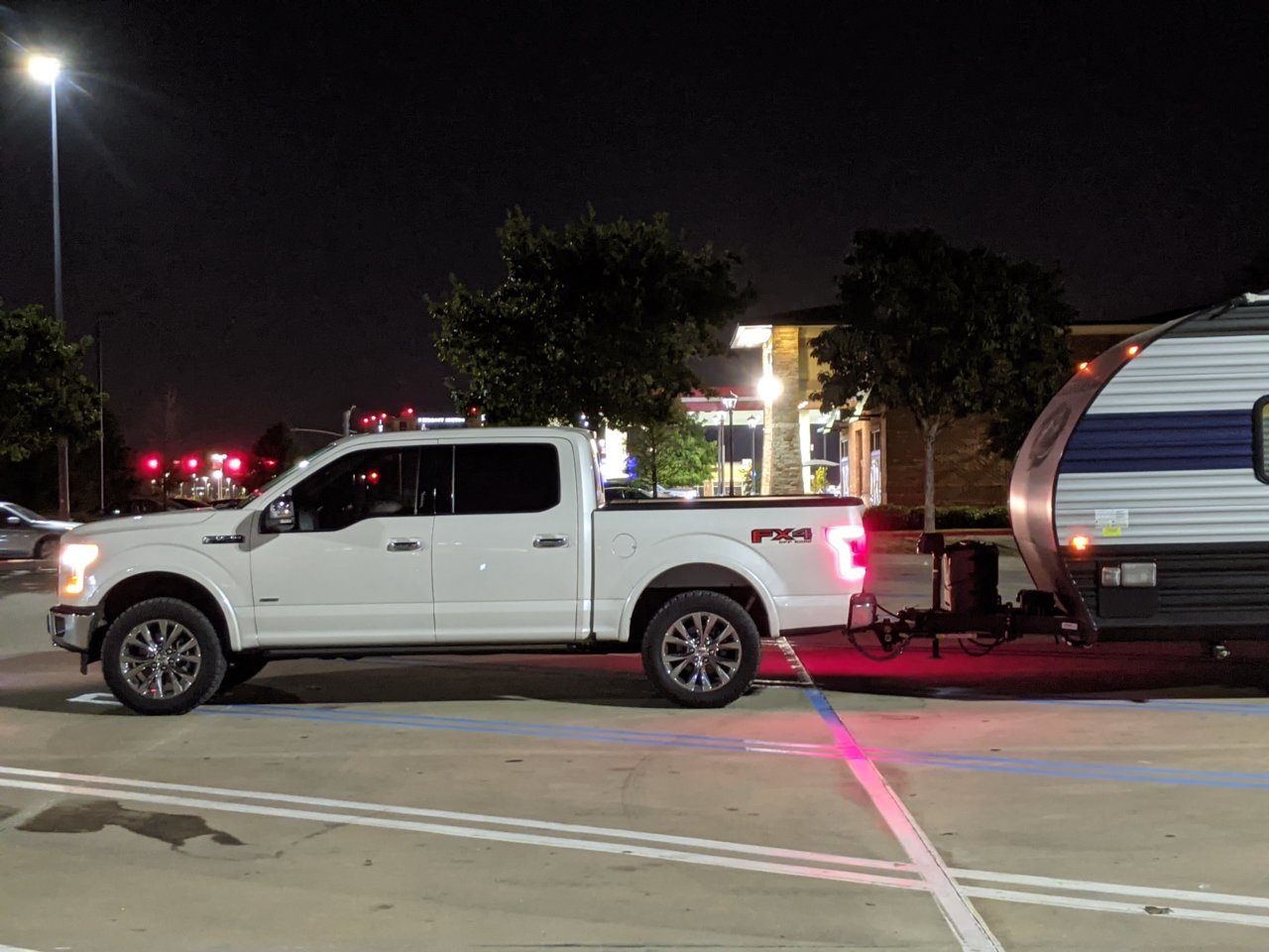

    Yes, I sold it - my Taco let me down at the end. Given my needs, best decision of my life as much as I was a Toyota fan.

    Well, I think you made a good choice, can't go wrong with the F-150. I took a hard look at one a while back, just couldn't just get away from the pull of my Taco. Plus, I was living in the Bay Area at the time (driving around San Francisco isn't fun in a full sized truck), and I don't pull trailers very often, so the choice was easier. Not that you need my endorsement, but your welcome back to the family anytime!!!
