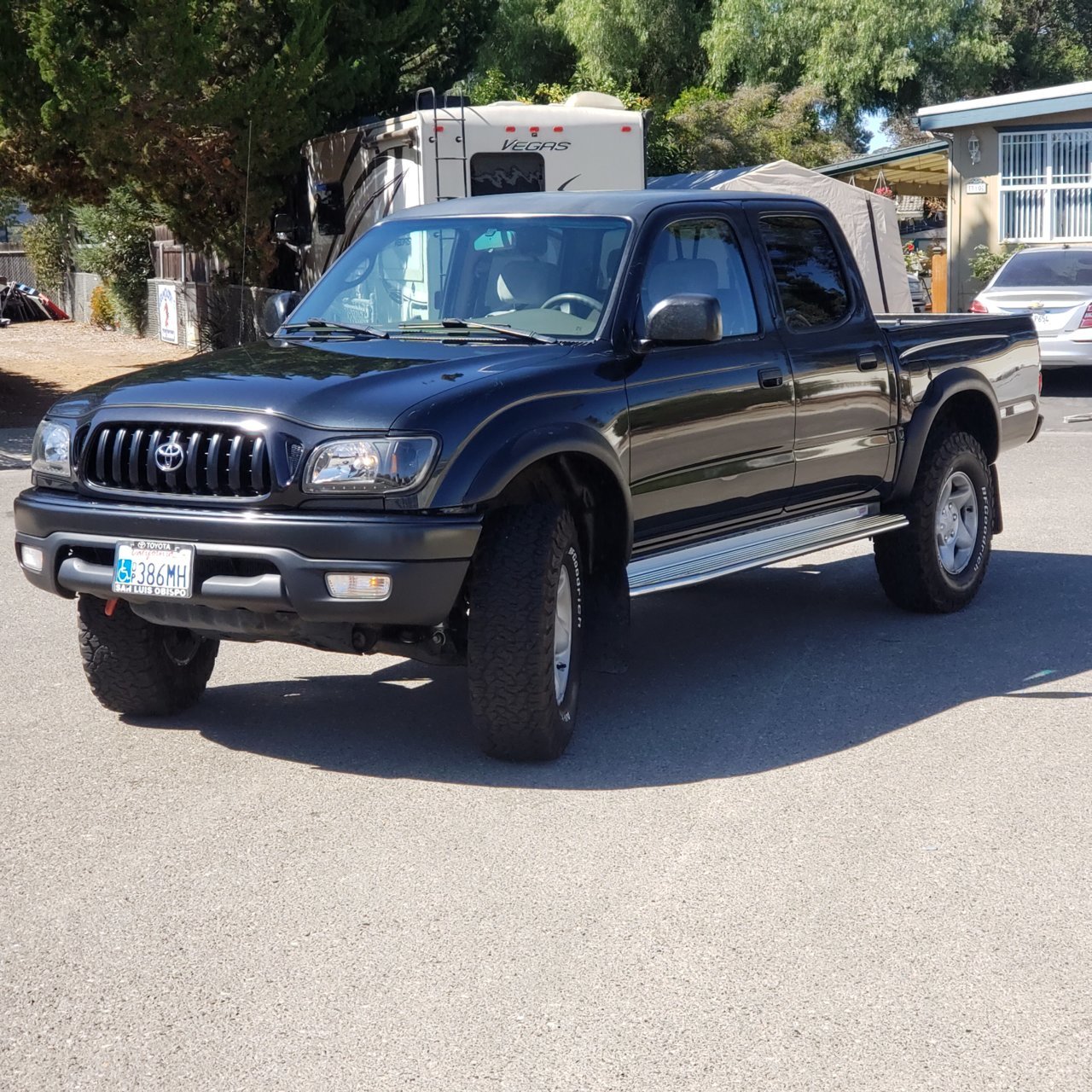

    I want to regear my 2001Toyota Tacoma tire size is 265/75r16 KO2 & suspension 5100 bilstein w/ 1" block all around 3" lift what gear should I go with 4.88 or 5.29

    4.88
    5.29 are crawler gears.

    Lol you don’t need a regear for that tire size

    Can I improve the way the truck drive with 4.88 then ?

    Yes. The responsiveness in town and out will be great. The truck will pull gears fast. Only problem u might run into is ur gonna be at like 3.5k rpms in ur top gear at 70 mph with those size wheels. U go bigger n it'll fix it
