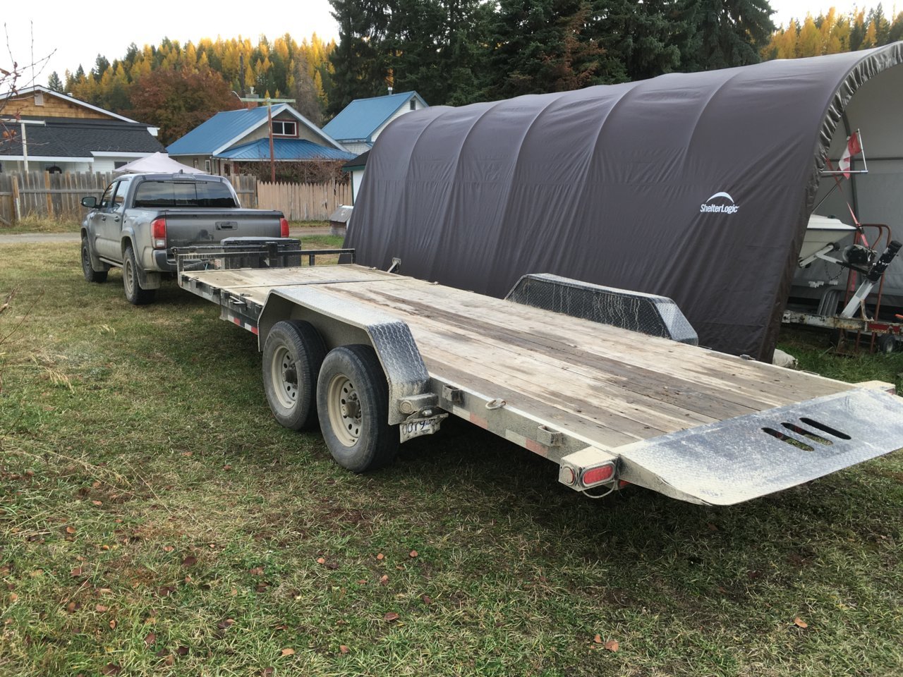

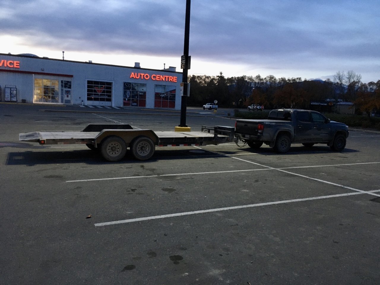

    DF588D93-BC3F-453B-A9F4-5E380056974E.jpg B46BCA06-4E43-44FD-8918-2B3845661D2B.jpg Has anyone preordered their Tacoma to have made at the factory and asked to have the diff gears changed for some other ratio? I had noticed on this one site last night looking for diff ratio specs for the 2021 tacoma pro. The site spec’d the diff @ 3.90-4.30 (optional).
    (Just realized those numbers are auto vs manual) Would still love to regear the manual one size.
    I had the pleasure of towing a 22ft double axel flat deck with a weight of 4000lbs and added 1000lbs of material to haul from Cranbrook BC to Wasa and I rarely took it out of 4th gear to maintain 100kms/hour on the highway. It did the haul but it wasn’t happy. I’d never tow the rated 6400lbs as it’s geared.
