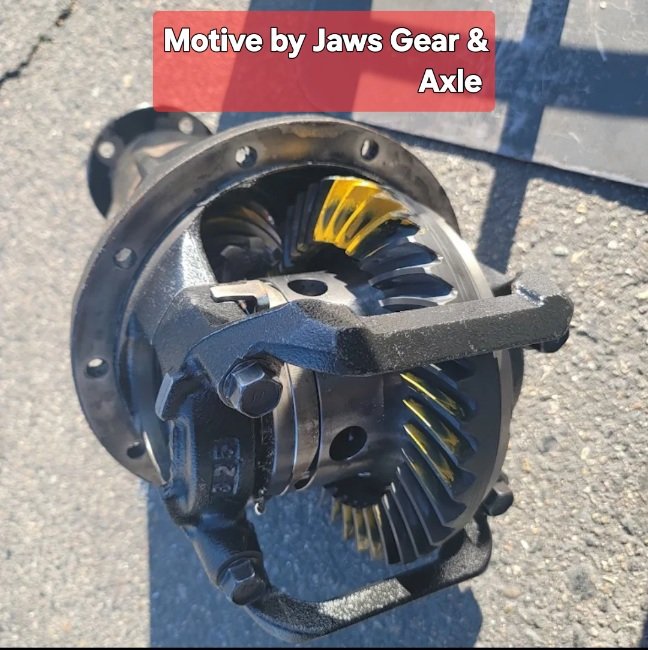

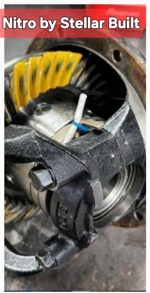

    Interesting video. This is an old thread so my decision is done but now over 2 years later I can share my experience when it comes to regearing my truck and having the gears damaged as well.
    I regeared my truck with Nitro 4.88 gears and these were installed by Stellar Built in Sacramento Ca. They were working great until I pushed it really hard. I had the rear locked and was trying to get up this hill that took many tries. Eventually got up but on the way home under certain speeds I heard a noise coming from the rear end. It was not major and I kept driving it like this for a couple months. The noise got more noticeable and irritating.
    Eventually I took it back to the people that originally installed it and he said he wasn't sure that it was the rear end and that it could be many things but for a fee they would take my rear end apart and check it. I would have to wait a couple months and so instead I took it to a place called West Coast Differential and this guy took it apart and said he did not see anything wrong but that maybe it was the pinion bearing. He replaced pinion bearing but this did not fix the noise. He was adamant that the gears were fine and so I moved on.
    I then called my local Toyota dealership and they said they would take on the task of figuring out the noise. They confirmed that 100% it was coming from the rear diff. The only thing they could do would be to replace it with stok gears so then they actually sent it to West Coast Differential only for him to tell them the same thing that he didn't think there was anything wrong.
    So at this point I decided to do some more searching and I found a place called Jaws Gear and Axle in Sacramento CA. My rear diff was already taken apart and so I just dropped it off to them. They took it on and said upon inspection we can't see anything physically wrong with it but that doesn't mean there isn't something that can't be seen with the naked eye. They told me that there was a more significant test where they were fairly confident they would be able to prove that there was something wrong with the gears. Some type of hairline crack that would cause this noise. This would cost additional money and rather than do that I had them put in new Motive ring and pinion gears.
    New gears solved the problem and the noise was gone completely. My gears were actually now even quieter than they were before all of this. I had a small whining noise. Whether that's related to any of this I don't know. There's much opinion that some gears have some type of natural wine but some of that can be reduced with expert installation.
    So currently my front diff has Nitro and my rear diff has Motive. I've had zero issue with the Motive and no increase noise wines or complaints. I have been Wheeling the truck harder than ever with the rear end locked no issues. My front does not have a locker so it does not experience the same strain as the rear in my opinion.

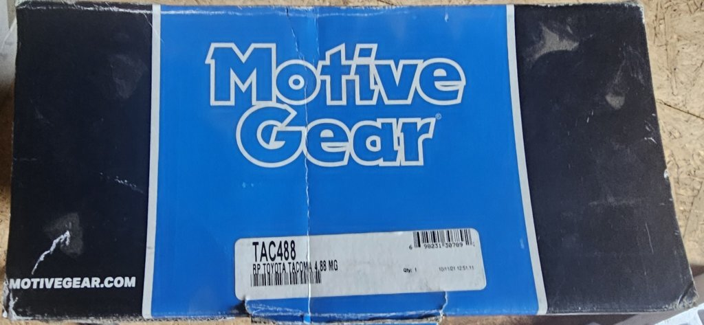

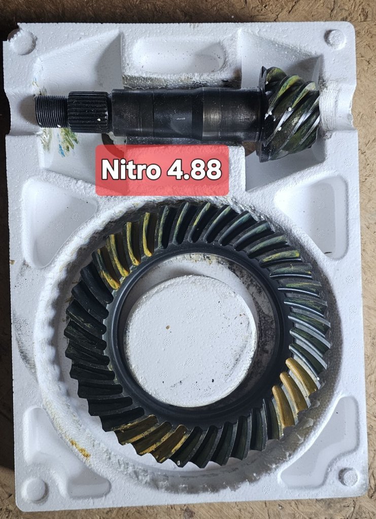

    Jaws Gear & Axle tells me that my Motive gears are made in Korea. The box has no indication of where it's made pictured below. Also pictured below are my old Nitro gears that I've just held onto.
    So in conclusion it does seem like there are certain manufacturers that have better quality gears with that said I still believe that having proper installation when setting up the gears is very important. I'm not sure what caused my issue. Was it simply that I abused them harder than they could handle? Perhaps. Was it the Nitro brand itself? I have no evidence of this and don't really think so. Could it have been the install of setting up the gear originally? Perhaps.
