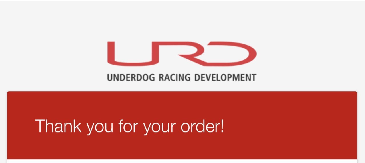

    Well I've done screwed up I guess because I did this this morning :D
    I will be regearing, just want to run the blower first to get a better feel for where I need to be for the gear swap. I still think 4.56 is going to be lower than I want to be.
