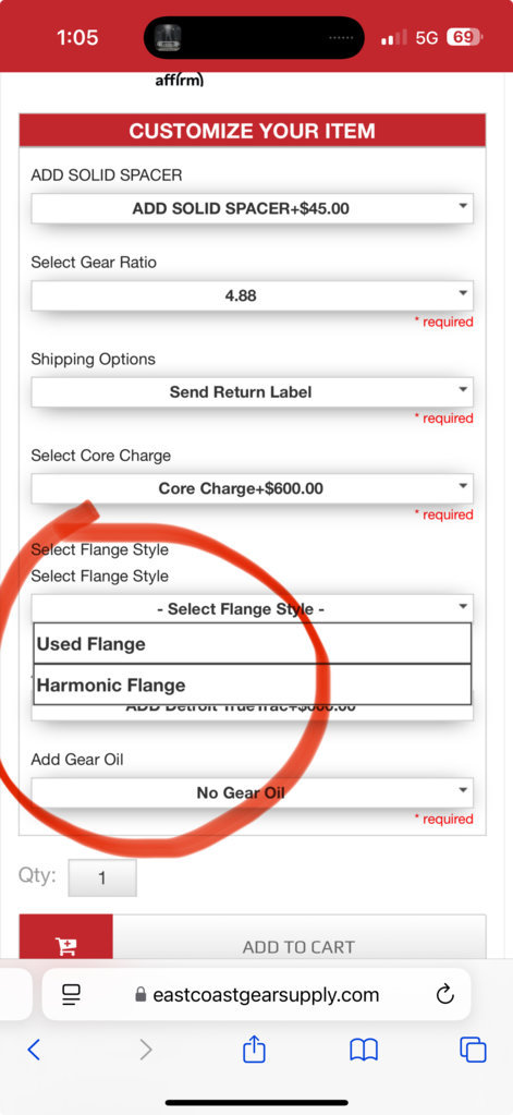

    I’m a little stump on the flange option for my truck.

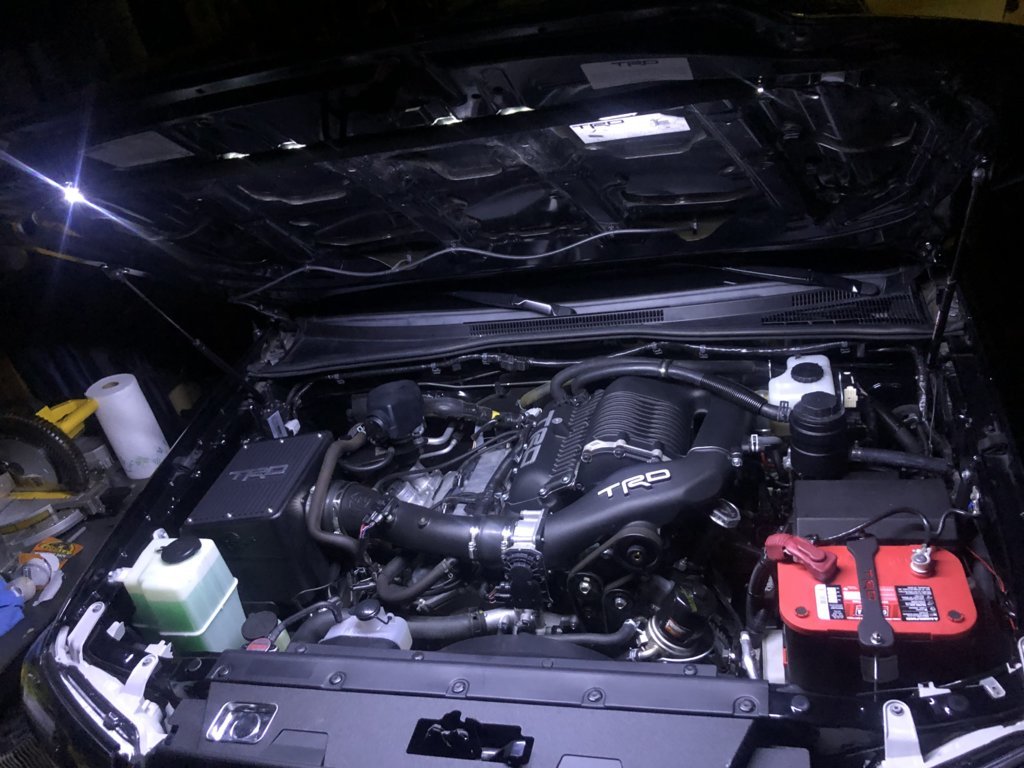

  8. Nov 13, 2024 at 2:34 PM
    #68
    YF_Ryan
    YF_Ryan Well-Known Member
    Feb 23, 2017
    #211450
    5,786
    Kent, WA
    2011 Silver Tacoma TRD Offroad, 2022 Honda CB500X
    Icon Coil Overs. Deaver U402 Stage 3 Leafs w/ Bilstein 5160s. ARB Deluxe Bull Bar. Fuel Boost wheels w/ Wrangler Duratracs. Brute Force Fab Sliders & HC Rear Bumper w/swingout
    how/why is it so clean in there??? lol.:eek:
    TegoTaco likes this.
  9. Nov 13, 2024 at 2:36 PM
    #69
    Georgeth1022
    Georgeth1022 Well-Known Member
    Nov 1, 2014
    #141491
    1,181
    Shaun
    West Hills CA
    2013 BAJA w/ too many mods
    Too many to list
    I keep my truck very clean. I also do a lot of off-roading. It definitely is not a mall crawler. Just care about my stuff, and always detail it after a run, including the engine bay
