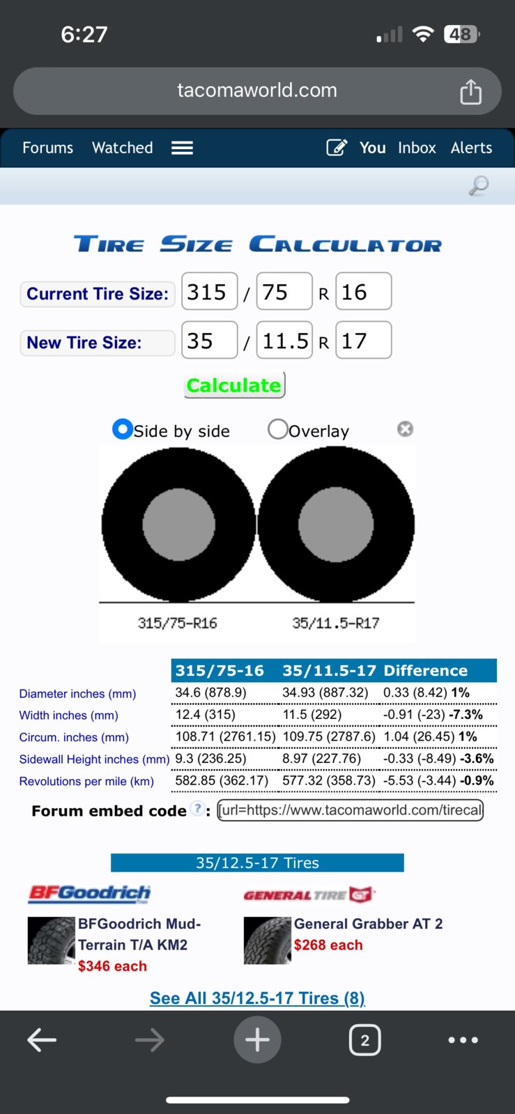

    About to install the paid off mod next month and was going to get new wheels and tires. Currently running 315/75R16, tires are coming to an end and could use new ones sooner rather than later but not like dangerous to keep using for a while. My plan was to switch to 17” wheels for more tire options, and change to a 35x11.5 tire. This would be about an inch skinnier, but close to an inch taller than what I have.
    I was mechanically challenged when I bought this truck but have since learned a lot. So I’m not sure if the previous owner re geared or not. I’ll have to figure that out.
    My question is, since it’s going to cost me $2000+ for wheels and tires, and $1500-3000 for a potential re gear, only one can happen at a time. Which should I do first? Is it okay to run 35s on stock gearing for a while? Or should I re gear and maybe just do tires for now?

    Not re-gearing would not be a potential safety issue. I would do tires if you need tires. Then that may help with you deciding what gear ratios to go with. On my 2nd gen I am running 285/75/17's and went with 4.56. Most people will try to convince you to go 4.88 or 5.29(mostly the 3rd gen guys) With the 4.56 and the 285/75/17's I am about 200rpm higher at 70mph than I was in stock form. I use this web site when comparing all gear and tire size impact calculations. www.grimmjeeper.com/gears.html

    .3” difference in diameter shouldn’t require a regear.
    315/75/16 is basically a 35”
