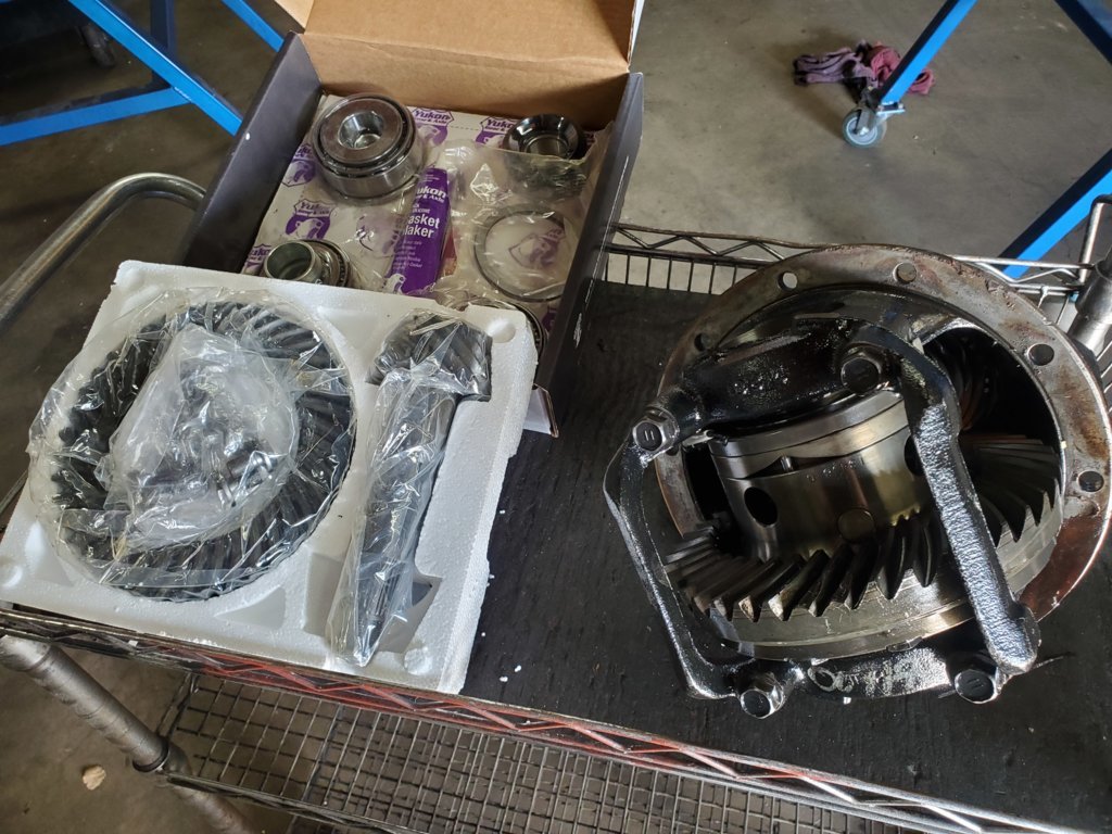

    Dropped off the 4.56 kit to No Coast today.
    You can see the teeth I busted in the current 4.56.

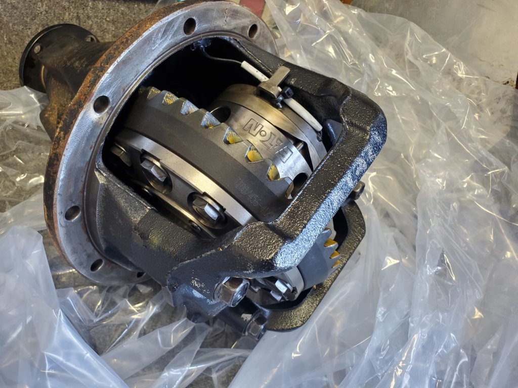

    Picked up the diff from No Coast today. It was actually ready on Friday but I was stuck at work. Next is install and break in. Wanted this ready for fall/winter wheeling season.
