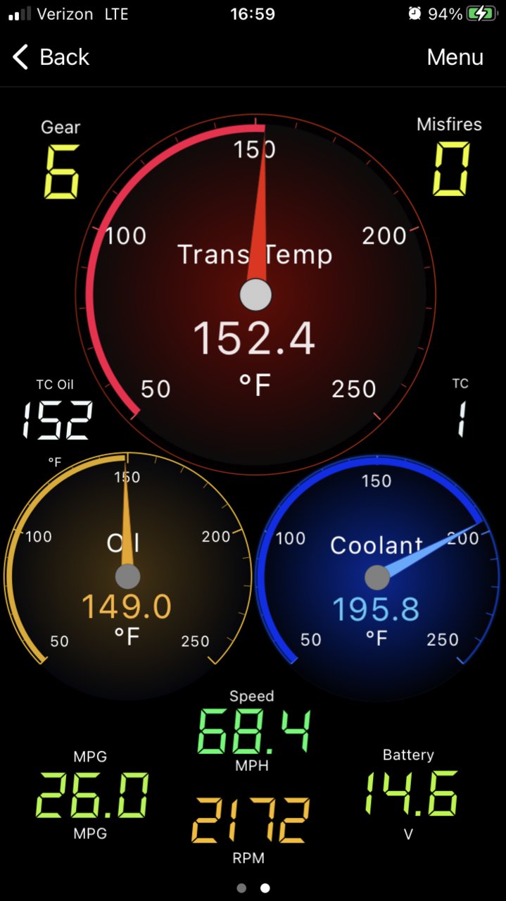

    skeletron

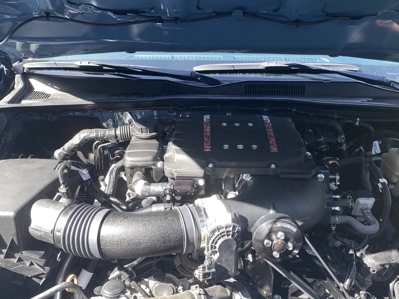

    I would figure out what Rpm and speed you want to be at and decide from there. I went an unconventional route since my truck has a blower and I didn't need the additional mechanical advantage that the 5.29's provide. I opted for 4.56's, I haven't towed with them yet but for my normal driving it has been great. With 285/75r16's at 32psi I am right at 2k rpms in 6th at 70 which is the normal highway cruising speed. Truck has plenty of power there and no wonky back and forth shifting from 5-6-5-4-5-6 like it did before the blower.

  12. Jan 24, 2022 at 3:01 PM
    #32
    a2lowvw
    a2lowvw Well-Known Member
    Jan 12, 2021
    #352533
    1,965
    Justin
    Bothell, Wa
    2019 DCSB Limited
    Stuff and things
    Wixo[QUOTED] and PapaRee like this.

    You can’t change shifting with gears like you can with the tune and the tune also now incorporates gearing and tire size…so…why wouldn’t you know how your truck performs with the tune saving $$$ with your stock gear setup, then if it truly isn’t up to standards, drop the cash for gears…? Now saying that, gears helps a lot with towing. I tow 4K lbs regularly and it makes a big difference cruising down the freeway. (Bigger tires than 32’s would not be fun though with 4.88’s)
    the tunes these days are quite impressive and do change many characteristics of the driving experience.
    Gears and tune is the ultimate combo, but not everyone can afford gears, and getting the lousy stock transmission shifting fix and a noticeable more amount of power made me happier without the gears for a while. That was back then…Now you can get tunes that are highly refined with all the custom options for your trucks specs and it is more worthwhile than you think for a lot less $$$ than gears. Not saying gears aren’t awesome, because I do like my gears, but tuning changes the experience for the daily. Paired together it’s mint
    seems practical to me…
    this is tuned (Nexus tune) with 32’s (255/75/17) & 4.88’s cruising
