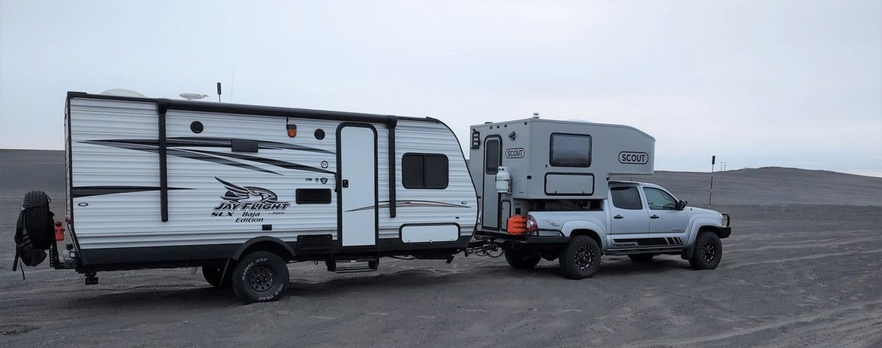

    I re-geared from 3.73 to 4.56 in my 2nd Gen Automatic for hauling and towing. 5th gear (our highest gear) was pretty much unusable unless driving down hill. I also went from a 31 to a 32, as I needed e-load tires for my heavy weight setup.
    I can now use all 5 gears, even hauling heavy. HOWEVER, when empty, my mileage sucks. Fully loaded I can get 9-10-ish MPG, which I'm content with. But unloaded, the best I can get is around 13.5 MPG, driving conservatively (60-65mph).
    I would not suggest going too deep when re-gearing. I think stock 3rd gen is 3.90 gears, so maybe going to 4.88 like you mentioned would be a solid choice.
