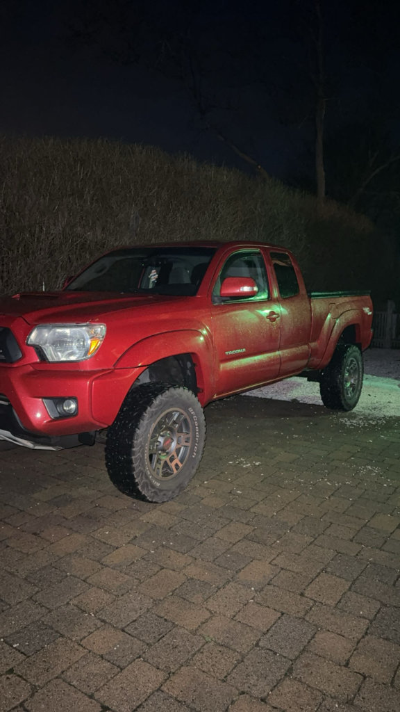

    Hey all, I am wondering if I can fit 33s/ if I’ll need to regear if I get them. I’m currently running BFG all terrain ko2s (275/65/17) which are 31.07 with full tread and I have 3 inch rear blocks and a 3 inch spacer lift up front. I want to know if you guys think I can fit 33s without having to trim my fenders and without rubbing at all and if I’ll need to regear. I love the look of the 33s but don’t want to regear. Thanks IMG_1355.jpg

    Won’t technically have to regear, but you will definitely notice a difference in the bigger setup. And decrease in fuel economy. And more than likely you’re going to rub both on the front fenders and the body mount, especially at full lock/articulation. And then with stock wheels you might run into rubbing on the upper control arms too.

    You won’t have to re-gear, but will likely need a body mount chop, may need to address pinch weld, will have to trim a bit, may need some wheel offset. Upgraded UCA’s would help.

    Before you go down this path, make sure you understand what causes rubbing. Contrary to common beliefs, lifting isn't the solution to clearance and instead it just moves where the rubbing happens in the travel of the suspension. After tire size, alignment and wheel offset are what you need to be paying attention to.

    find out the stock gearing of your truck if its in the 4's like 4.10 you will still notice it but it won't be terrible to 4.3-4.5 is better. This size tire is a good middle ground (i think you have 17" wheels)

    Need to re-gear...depends on your priorities.
    Gas mileage and off road performance were my improvement goals when I went with 285/70/17's and a 3" lift/body mount chop for tire clearance up front/and a re-gear from stock to 5.29 Nitros...we were also towing a 4,400 lb. travel trailer at the time. For those metrics, it made sense to re-gear.
    The re-gear also lightened my wallet by about 3 grand, pro install included. Body mount chop was in the 300 range...tires and wheels first round was about 2,500...suspension lift was 3,500 installed...it adds up quickly.
