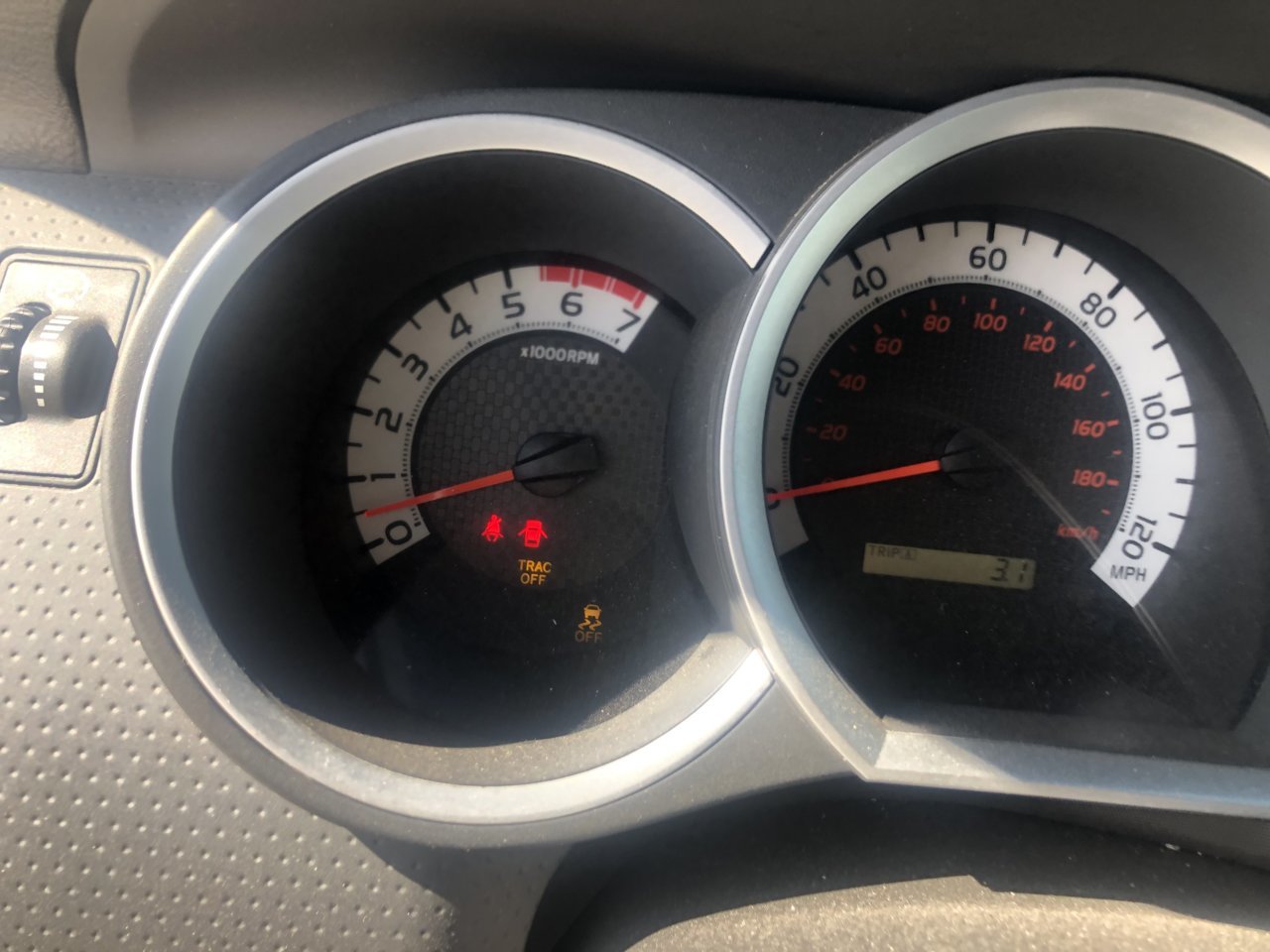

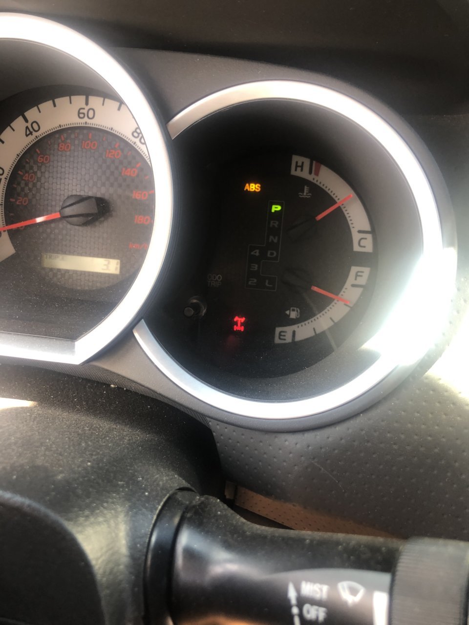

    so I just finished installing a new set of 3rd member and clam shell into my truck: 2012 Tacoma 4x4. Besides everything being over torqued to all hell, things went into place until the final check.
    Started the engine and noticed a bunch of lights that weren’t on before. I took the baby for a short drive engaging 4 lows and highs and even reset the battery. I rechecked all the elocker cables and they’re all snug and clipped in. Anyone have any clue what I broke? I don’t have a code reader with me at the time but I will later tonight.

    My guess would be either the e-locker cable (one single wire) or something to do with ABS sensor. Did the truck actually engage 4x4?

    I dont think it will engage 4x4 if there is an issue with the ABS system, which is why I ask. Im sure others can shed more light

    Immmmmmm dumb. I took the elocker off the member and the locker was engaged. That was an easy fix.
