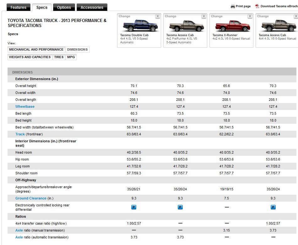

    06 trd V6 manual
    Anybody know if this could be an option??

    That would be awesome for some of the Prerunner guys if that was possible. Actually I wish I could get that in both front and rear! Although that would make reverse suck that much more.
    As for the X-Runner's cruising rpm, you have to figure the diameter of the tires. They're a lot smaller on that truck and the difference isn't that much.
    PreRunner: 245/75-R16, 684 rev/mile, 3.73:1 diff, that's 2551 driveshaft revs per mile.
    PreRunner: 265/70-R16, 680 rev/mile, 3.73:1 diff, that's 2536 driveshaft revs per mile.
    X-Runner: 255/45-R18, 744 rev/mile, 3.15:1 diff, that's 2344 driveshaft revs per mile.
    So 8.1% and 7.6% lower than the PreRunner tire sizes, comparatively. So instead of 2000 rpm at 55 mph, it would be 1840 rpm.
