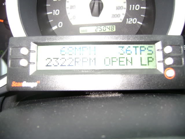

    Here is what I am seeing.
    I also notice that it goes into open loop when coasting. The book says, "Closed loop indicates the oxygen sensor is being used to control the mixture. Open loop indicates that it is not " It also says "It is usually closed exceptwhen the engine is cold or under full throttle acceleration."

    It will go into Open Loop when coasting, as the fuel injectors are cut off, until around 1200 rpm.
