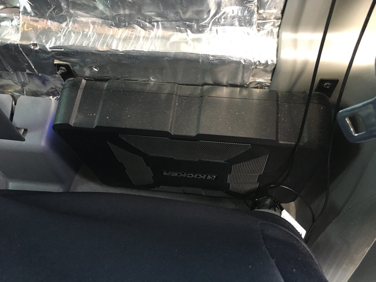

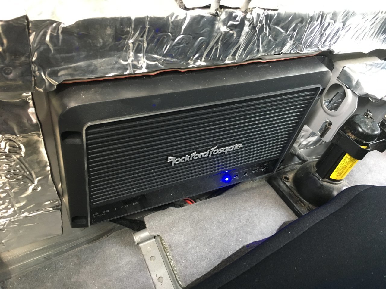

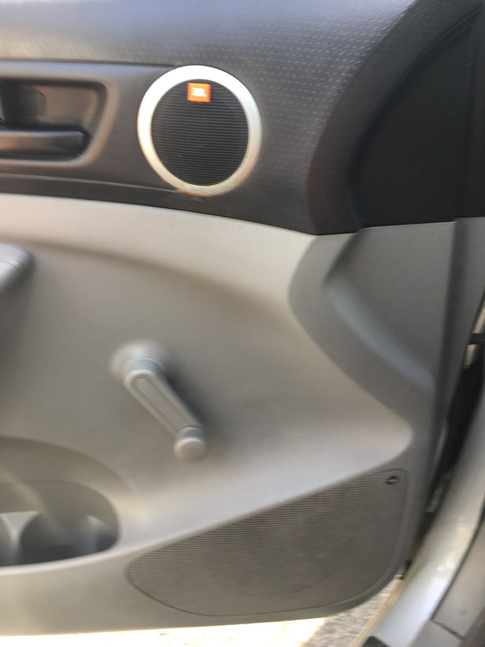

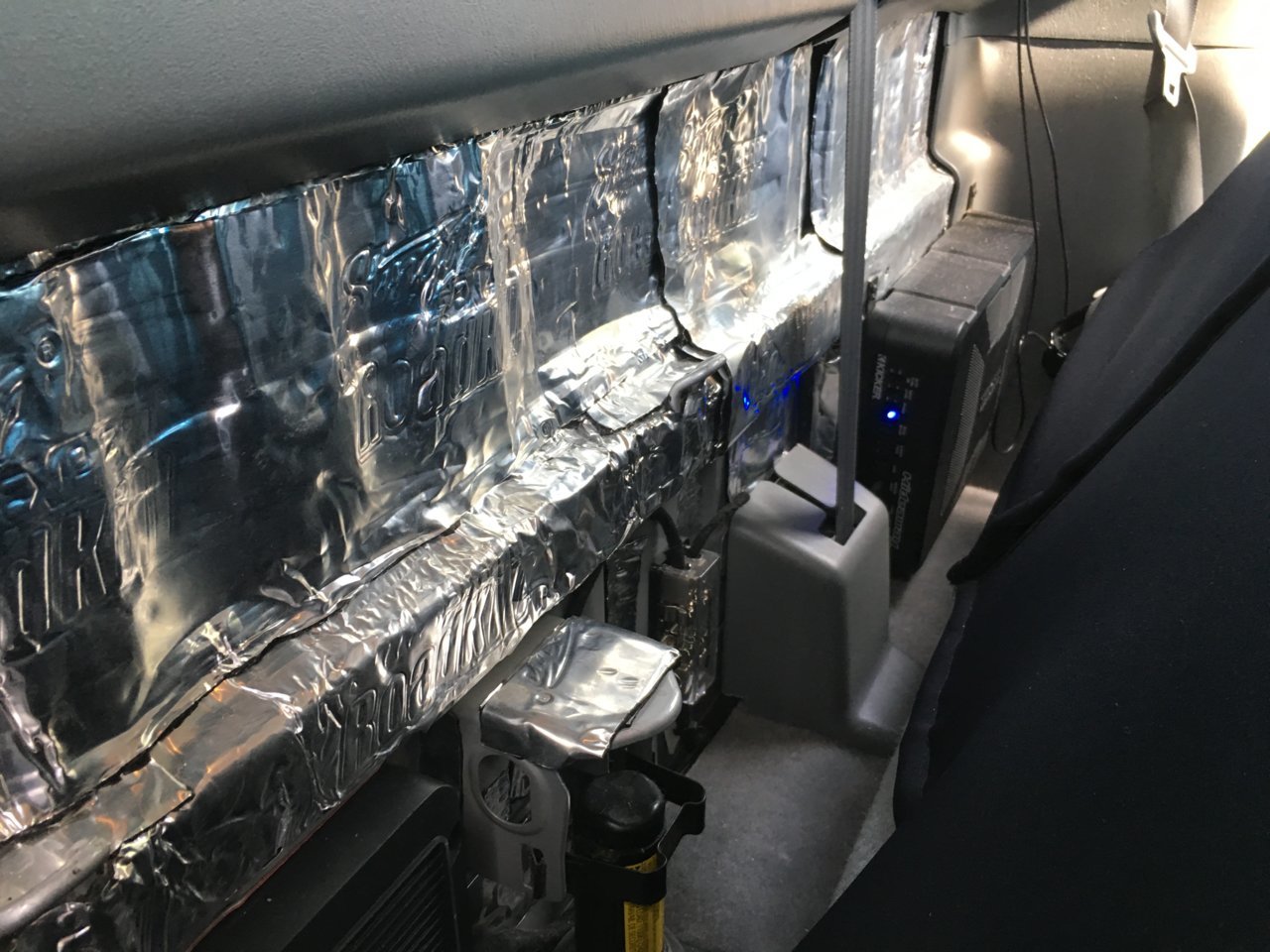

    I’ve got a 2nd Gen, but I’ve got a Rockford Fosgate Prime in my truck, along with a Kicker Hideaway 8” powered subwoofer.
    0A32F1BD-8776-4A3E-BAE0-25237A3F95D3.jpg BE5FF6AE-108A-43AD-98E4-DCD10BD8EDC3.jpg D2128A13-4B7D-47E4-A0BE-67EF8368492D.jpg

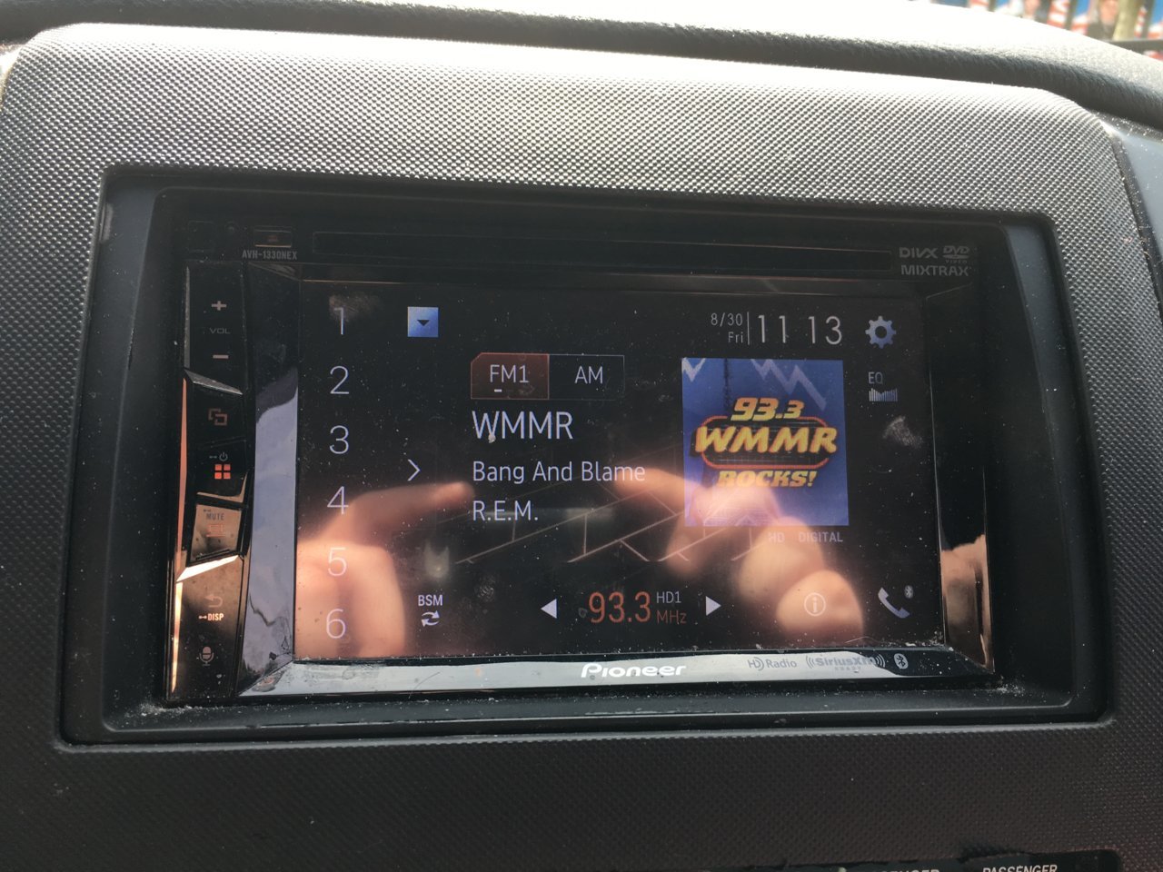

    Head unit a Pioneer with Bluetooth, Apple CarPlay, etc; Also have USB and AUX connections, and a backup camera
    And a JBL component speaker system...

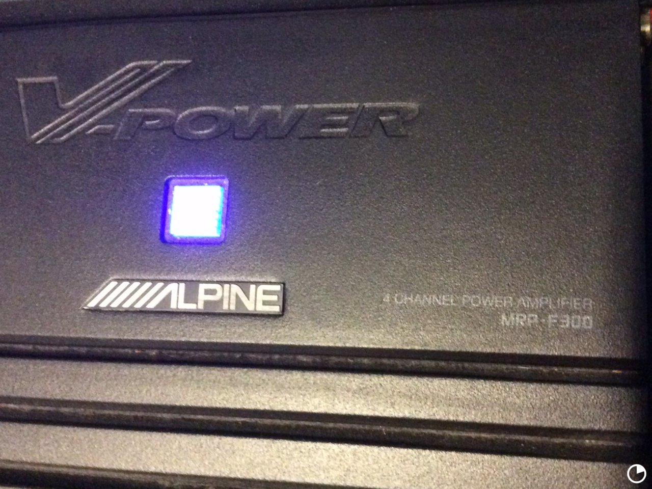

    I've got two Alpine amps under both front seats , a Alpine MRV-F300 under the Pass seat and a Alpine MRV500 under the Driver's seat

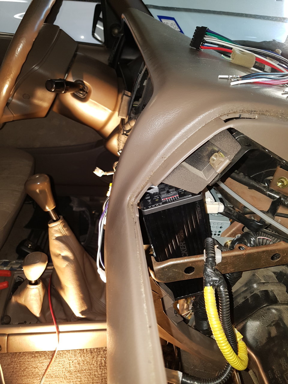

    There's a nice little spot between the glove box and the hvac controls. Got it bolted to steel at the bottom and one zip tie at the top. Feels nice and solid. And I can get at the controls by pulling the surround, which shouldn't be often.
