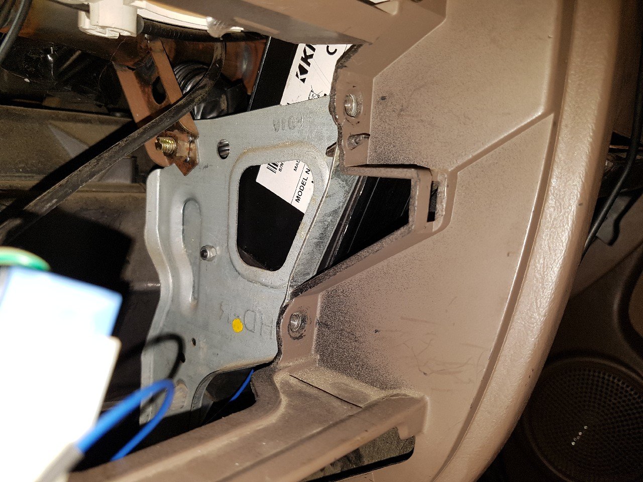

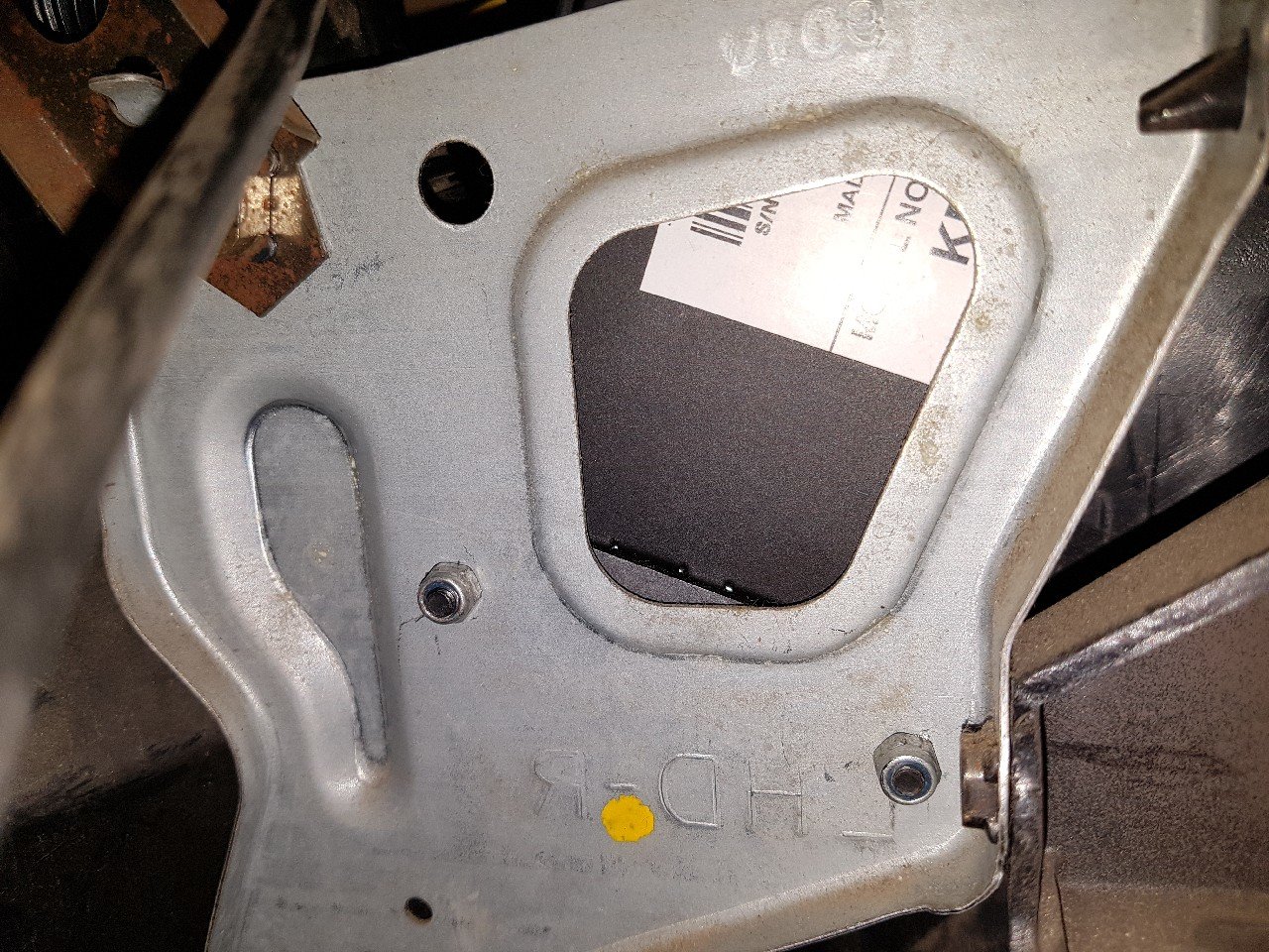

    Just in case someone finds this thread and wants more pictures.

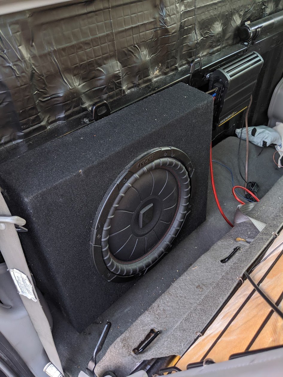

    I wanted to keep my under seat space free for some zippered canvas bags I keep under there, for random cables and tools that I use often.
    I'm using my headunit amp for the front main cab speakers, front channel is running the tweeters in stock location, and the rear channels driving the door speakers. And I lined and sealed the doors.
    More than enough for me, although I could use a smaller, or custom box for my sub, to reclaim some space.
    With a single cab, you can't really store anything back there anyways.

    Can you send a pic of the sub box

    Nate
    04 single cab PreRunner
    Here is what I have now, going to rebuild box and make an amplifier board for the amp and ham radio, eventually.

    Is that a 12”? And is the actual subwoofer a shallow mount?
    I have been struggling with my regular cab passenger seat not being able to tilt back all the way.... super annoying for the wife... do you have a link to your box??

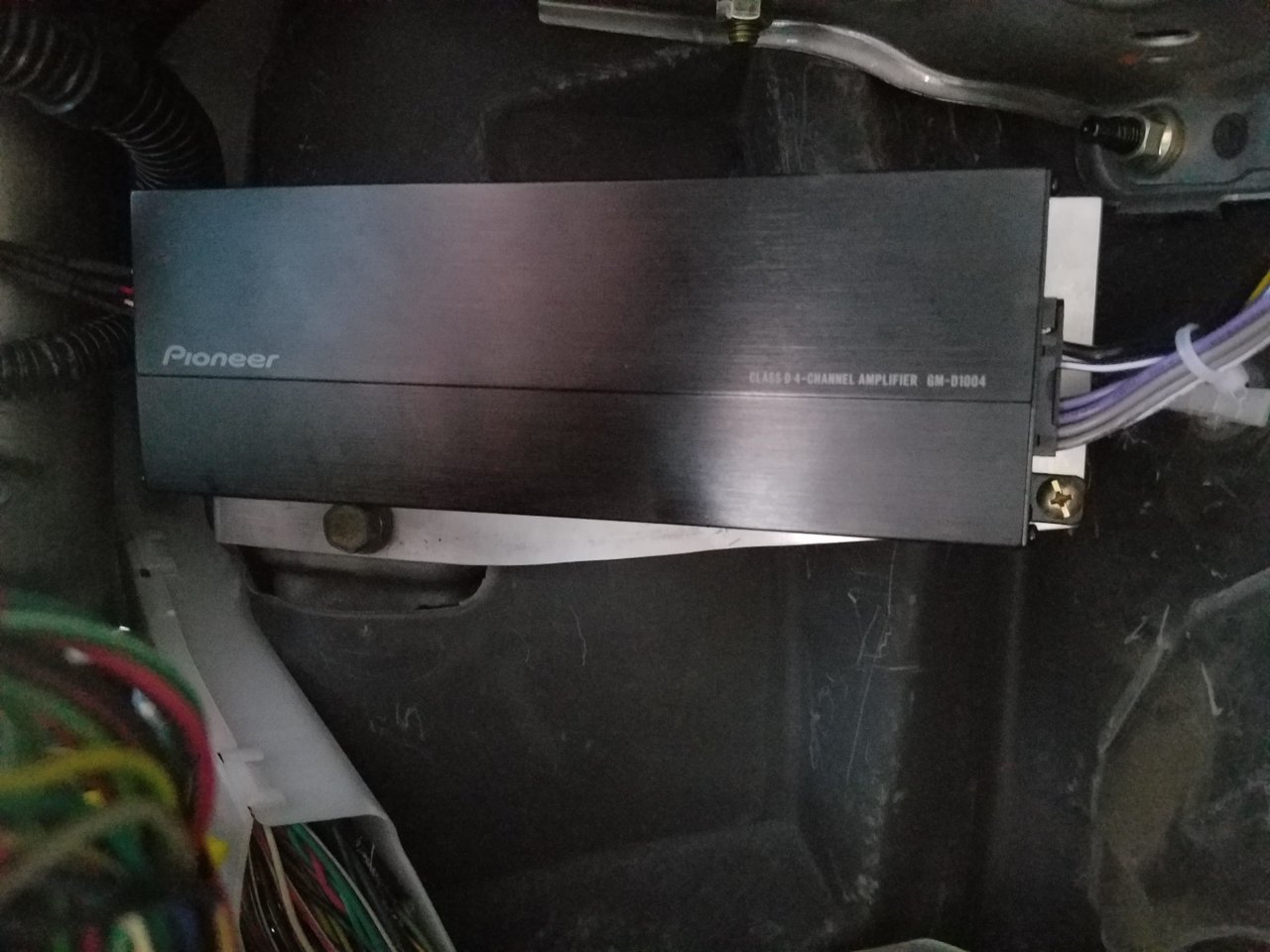

    Although not the best amp for a sub these Pioneer power packs are plenty for the small cab and thin sheet metal of the Tacoma.
    I mounted mine using the clutch pedal mounting point.

    Glad to know you like the pioneer! I’ve used the Alpine, Kicker, and Kenwood versions. Everybody makes one these days and so far none have disappointed

    I have the bench seat, and I'm only 5'9", so don't need the move the seat back far enough to interfere with the sub.
    Its a 12 inch Kicker shallow mount sub, I bought it and the box in downtown Los Angeles, so I don't a link to the box.
    My plan is to rebuild the box to fit under the cross bar on the back of the cab, so it will be a bit shorter, and a bit wider, to allow for the seat to move all the way back, and not interfere when I get buckets.
