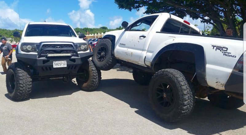

    There's a guy on here from Guam I think with a regular cab that has a Tundra v8 in it
